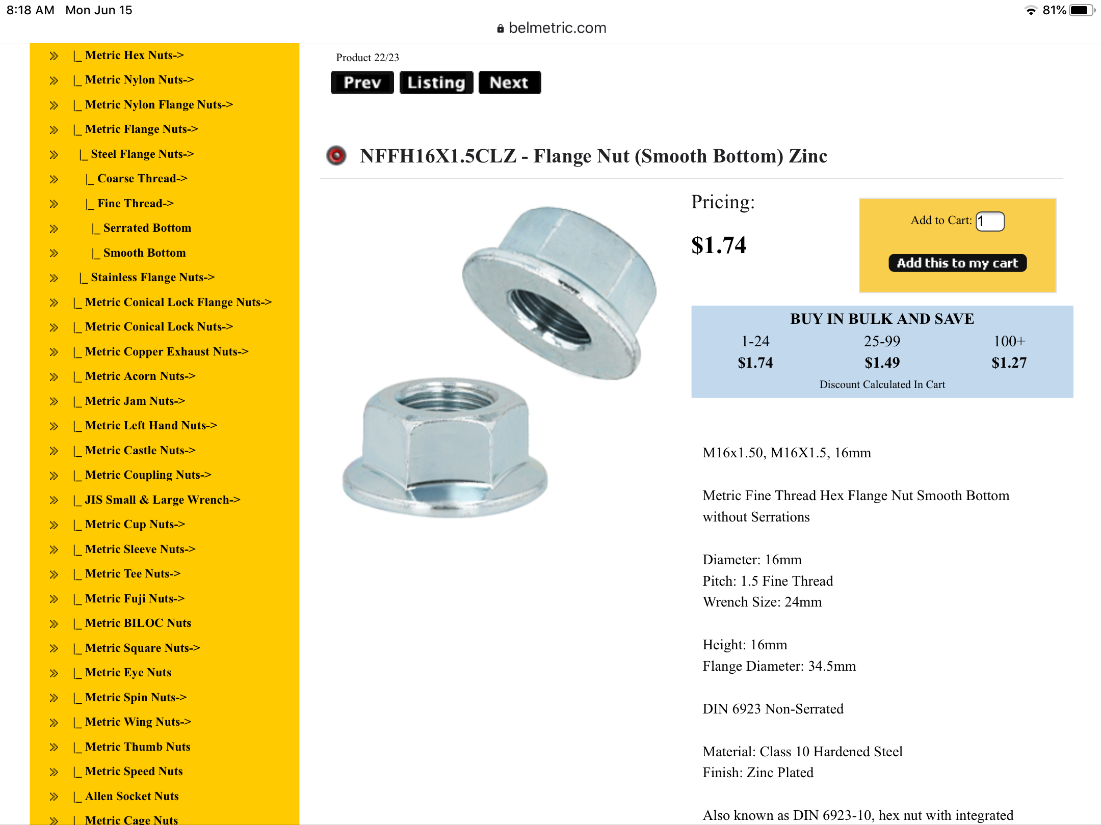

About investing in a M16x1.5 nut and using that to lock the bolt to the crank snout, then using your regular socket on the bolt head? Yes you have to invest in a 27mm open end wrench. I wonder how much torque that would take to back that off? Depends on how much torque you apply to tighten that nut.
The only M16x1.5 nut on the car I know of is the steering wheel lock bolt, but its pretty thin. I’d rather use a full width nut. Maybe a flange nut?

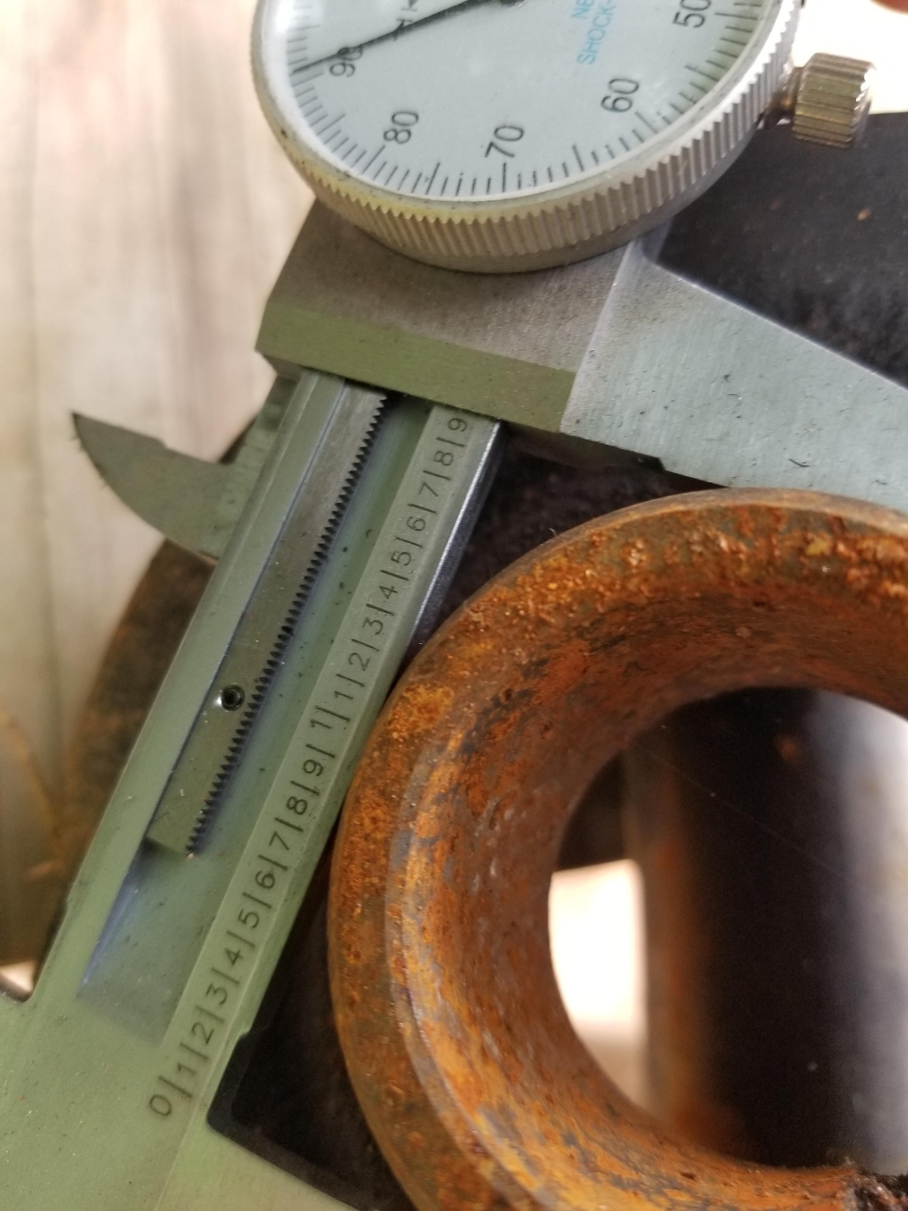

If those calipers are still handy, would you mind measuring the damper hub OD?
Looks like 1.891"

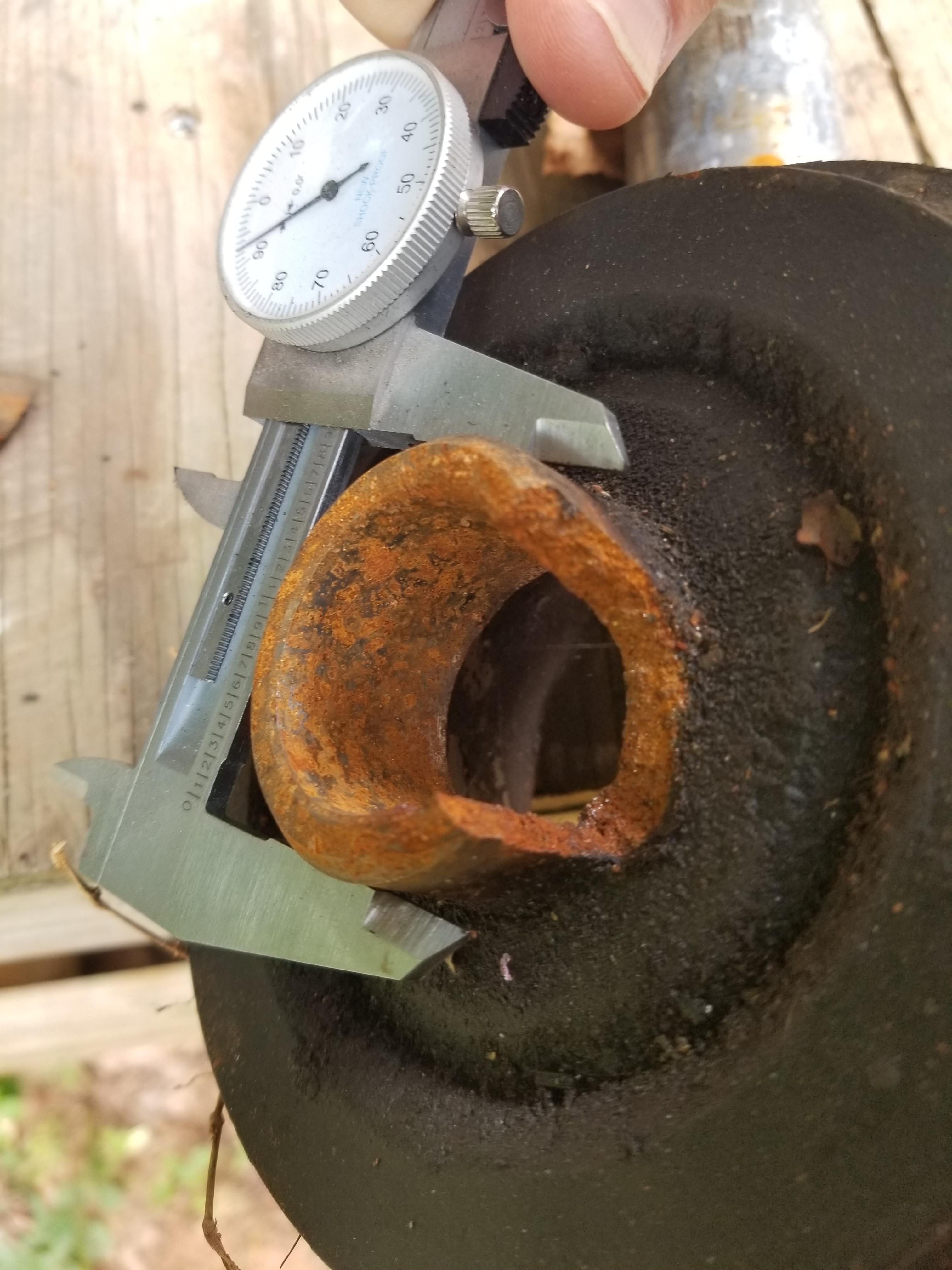

This is the result of the damper and about 5' of pipe welded to it.
You can see the pipe under my hand.
Although the damper could have already been damaged from the PO

I think Patcon has potentially scaled the problem quite well with the pic of the blown hub.  A few (okay, maybe a lot of) assumptions here, but I might guess you maybe had most of your weight on the end of that pipe.  Let's assume you weigh about what I do, 170lb.  You were applying about 850 ft.lbs. of torque to that hub (if it wasn't already cracked as you suggested).  Further, if all six pistons are stuck "equally well" you're having to overcome the binding of six pistons all at once by turning the crank.

Actually it didn't take a trememndous amount of force to pop the damper. Maybe 20-25#s. That is why I suspect the damper was already cracked. That seemed a little too easy. I am hoping to get it free enough to run it short term. We'll see. It's sort of a short term solution to a long term problem. If I start taking it apart to get it free, it expands everywhere and we have to start the engine build right away, with my funds not Cody's. Also it's an L20b so only four cylinders. I have pounded on the pistons some and believe I have the corrosion broken loose. It's just a matter of gaining access to new ground for cleaning up. This engine still has the oil pan on it I believe. I am not too worried about wiping the flats. The weak link is really the engine stand and bolts. I have to put teenagers on all three points to hold it down in order to pull on it. I may chain it down next time but the stand bracket and block bolts will eventually be the weak link if too much muscle is used
