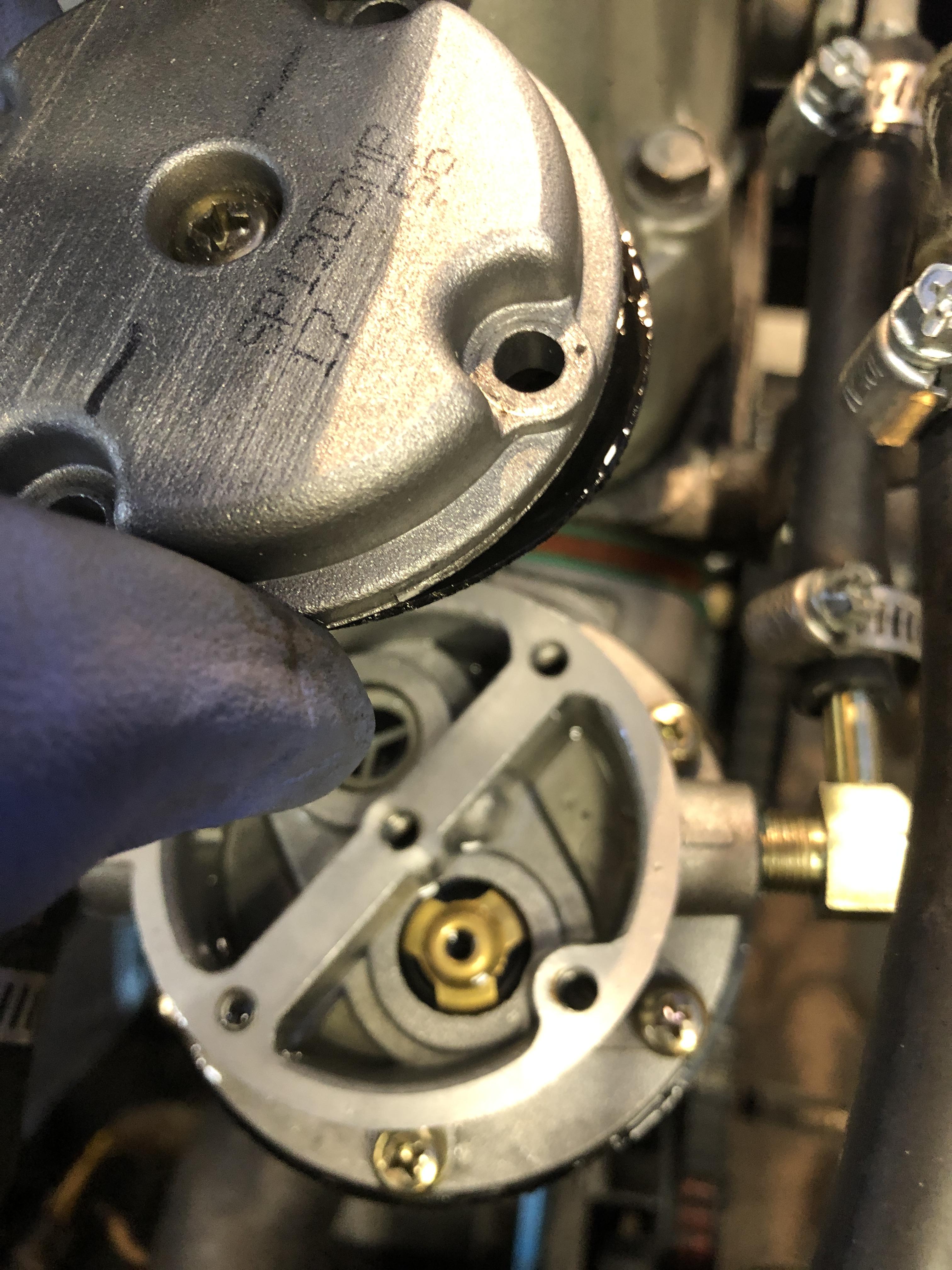

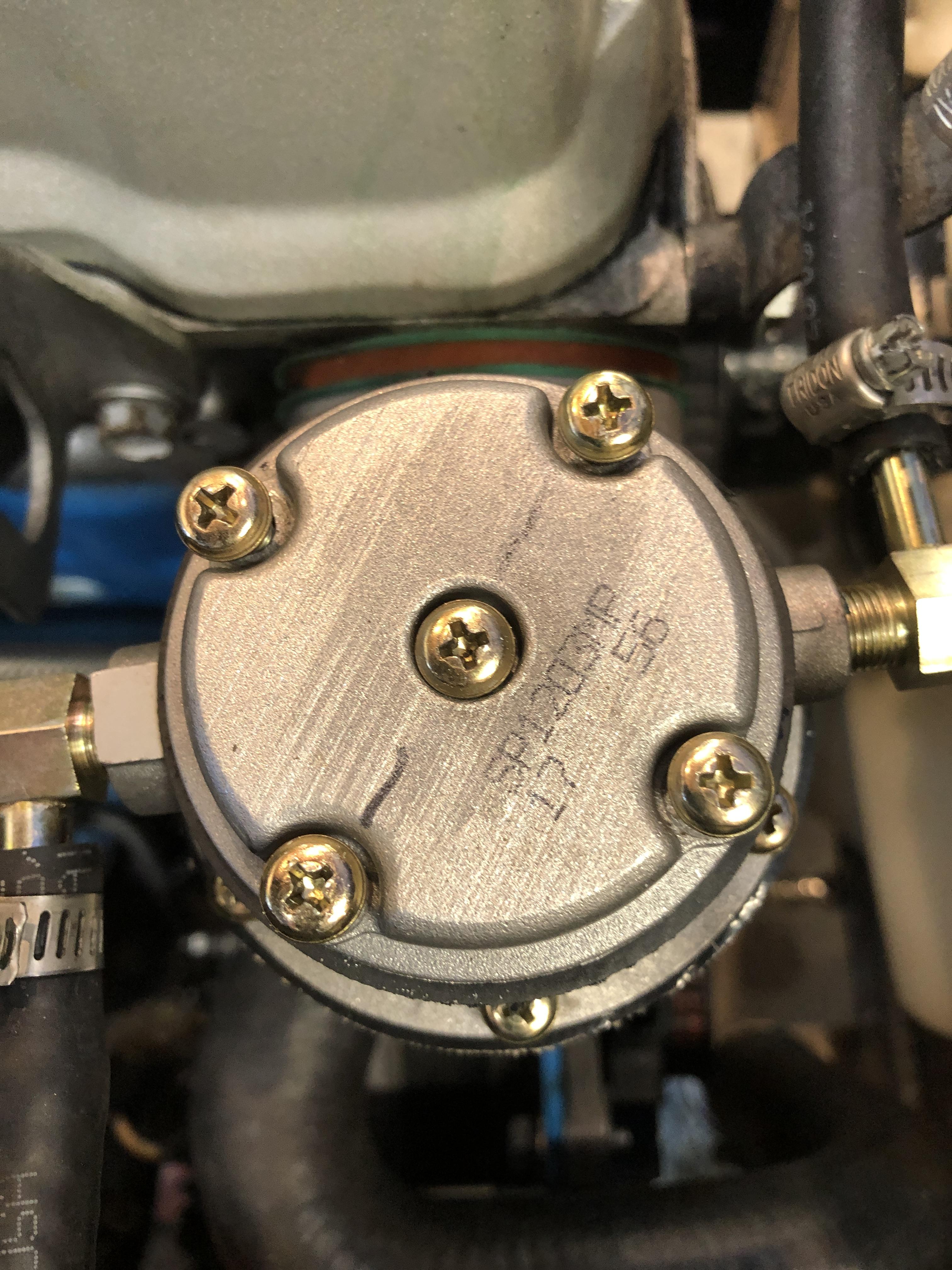

Here are a couple of pics “under the hood” so to speak on the Spectra pump I’m testing.
Here is the internal divider wall between the intake and output check

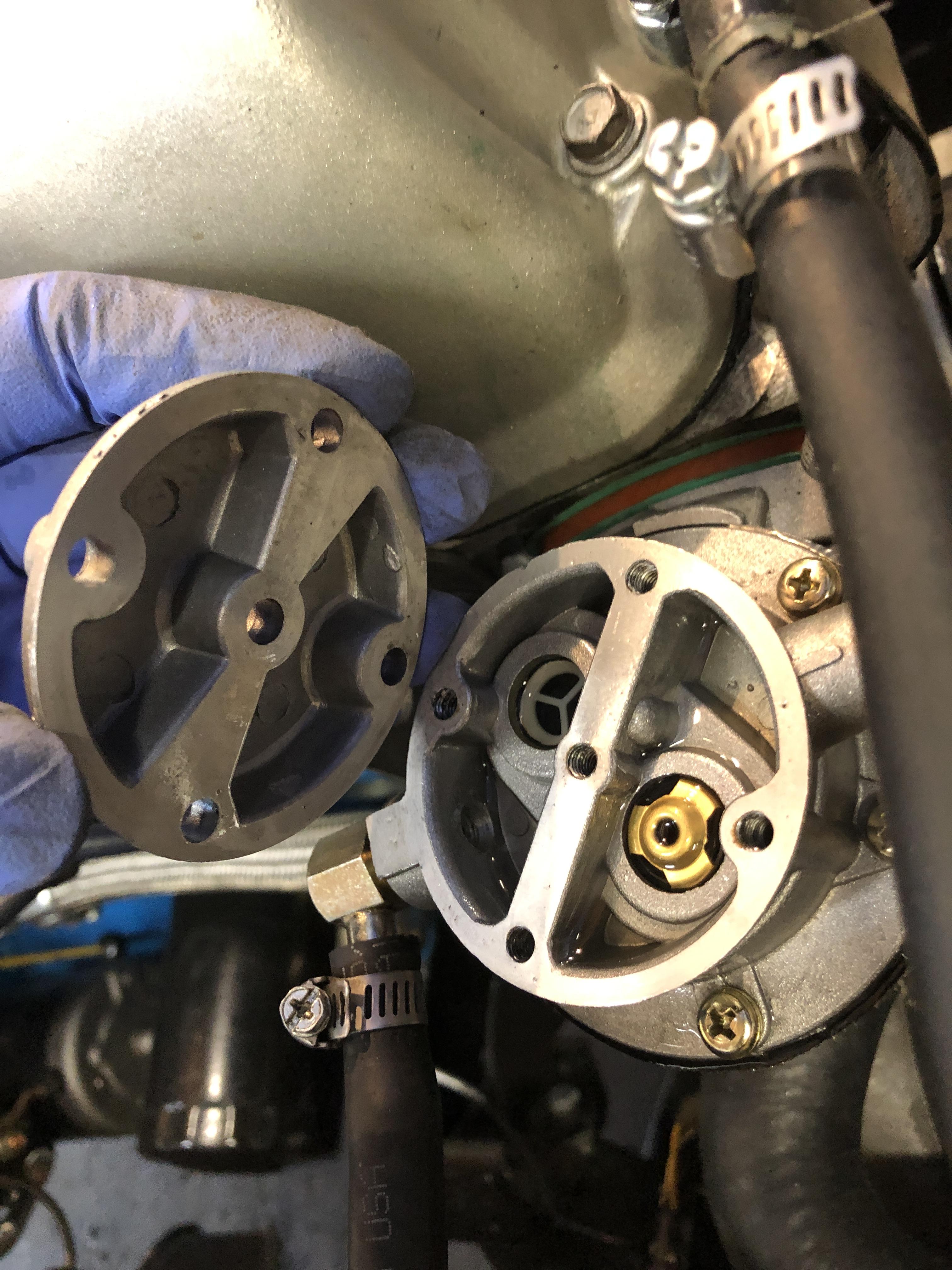

and here is the cap showing its internal divider wall in line with the lower one. When I first opened it the cap was 90 deg out.
I tried putting the cap back on “wrong” this morning to see if I could get it to run for a while then quit, but no such luck. Pump output, as seen by taking a hose off the carb, was 0, nadda, szilch. Switch it back and boom, perfect working pump.

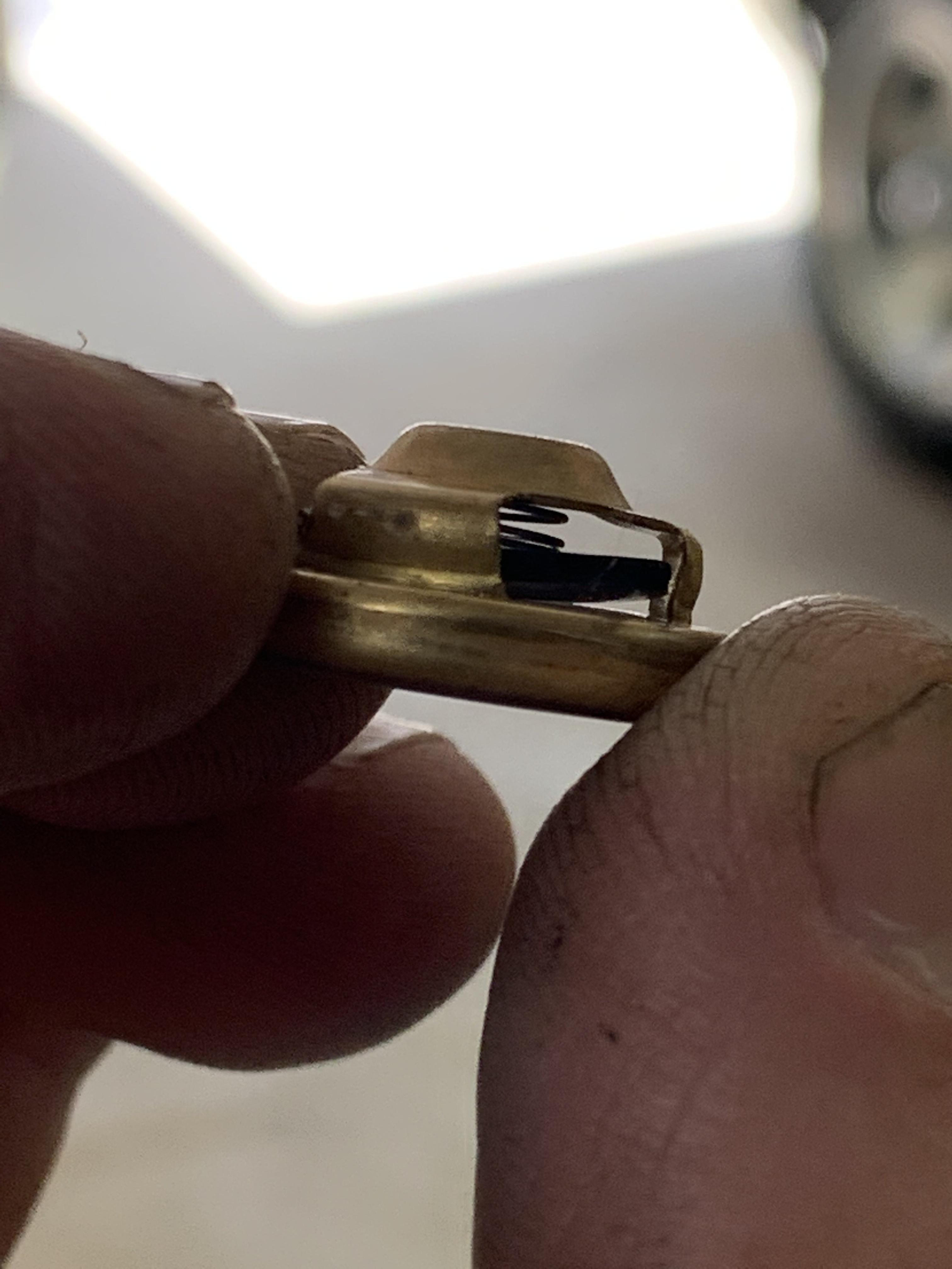

Here lies the culprit in my recent swap. Either the return spring is faulty or the rubber diaphragm in the check valve is faulty. I reinstalled the originals and she ran like a top3CB2FC6E-7613-4D5C-A4BA-F9D20FD8419C.jpeg
That’s something I haven’t seen before. That’s an OEM check valve isn’t it?  If you poke the valve disk, can you get that disk to reseat or is it deformed and stuck like that?
That is the check valve from the GMB that I cannibalized, made it about 20 miles. I tried to reseat the rubber but it kept flipping back up. It gives me concern about the quality of the main rubber Diaphragm.

\Sorry I mistook it for an OEM. I’ve never dug one out of the body. With those stamped in valves, how did you get it stay in after you removed it?
I was using the GMB as a parts donor for my KD pump. I ground out the “nubs” to get the check valves and installed them in the KD pump using the screws and plate. The sizes of both the the valves and squared o-rings were/are a perfect fit. There just seems to be aa issue with the rubber portion of the check valves. I hope they can figure it out because it’s a great way to keep the original housing with new internals.
