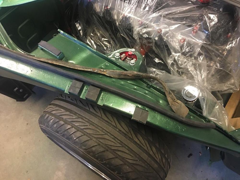

I have my 240Z in for paint and the fenders are off.  I see a fender liner (rubber seal) on Z Car Depot.  Do you all use them when installing your front fenders?  If so, the clips that hold the seal are $6.50 each and you need 12 of them.  Is there an alternative for the clip?
https://zcardepot.com/collections/gaskets-grommets/products/fender-to-body-inner-rubber-seal-240z-260z-280z
https://zcardepot.com/products/fender-liner-clip-oem-240z-260z-280z-70-78?variant=19274988060785
Any help is appreciated.
https://www.classiczcars.com/topic/64114-fender-liner-advice/
