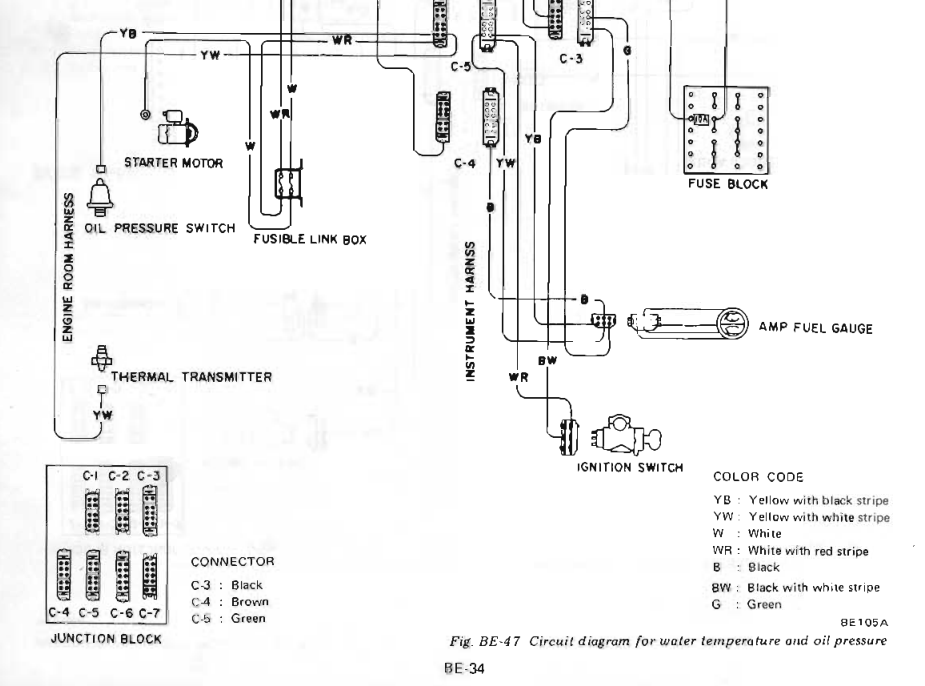

p.s.  just realized that I found an error in the FSM,  Check the bottom of the page and the label on the gauge in the diagram.  The bottom of the page is correct.

  3. Take apart connectors C-3, C-4, and C-5 and spray them liberally with contact cleaner such as Caig Deoxit. They could have seen some corrosion from water infiltration.
