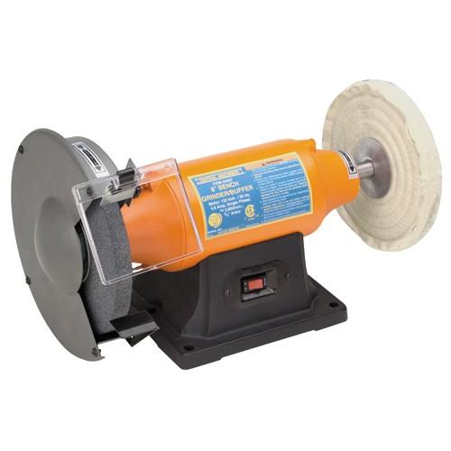

Dr Dave did you use a bench mount buffer with the paste? Thank you.
8 In. Bench Grinder/Buffer 94327 alternate photo #1

Yes, a buffing wheel and aluminum polish paste. It was a pretty dirty job with paste flying everywhere. Definitely wear eye protection and a mask because you'll be covered in that stuff. The final finish is satin, not chrome. I'm considering laying a couple of coats of gloss clear over them for a nicer shine and protection.
