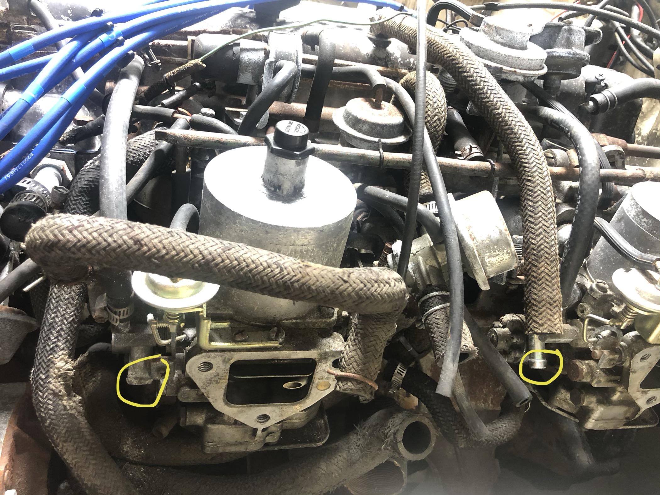

I got a 260z that was sitting in a garage for 25 years, and as a result some of the hoses are very brittle.

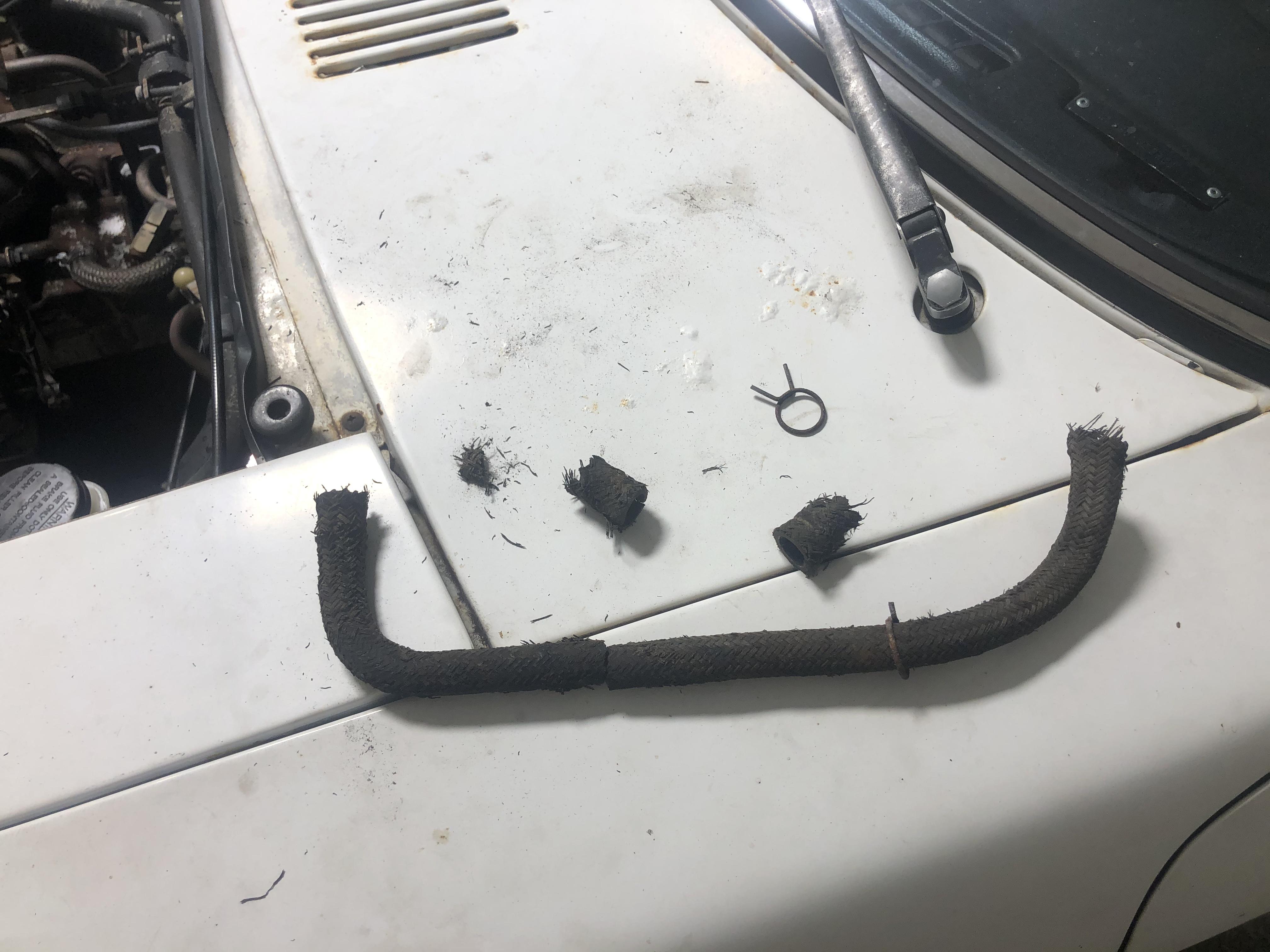

I took the air filter housing off and accidentally broke the hose that goes between the carbs and I can’t seem to find a replacement hose online.
I could probably just go to a store and get one that fits but wanted to see if I can find a stock molded replacement first.
The hose is sort of “U” shaped, and is a larger diameter where it attaches to the carb on the front of the engine.
Any help is appreciated, thank you.
Side note: I’d also like to replace all the other hoses here, so if someone knows of a kit that I can buy that has all of them, that would be good too

Hi Cooper260z,
My factory-stock, 1978, UK 260z has flat tops fitted. In order to track down this hose, you need to determine the part number from the factory fiche. Below is a screenshot from the US L-Drive fiche. I think the hose you are referring to is number "88", which relates to part "16088-N3300". Despite some US/UK carburettor differences, the part number is the same, for this hose. Looking at ebay, there are currently 2No. available from the same seller at: https://www.ebay.com/itm/DATSUN-240Z-260Z-280Z-FAIRLADY-Z-S30-HOSE-CONNECTING-16088-N3300-JDM-SPARES/202722668547?hash=item2f33367003:g:uJMAAOSw4eRdXLqM
(ebay item number: 202722668547)
If originality is important, then it will be worthwhile asking the seller for an image of the actual part, because sometimes these original braided hoses are substituted for smooth-finished hoses, based on the original part number, where superseded.
