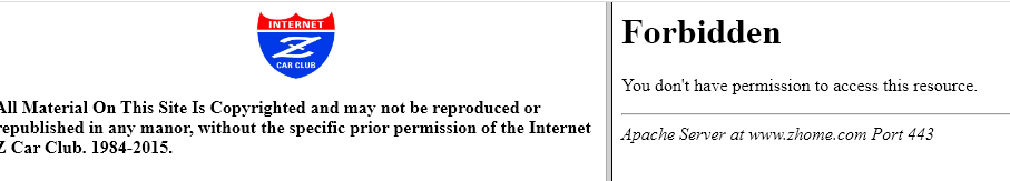

Some of the links on the top of the left side menu will drop the person down the left side menu, but only a few links in the lower portion of that left side menu do anything, like show a Forbidden page (How to Join...) .  The Copyright link brings up a new left side image, but all of the menu options below it disappear.  Basically you're claiming Copyright over something that can't be accessed and not allowing anybody to join the club.

The two links "How to join"  and "Searchable members list" both lead to "403 forbidden"

Interesting.  That does work, but I still got "Forbidden" when I tried to Join.

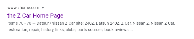

the 'community' thinks of http as outdated and generally https is preferred these days. that's why google returns an https link to zhome.
your browser may also default to https if you don't enter the protocol - my chrome browser still defaults to http if I enter just 'zhome.com'.
I didn't spot your problem with the 'how to join link'. That is down to the apache config on the server - the page http://zhome.com/~aktar/memberdb/entry returns a 403 status code, which is basically saying you don't have permission to visit that page. That could also be a result of modern browsers declining to participate in insecure stuff, or it could be deliberate - maybe you can't join the izcc any more. (I haven't read the whole thread!)
~aktar means the home directory of a user called aktar. Presumably aktar is member of the izcc. There are quite a few links to zhome.com/~aktar around the internet, all return a 403 forbidden response. I Guess aktar was a mover and shaker, given the member database is in his directory, but anyway,  none of us can access any of his stuff any more.
