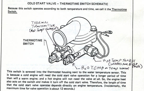

20 hours ago, Bigz Zee said:
Is there Water Temperature Switch on this car? Isn't supposed to be on the side?
Looks like there are three sensors on the front.
Should have a thermotime switch, with an injector-type plug, and a coolant temperature sensor, also with an injector-type plug, and a temperature sender, with a single wire attachment.  Later cars have a fourth switch, for the vacuum advance solenoid.
  • Thanks 1
