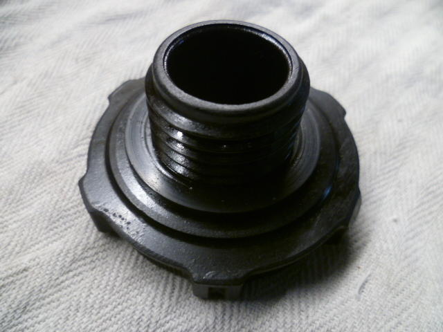

Right. It's easy to mistake it for part of the cap. Here's some pics.
Cap, as it's normally seen:
Close up of the seal in-situ. Looks like all one piece:

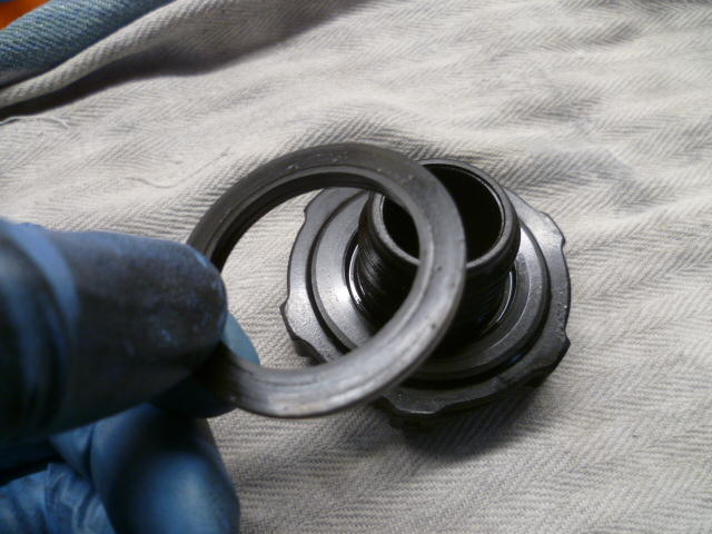

But in fact, it's not. Used a thin blade to get a little separation and get things started, and the seal comes off. Note the step on the seal and the recess on the cap. Speculation on my part, but I bet the earlier seals (with the different part number) didn't have that feature:

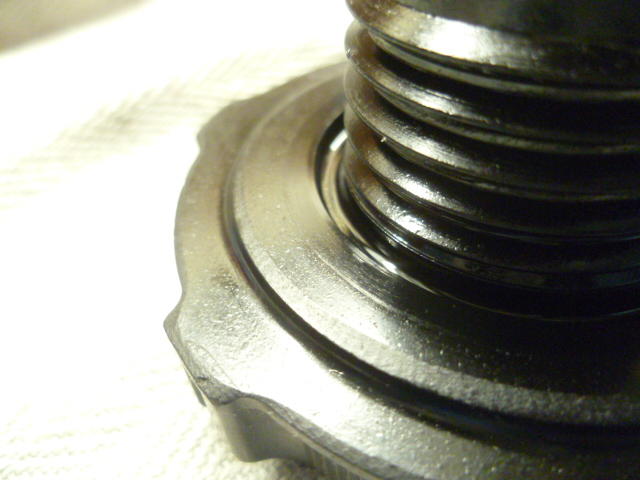

And here's a close-up of the cap with the seal removed. You can see the recessed area for the step.

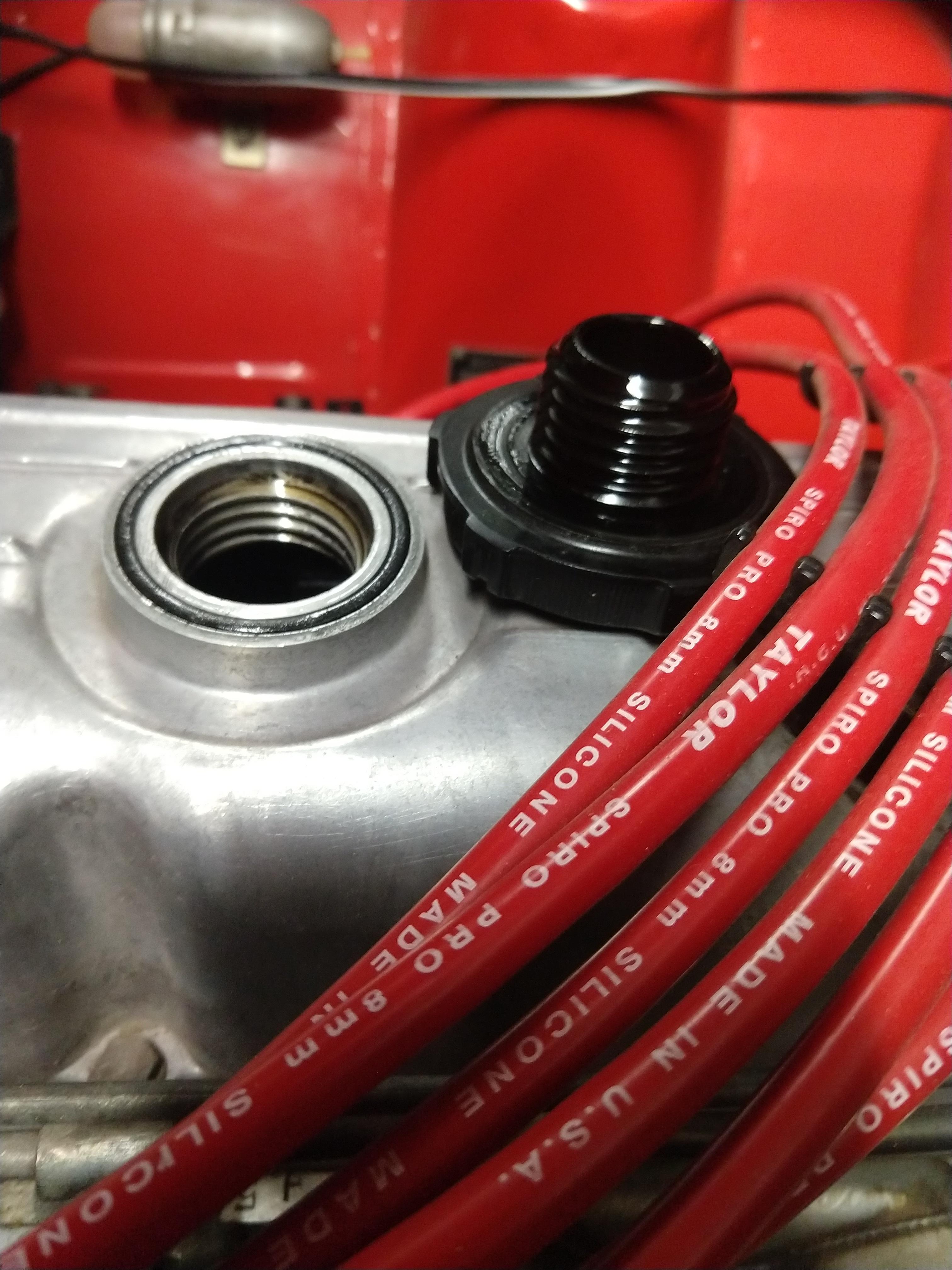

And for the guys with the O-ring style built into the valve cover, I guess that's the older style. according to the documentation, they changed over to the newer style in 71.
