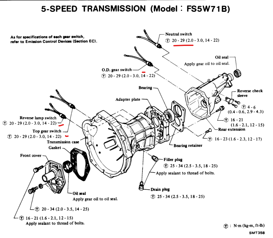

While we're at it, can someone help me identify what these three ports are on the side? I'm guessing A and B are reverse and neutral switches, but I have no idea which is which.  C is just a threaded hole and it's pretty hard to tell if there's something to interface with on the inside of it.

This is the short ear, single exhaust hanger bracket so its the early ZX tranny, not the later tall ear single bracket “close ratio”. 80-81 year range. The forward-most hole, “C”, is the reverse light switch position. Can’t say for sure what the others are easy to test. See what gear positions cause the switches to change from “open” to “close”. Some may be normally open, some normally closed. Just look for a change of state when in Only one of the gear positions.
I’ve never been clear on what models/markets/year ranges etc determine the existence of neutral and/or high gear switches. Most north american ZX trans I’ve seen only have the reverse switches. Early Z trans often have a neutral switch. Zed’s drawing shows all three with two different positions for the OD (top gear) switch. Haven’t seen a definitive listing anywhere.
