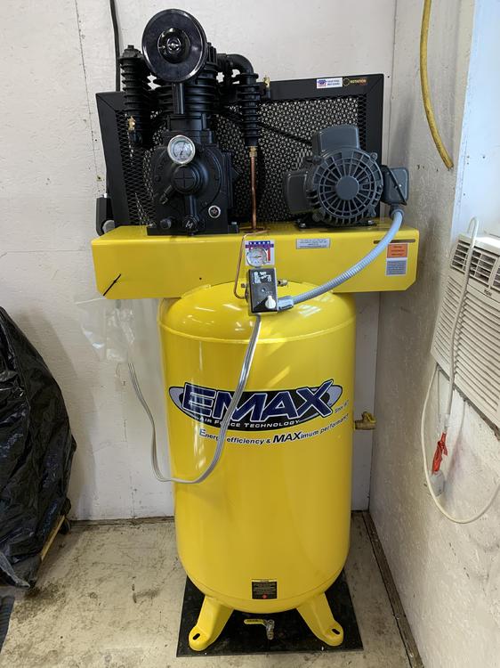

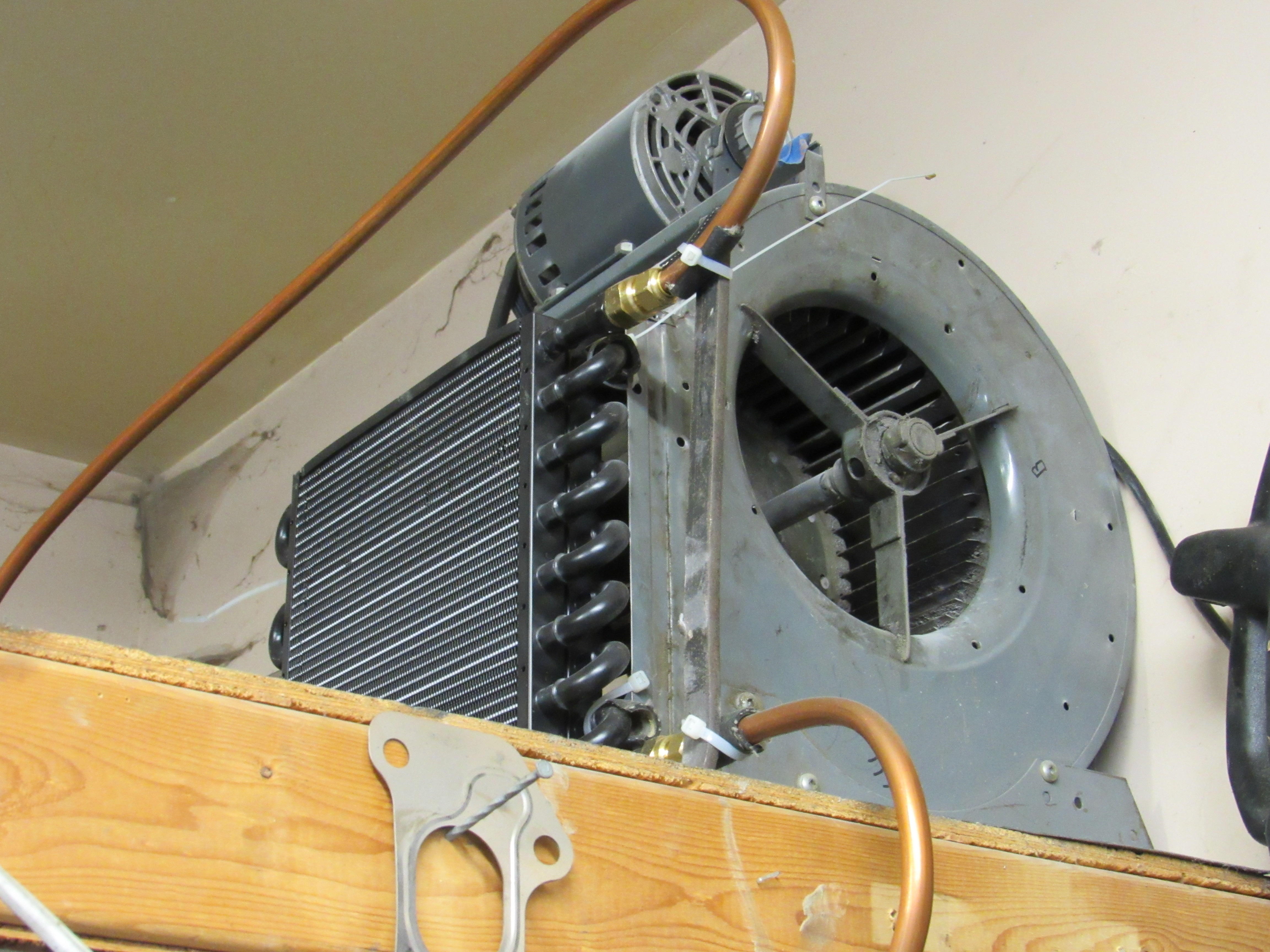

Bill, your situation sounds just like mine 20 yrs ago and over the yrs I incrementally upped my equipment until I now have what you see in the pics.  I wish I had just bought this system 20 yrs ago, the compressor I picked up on craigslist for $500, the A/C condensor is from a mid 90's Honda new for $40. Just remember you can never have too many cfm's and the air must stay as cool and dry as possible, especially for sand blasting.

After years of inadequate compressors I finally put out the bucks . 2k if you want something to run a blaster and not be struggling . 5 year warranty parts and labor !
That’s 80 gallon - 19cfm at 90 psi.

The A/C condenser and furnace blower is a great idea for getting water out of the air.  A long time ago I ran 1" copper pipe all the way around my garage with one drop leg.  Drain valve at the bottom of the leg and the air take-off was 12" higher.  It worked pretty well, but as with all things, it becomes a matter of degree.  Anything is better than nothing, and more is better still.
