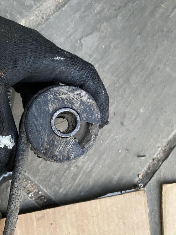

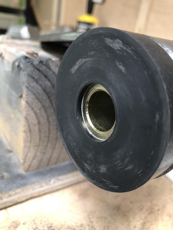

Follow-up to Zed Head's suggestions yesterday. I scored, pounded over and finally removed much of the rolled in part of the remaining bushing sleeve hoping to create that "gap"  and allow the poly bushing to seat. As it turns out the spacer is still shorter than the overall bushing height (3rd photo) so will require considerable compression to get the washers against that spacer. All the big flat washers that came with poly bushings have same hole I.D. Is one able to reuse the stock washers shown above on the poly bushings?

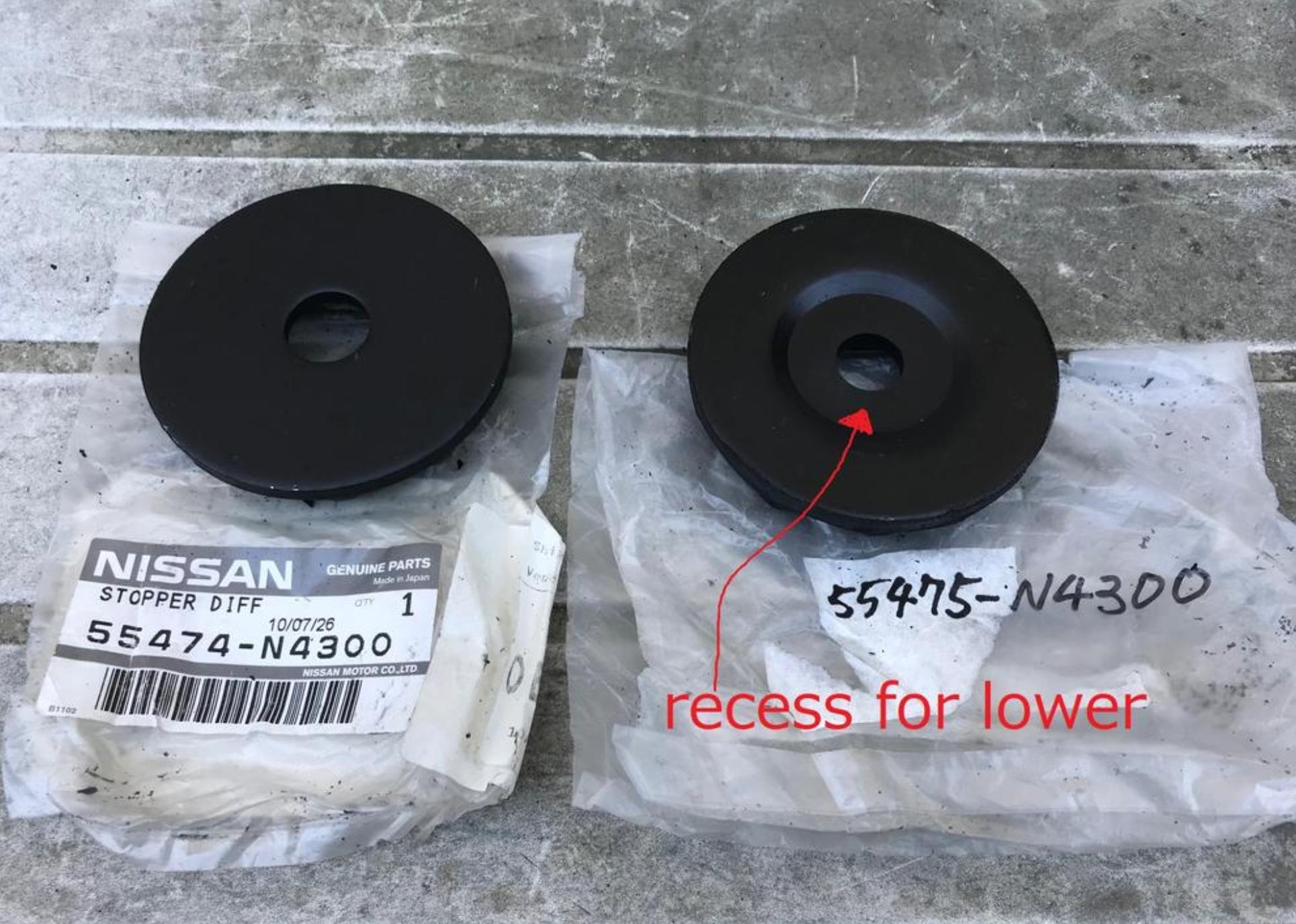

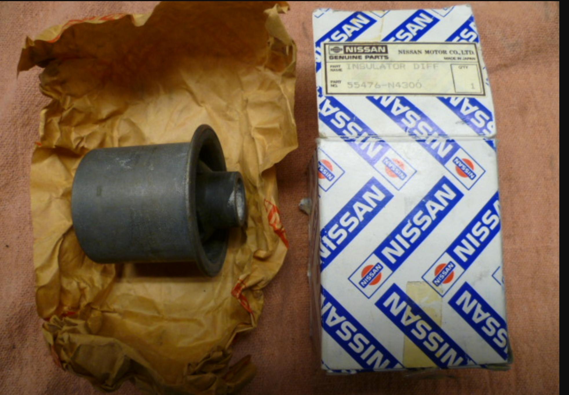

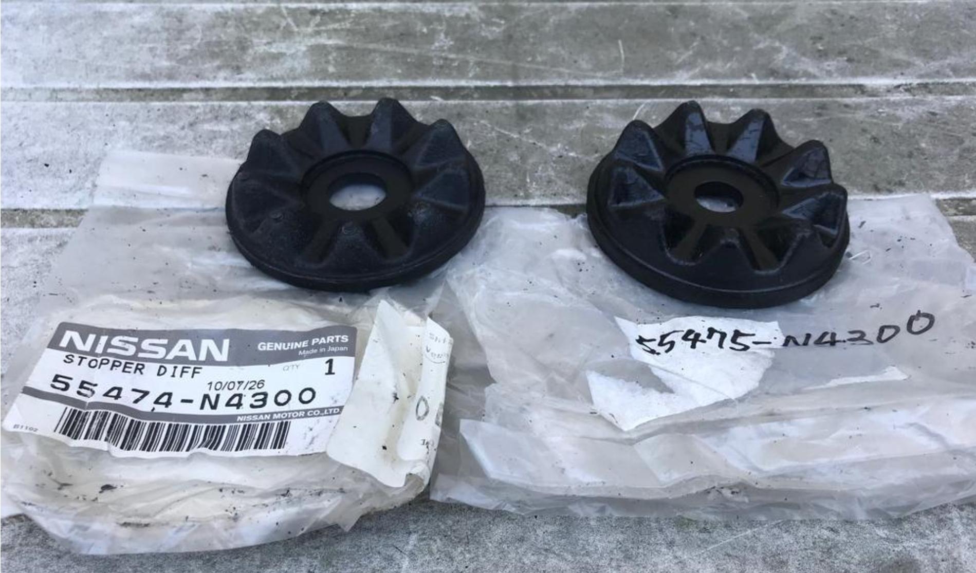

I think they started making for a time, but they stopped about ten years ago. Here is a photo of one and the box with part number.Mustache bar bushing.jpg

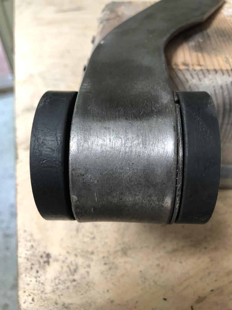

I bought these on eBay a year ago for £60 - they do come up a few times a year.
15bf6cfe4ecee102b376376e49bb7d3c.jpg&key=7f973b5de619f9dd0c33389dab2ef1677abe63720bf9ac6ce17920229a141595

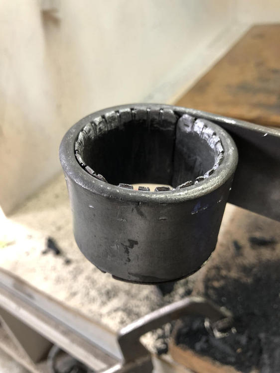

As for serrated washer, I did this with cutting a tension rod bush about 2-3 years ago and it works well!!!

I did a bit of searching and found the thread on the mustache bars where I had downloaded the photos for the 280Z bushes a couple of years back.
The thread was about the bushes and possible alternatives. @kats posted a lot of photos of all the different variations he came accross on page 2.
These is also a tool on page 3 made by a someone back in 2011 to flare the outer ring over the mustache bar
The thread was about the bushes and possible alternatives. [mention=2430]kats[/mention] posted a lot of photos of all the different variations he came accross on page 2.
That is a superb thread and helped solve the mystery of how to get the bush out!
