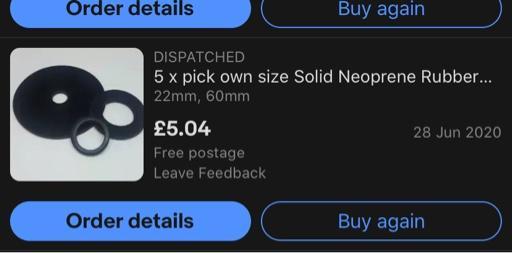

 Well funny you should say that chap! The other eve I was having similar thoughts and ordered some of these for that exact reason! [emoji106][emoji106]

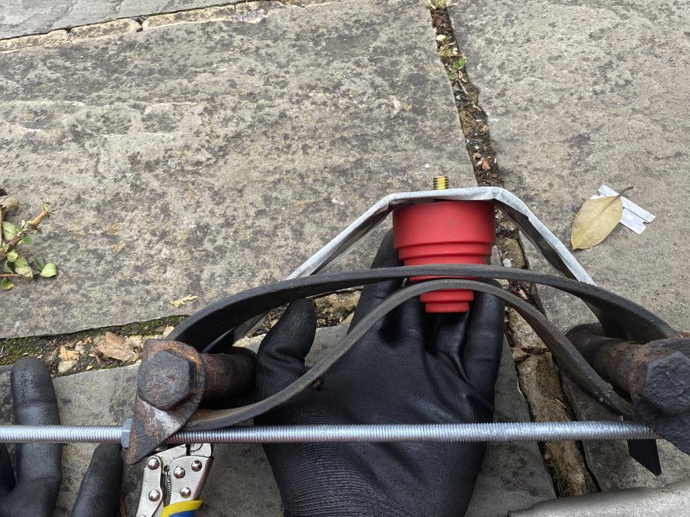

Interestingly, I am making my own RT mount equivalent as my rubber insulator had totally failed - now that insulator is a true example of bad design working in the opposite direction. But I guess 43 years is 43 years wherever the rubber is.
75c41c6a64e483b9ab480bf20ac4cddd.jpg&key=f5f5f4431ab696c471f297f70b822f163a4f61d76dca98039f5a43cc6a051530
e6c86224bb008fd7edfed0f40ee313d6.jpg&key=94510eae4a3223ed7f7b002feeaeb29bbd569e5d8e53ef641b833ea58580759b
The point being that I bought the bushing used in the TTT mount and I find it to be rock solid. So I’ve bought more of those rubber washers above with a smaller ID to space it out with - that way I get a little bit of give for reducing high frequency noise but the solid resistance to lift of the red poly bush.
Here she is, mocked up out of aluminium and masking tape ;) final version will be 3mm steel. This is definitely stronger than the giant rubber band ;)

I call this the AK mount !![emoji1787]
