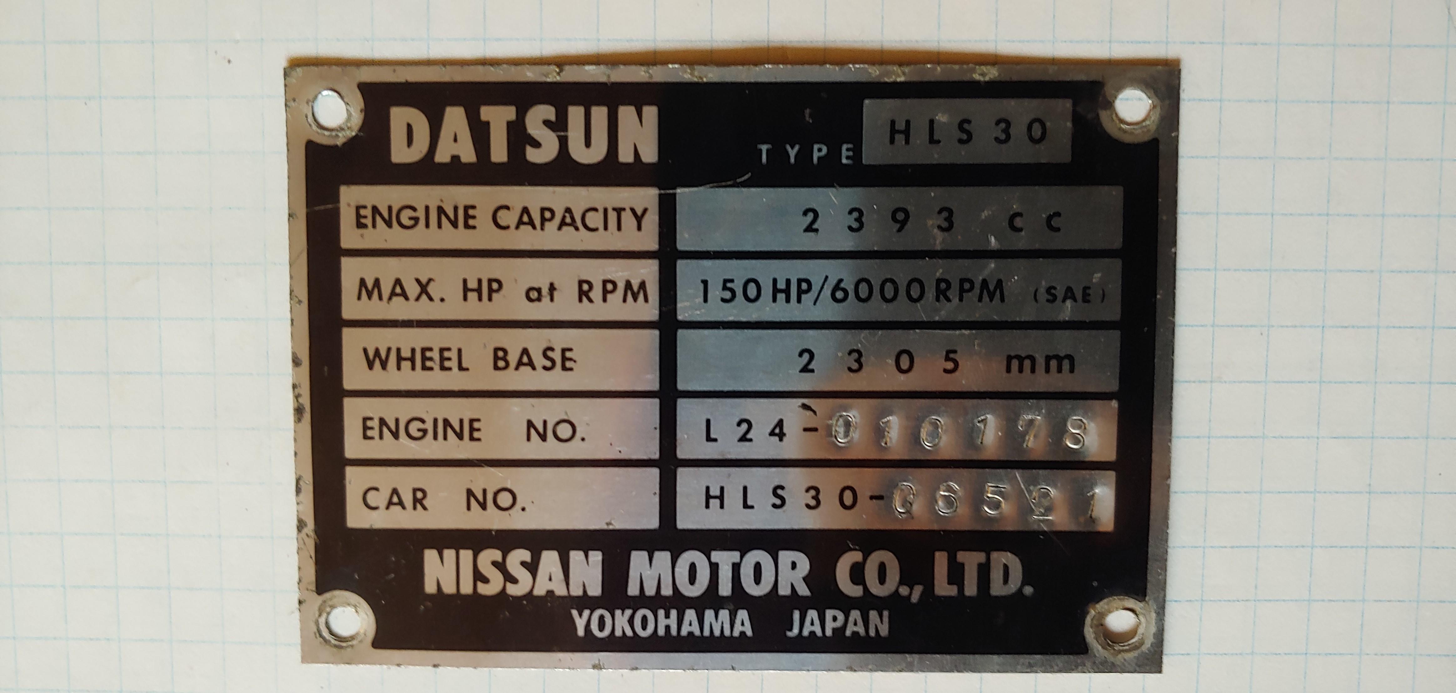

8 hours ago, JPeters said:
Which are the correct dies if I want to do it myself? For a 1970 240Z.
On 6/24/2020 at 6:12 AM, grannyknot said:

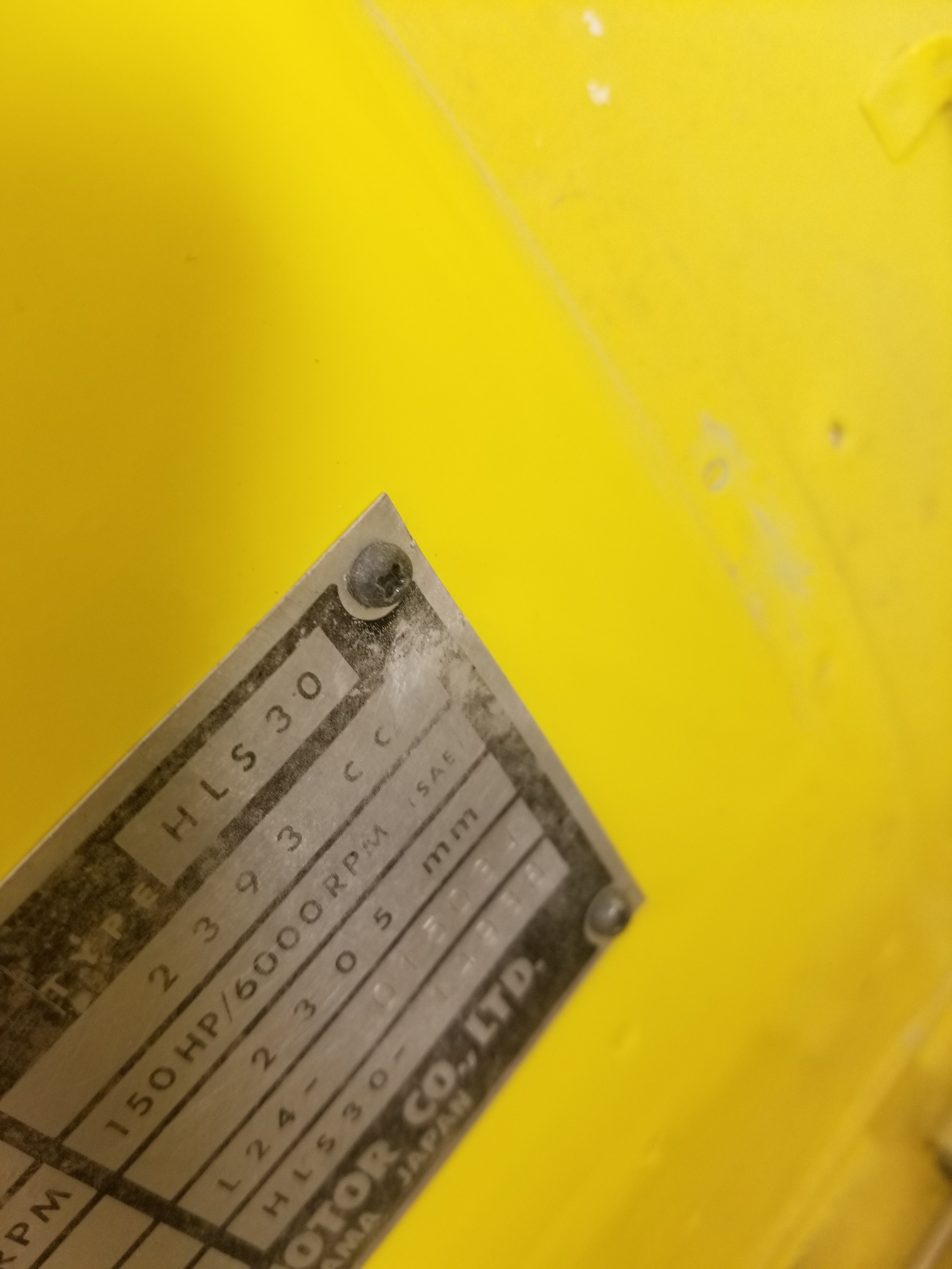

I just went out and checked my 240 and the door tag numbers are 4mm but if you are going to stamp the numbers yourself you will have to make up a jig so all the numbers have the right spacing and alignment, free hand won't work.

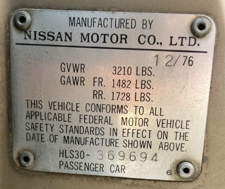

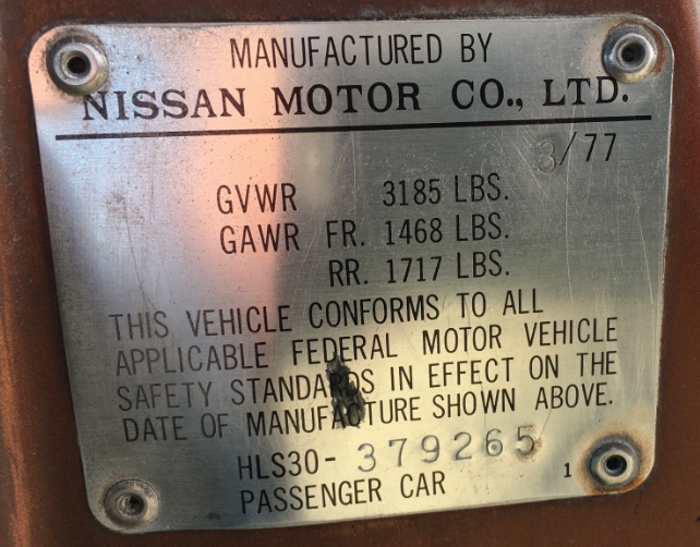

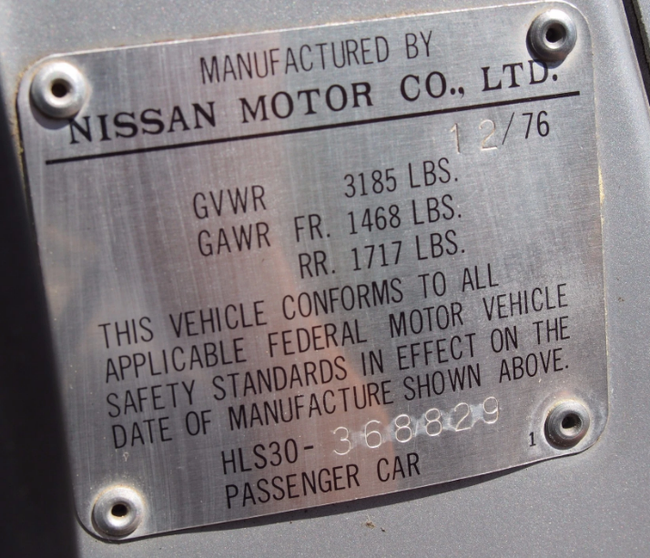

Here's some examples.  Looks like Nissan had their stamping act together by the late 70's.  Make sure the upper rivets touche the top of the N and D, and don't overlook the little 1 (edit - I found one with a 6.  A new puzzle) in the bottom right corner.
https://bringatrailer.com/listing/1977-datsun-280z-7/
This one has a 6 though.  https://bringatrailer.com/listing/1977-datsun-280z-47/

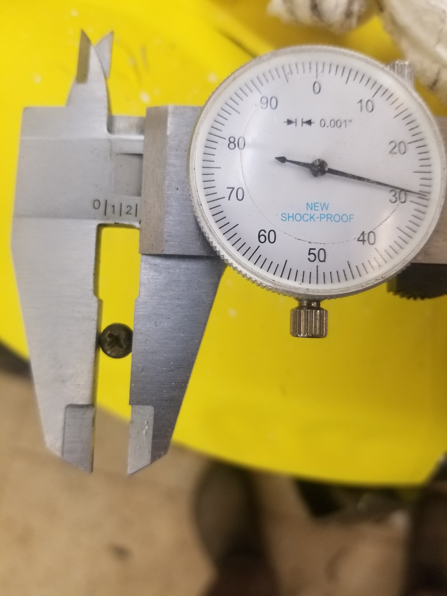

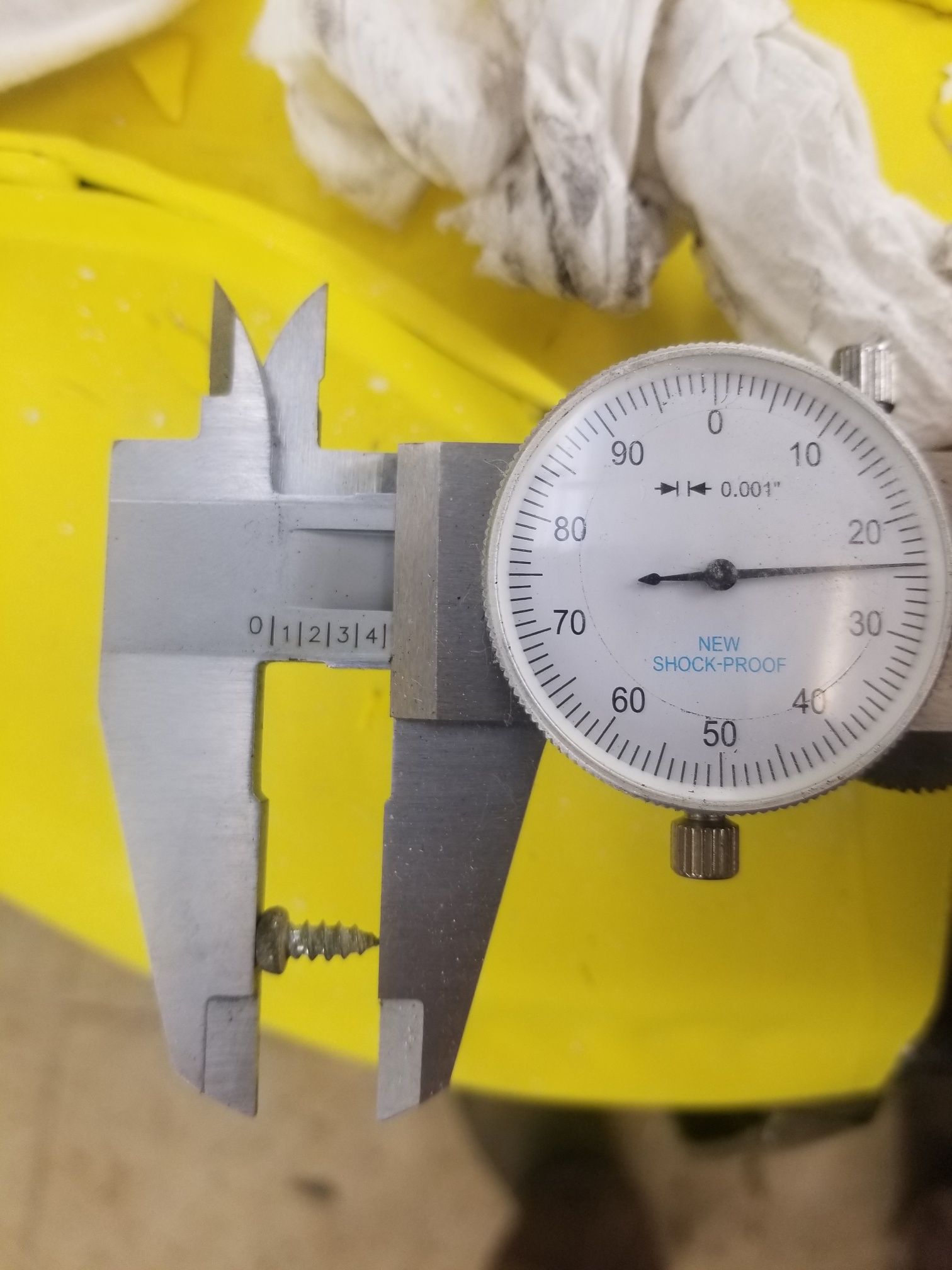

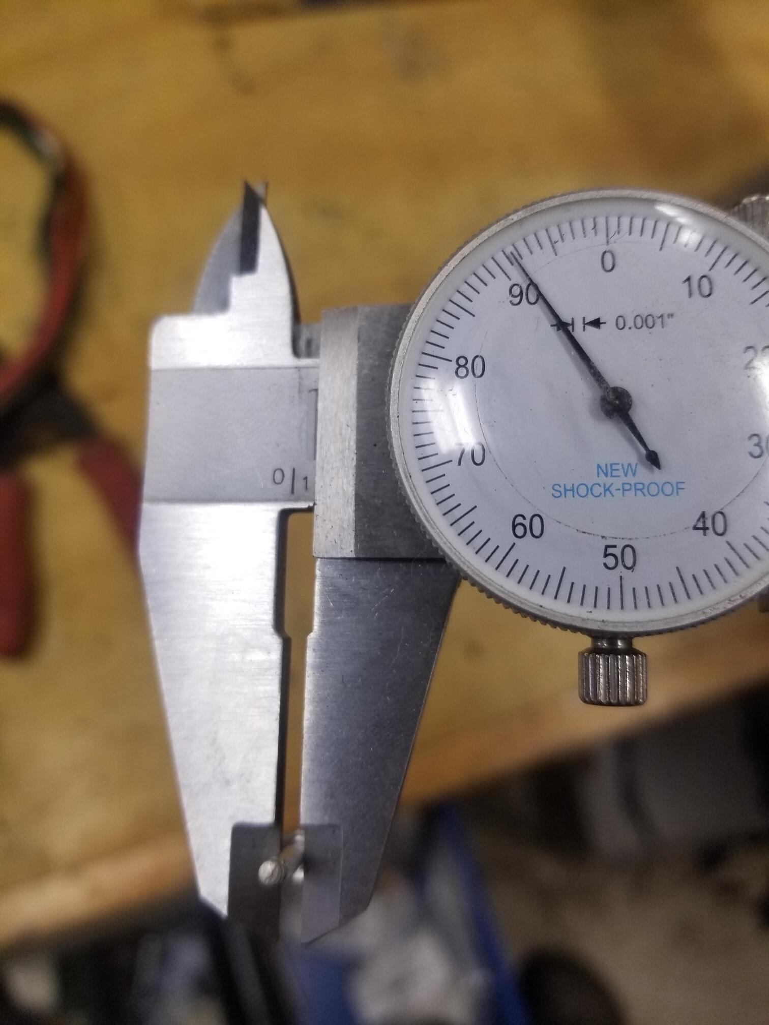

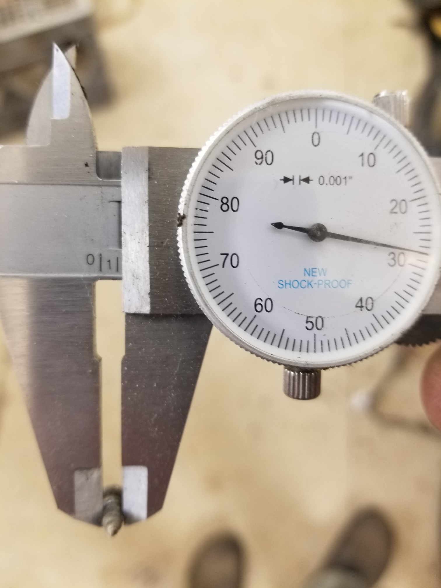

15 hours ago, Patcon said:

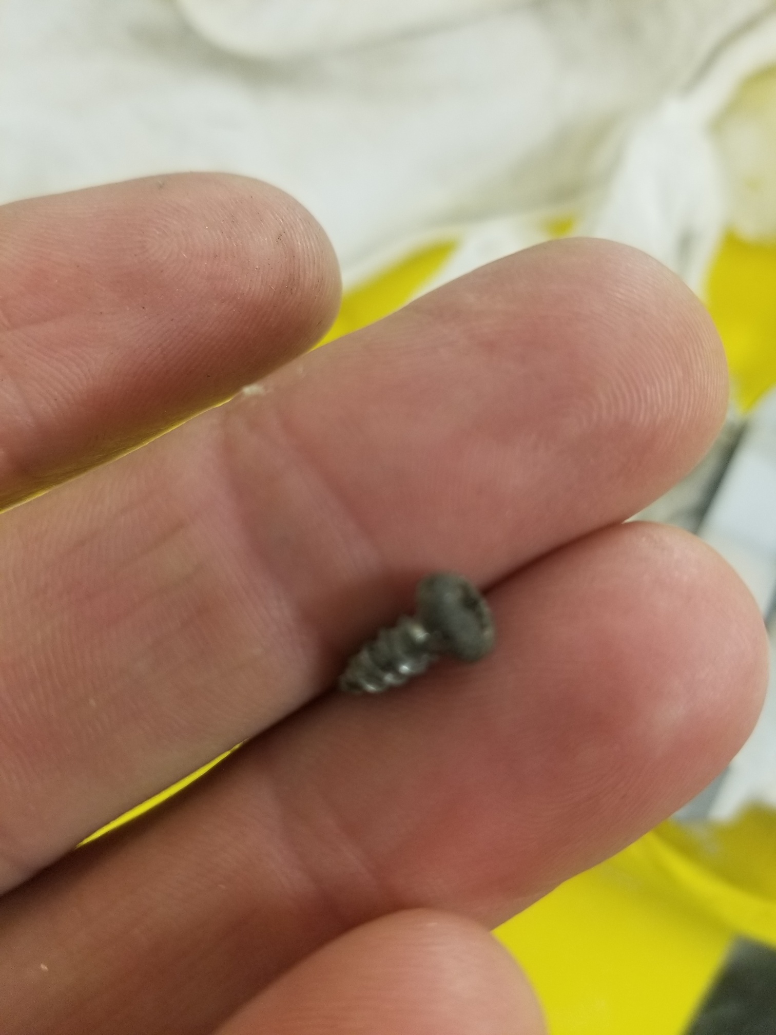

I'm not sure what the original finish was on these screws

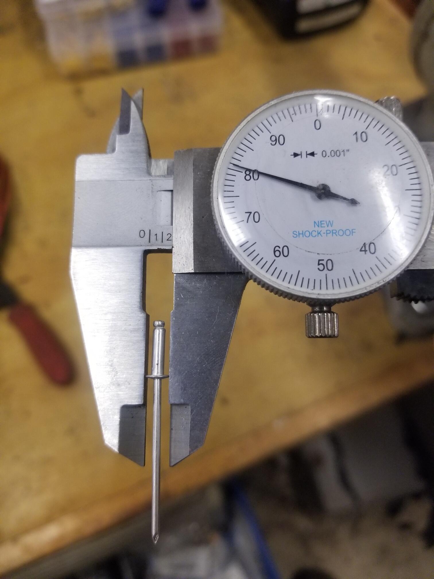

Rivet is basically a 3/32 rivet. The box I have of them is unmarked
Thanks @Patcon - I'm thinking of using aluminum rivets and stainless screws per your measurements.
