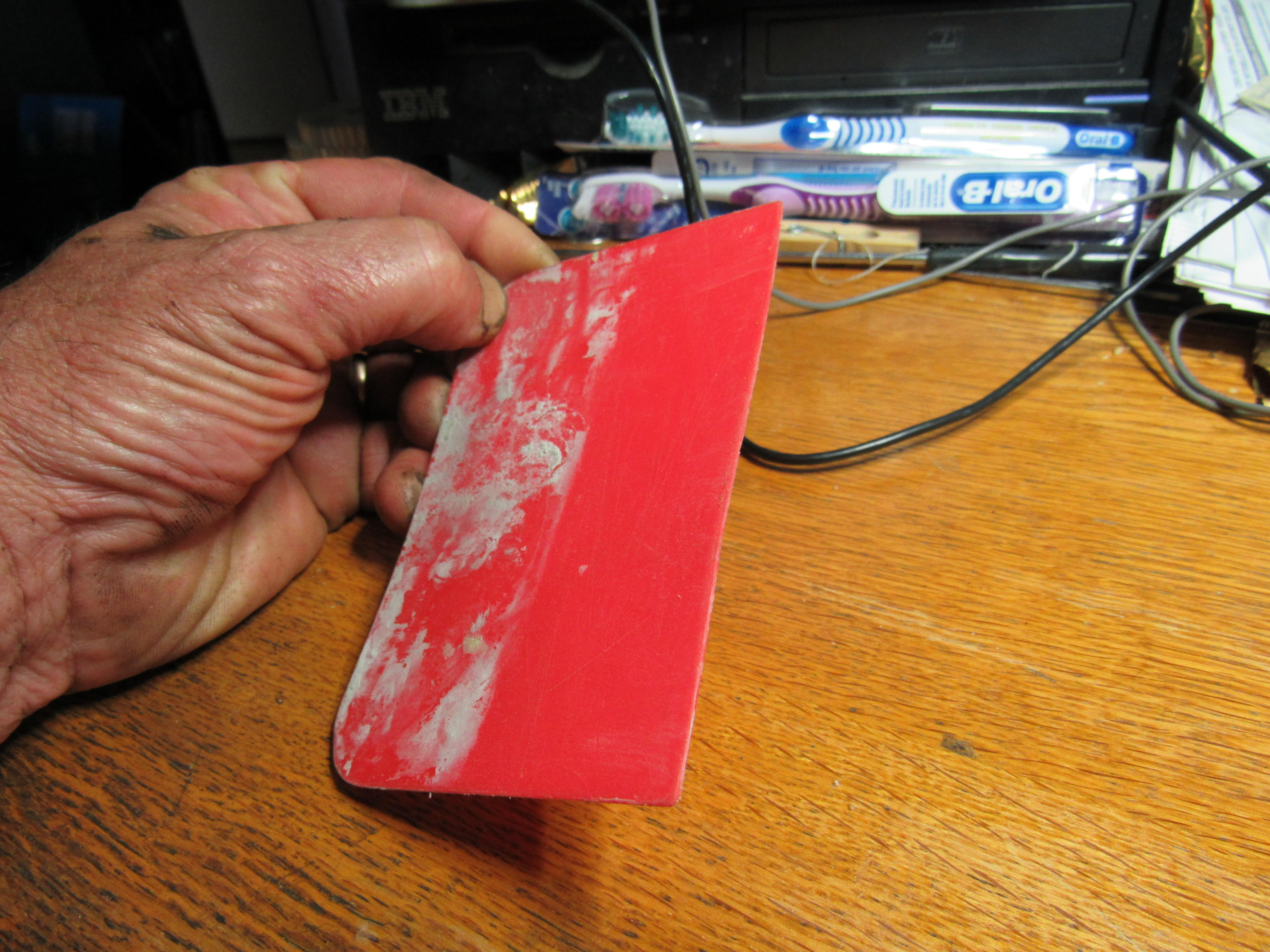

I should have been more specific, I use these cheap throw away body filler spreaders, very flexible.IMG_0061.JPG
