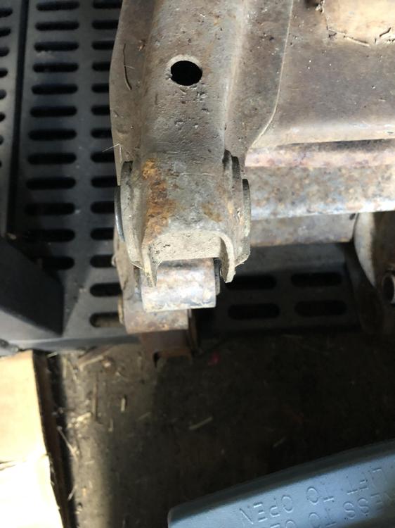

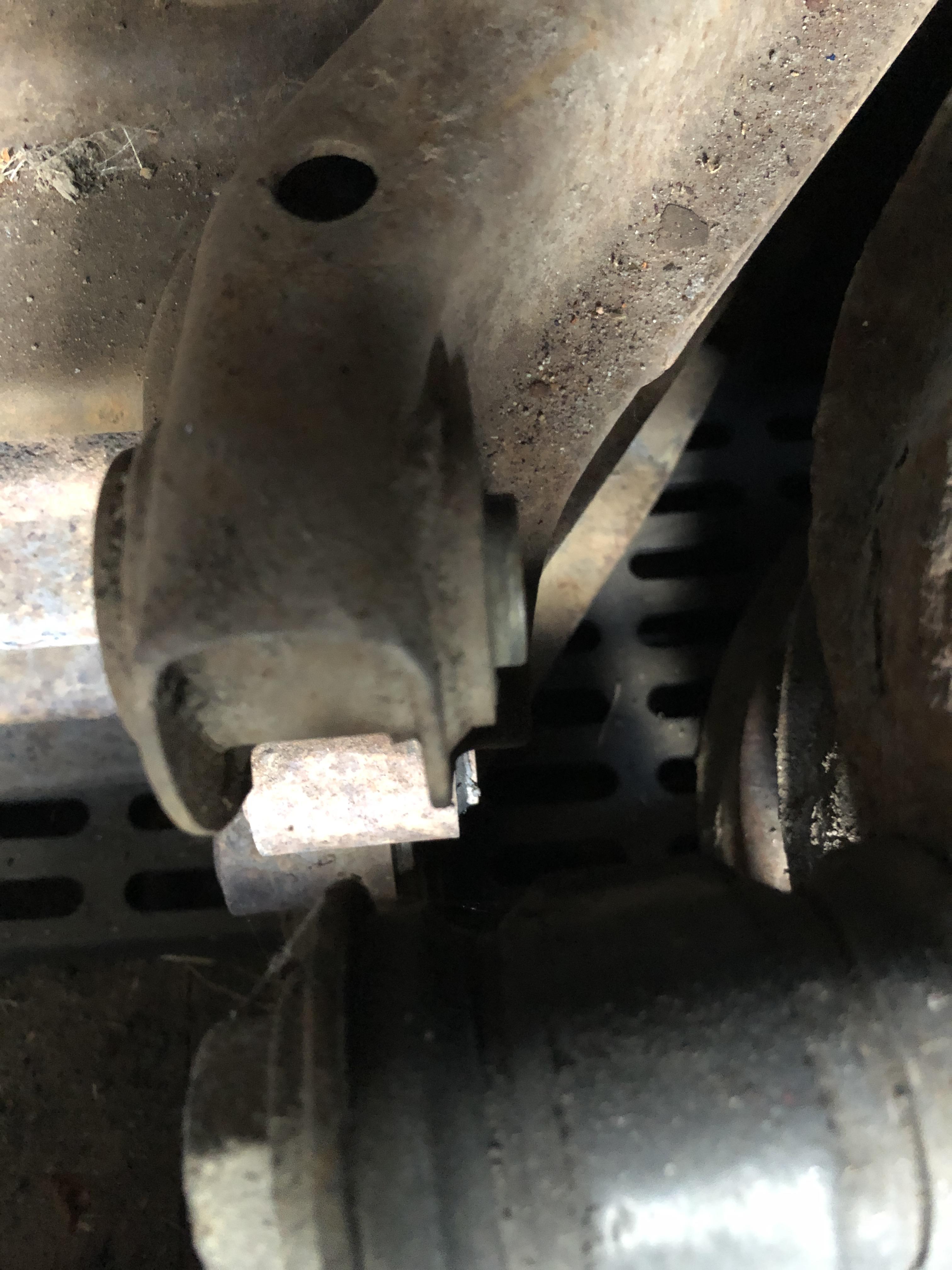

I’m not so concerned about the slightly sloppy fit of a 5/8 bolt as remember the strut and bushing core tubes are torqued together by the bolt/pin and locked solid to one-another.  The bushing rubber provides ALL the rotation at this joint. That’s why you torque this together with the car on the ground and driver weight in the seat. You want the rubber at its neutral position most of the time in use.  The locking cross pin provides a way to prevent the spindle pin from rotating while torquing (you can do either end independantly without using the other end as a backup) and is a fail safe in case all the nuts fall off.
I also just inspected a half dozen old crusty control arms that still have the bushings installed to see where the center bushing tubes have come to roost left/right offset wise after years of use, to see if the initial offset made any difference other than assembly with the strut housing ease. What I found was a bit surprising.
The front bushing clearly shows the center tube still offset toward the outside of the control arm, but the rear bushing tubes where all darn close to centered now, maybe just a tad offset to the outside. Not sure if 6 controls arms is a representative sample..... A testament to the dominant direction of travel and forces applied differently?
One set of new bushings I have laying around has the offset center tubes. No clue as to vintage. I have a set to install today, I’ll use the advice and experience detailed above. Thank you.
