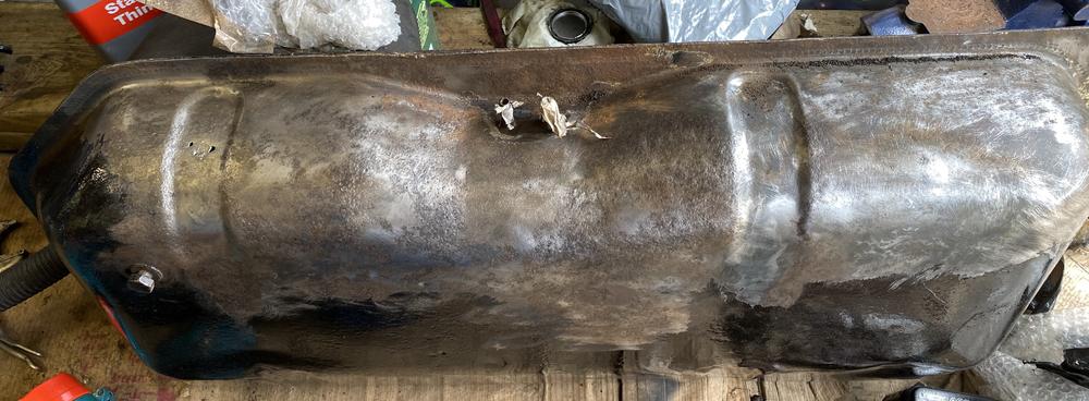

Was that tank holding fuel by virtue of undercoating?
Ha!! Well, I have a theory that the internal coating combined with paint and under-seal were helping the rust particles hold hands as it never leaked there. In some ways I wish I hadn’t bothered clean up the tank. But in the same way, I’m glad I scraped away all the orange metal to avoid other holes appearing. New tank is on the cards but for now I’m going to fix it and kick that cost down the road a few years.
We think the PO had the tank internals treated so as to fix this pin hole issue (I suspect my aggressive wire brushing grew the holes).

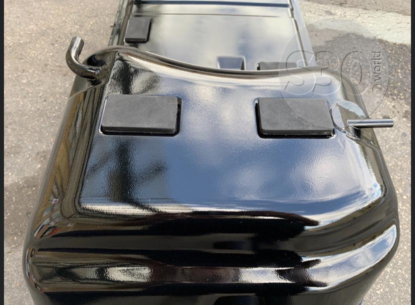

$660 shipped to USA seems a bit high priced. And you need to modify the car too.
To fit on a US market car you have to delete the smog return line that starts from the left front inner-fender.”
Aside from that, it’s a great looking part that no one else is doing. I like that it’s galvanized and painted.
Edited by SurferD
I would have been happy to pay that for a new tank for my 75 280z. How different are they? I know in 77 they went with the space saver tire and completely changed up the tank, but this new tank looks a lot like my 75.
I had the same thought for my late ‘77 260.
The only real difference that I can spot from the photos is that a) it’s for more pipes coming out of it and default_cool.png the bottom is a different shape with the drain plug in the middle rather than to the side. But I am no expert of course.

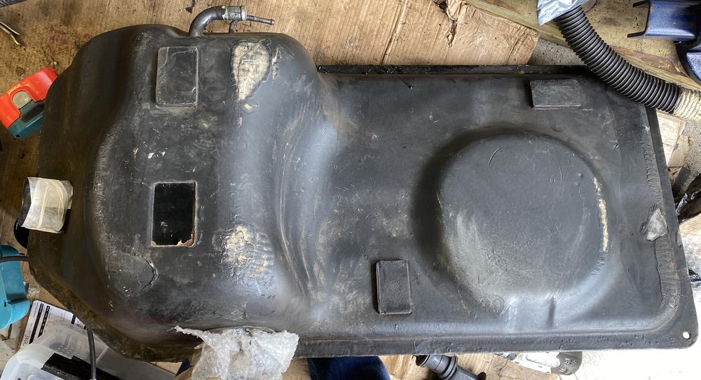

My tank looks like this ...
95b15c3179622debcea4090be1d5cefb.plist&key=3aafdf391f9b9434c28ce44d0496e7180a4d4efadcb999e2eab65b6e6f309278
07a87a81b3760df7166a74a36d526e2f.plist&key=12547baa3a31bb498b29433be2ca63a2c2051e99d5ac425d46a62aeb99b5a5fe
Theirs ...
7be05826d71e9588bec732c01a82b06d.jpg&key=6a464d2f093400a434805d9105f817d2b2addd39ac5ea5ea75d0214236ddedb7
388c7ef3fe945a38ecd832ecfa0f92f4.plist&key=a3e75c6bde8ee6f2c9d0ac583d5c7fd7d39fbc6aaf5fa15397257f301fe985e96bade88f48d5df7ee7eba8d7907a34bb.plist&key=881ec3c56c770cc4b8020b2582d89dd0982b76e23e263170e5ccbec834130bb9
The 1/4”’breather hose is the same side as the large one on mine but located the opposite side on theirs.
Also I have an extra round bulge (not me personally you understand!!!) on the top of the flat bit which they don’t have.
