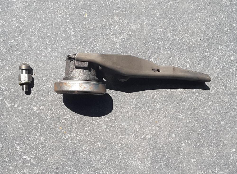

This is a picture of the old collar, but I installed the new one the same way.

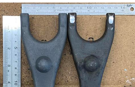

I don’t think it has anything to do with the fork either. I used my old style fork with the hole in it because I’ve heard people prefer the adjustable slave cylinder. As far as I can tell, the old and new style forks have the same geometry.

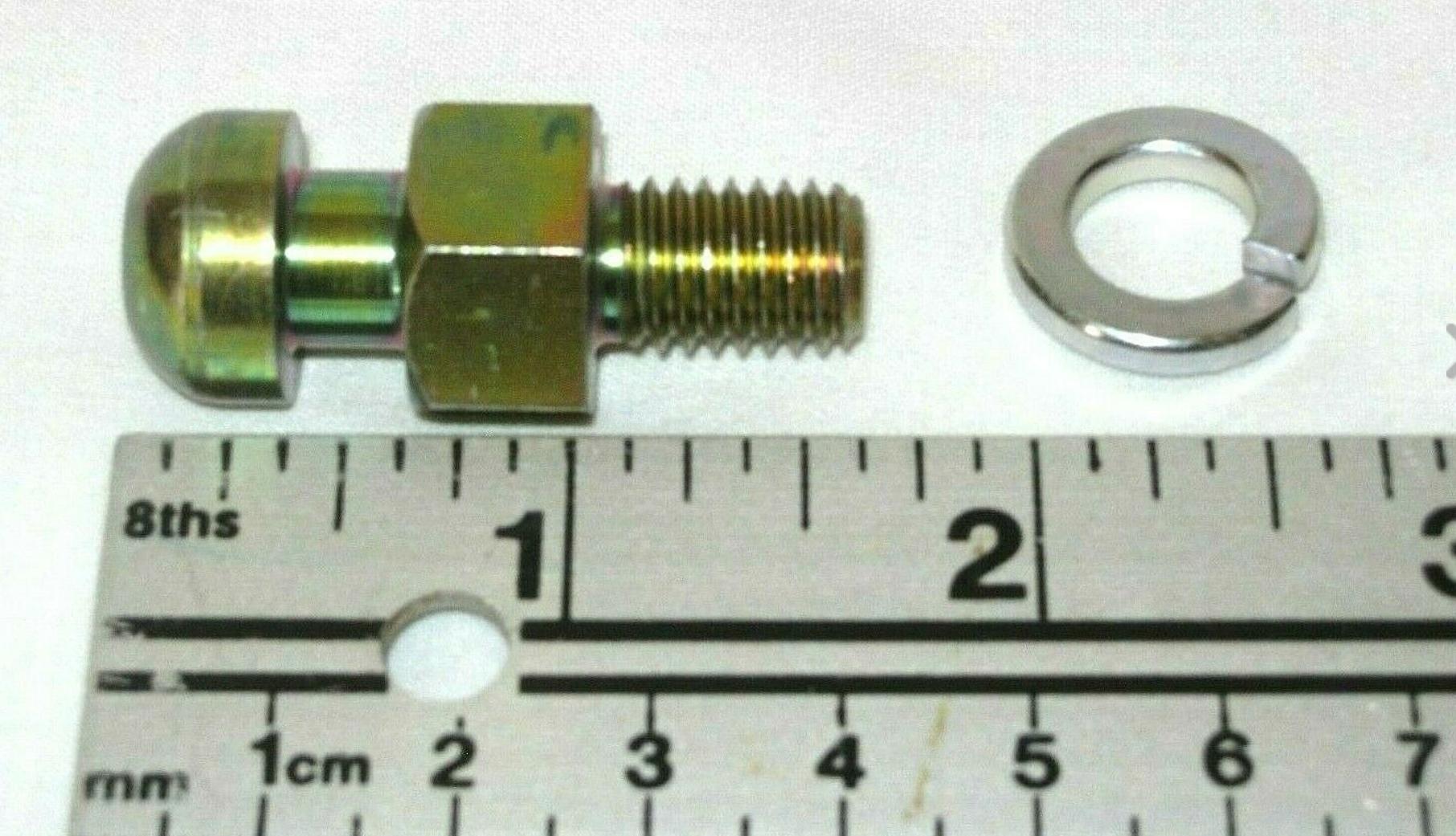

Hmm looking online I found this longer looking pivot:
https://www.datsun-garage.com/products/oem-clutch-fork-pivot-ball-1972-83-240z-260z-280z-280zx
I’ve never seen one like this, but it appears to be much longer than the one in my 4-speed (which is the same one in my 80-something 5-speed I have sitting around in the garage).
I'd use the newer fork myself.  The pressure plate and slave cylinder and throwout bearing/sleeve/collar will be designed for the newer fork.  The older fork is the one odd piece in your collection of parts.  The pivot ball looks in good shape.  The one you showed is an odd style I haven't seen before.  Might be an aftermarket part.
Plus the wear on the old fork will lose a little bit more travel.
Maybe that’s worth getting and trying.  I’m getting really antsy to move this project along, but I’m sure gonna regret it if I can’t throw the clutch once everything’s in the car

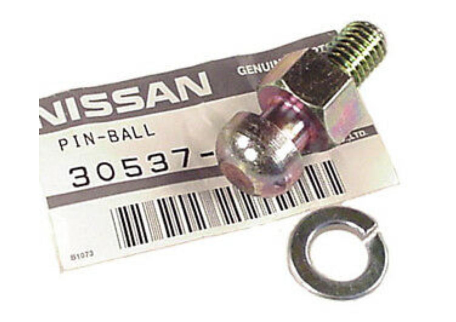

That is not the original pivot ball. Looks like one out of the RB engined cars, Skyline R32 etc. P/N:30537-RS581

Part number: 30537-21010
You should measure 26mm from shoulder to top of ball.

In the last two photos are my spare fork, throwout bearing and pivot out of a 300ZX. The throw out bearing/collar measure 42mm. That would mean a pressure plate on the bench would need to be 50mm. The 300ZX plus a lot of other datsuns/nissans with the F*71A B C transmissions use the same pivot ball.

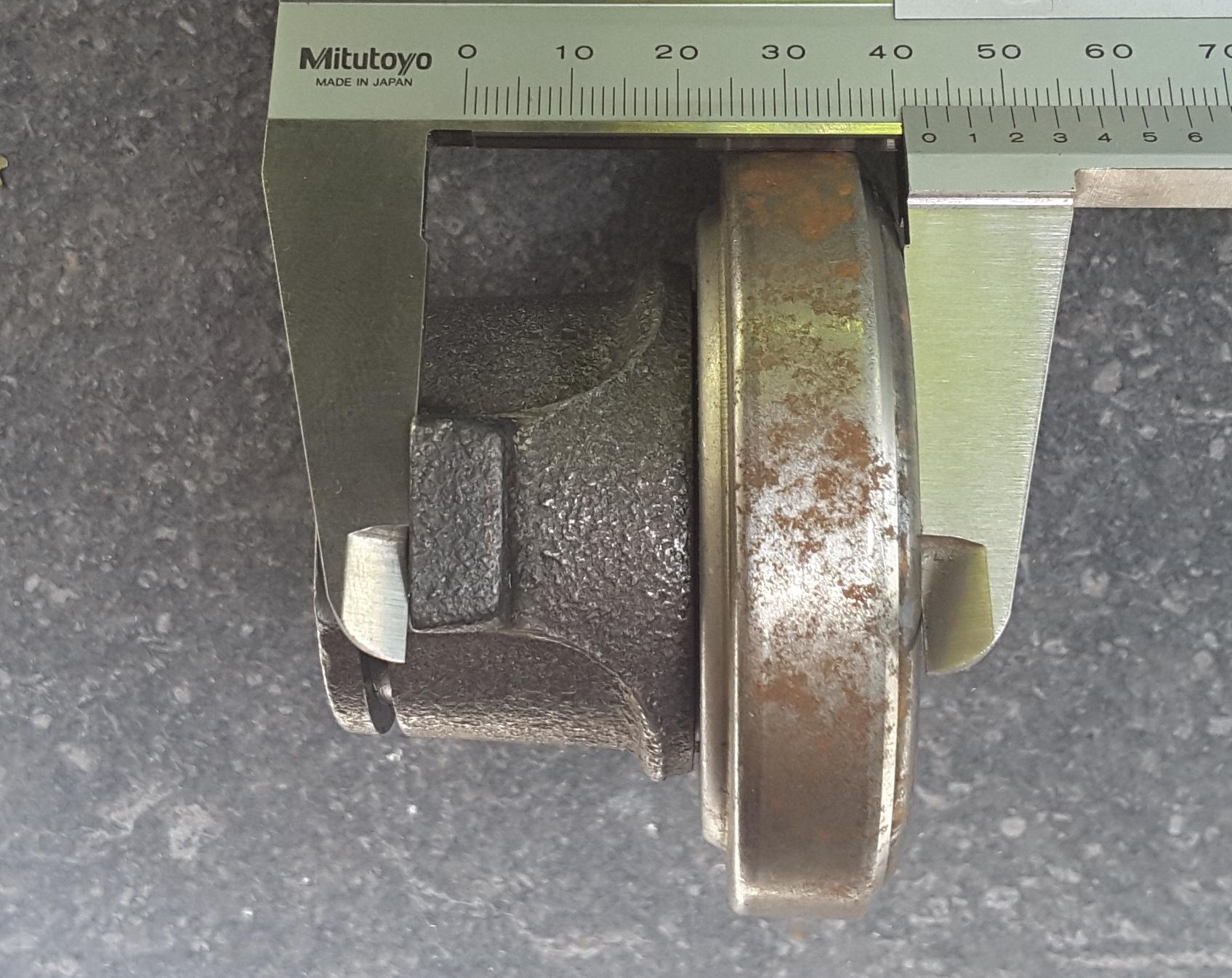

Took the pressure plate off again this morning and took a final measurement of the stack up. It looks like I’m right on 91mm from my bench to the ears.
That’s 47mm from the TO bearing/collar and 44mm from the pressure plate:

Fork geometry: Both my new style and old style forks have identical geometry, which matches those from @EuroDat: 120/65

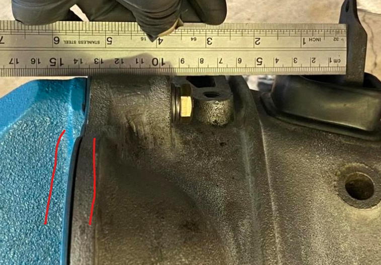

Is there a gap between the engine and transmission?  That will move the pivot ball back.  Picture below.
Do you get the same distance with the new fork installed?  It's a lot of work putting it all together to check, but it's the last unknown.  Maybe that older fork is deformed somehow.  It's the actual contact surfaces that matter, you can't really tell from the outer dimensions.  The pivot ball could be "sunk" in to its seat on that older fork.  The fork "tines" have a lot of wear visible.
Hard to tell from the photo, but no there’s no gap. The bolts were torqued down to spec when I took the measurement.
