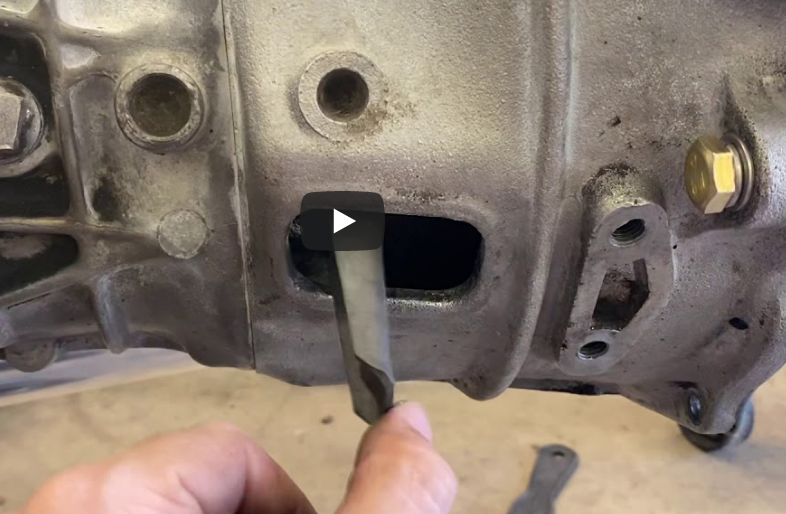

I went back and watched your video and when you move the fork I don't see the bearing/sleeve moving
It's a little hard to see in the video, but the collar/bearing are definitely moving when I move the fork.  When I'm flicking the fork forwards you can kind of hear the sound of the bearing "slapping" against the springs.  I shined a flashlight in there and watched it move, so I'm pretty confident the bearing/sleeve aren't bound up. There is the little circular retaining "clip" that goes around the collar anyway that holds the fork tines to the collar ears.  This keeps the two pretty well coupled so it would be difficult to pivot the fork without moving the collar, right?
