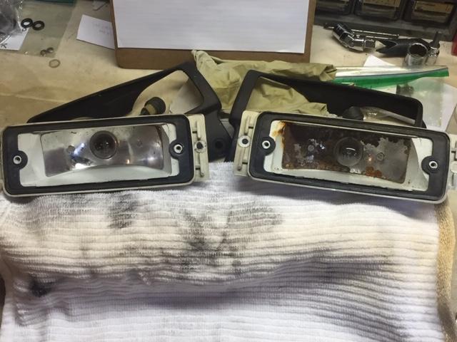

AIt's metal, I take it out and polish out the rust first.  If you plan to use LED's you can get a reflective material at the hobby store they use to skin gas powered model planes.  If you want you could have it re-plated but you could buy new set for that price
I appreciate all those ideas.  I'll have to check tomorrow, but I was thinking that the original reflective material was too damaged/rusted to simply clean it up and polish.  The chrome rustoleum paint may be the easiest/simplest solution...or perhaps look for some of the reflective material from the hobby shops like ajmcforester suggested. I'll update when I get er done.

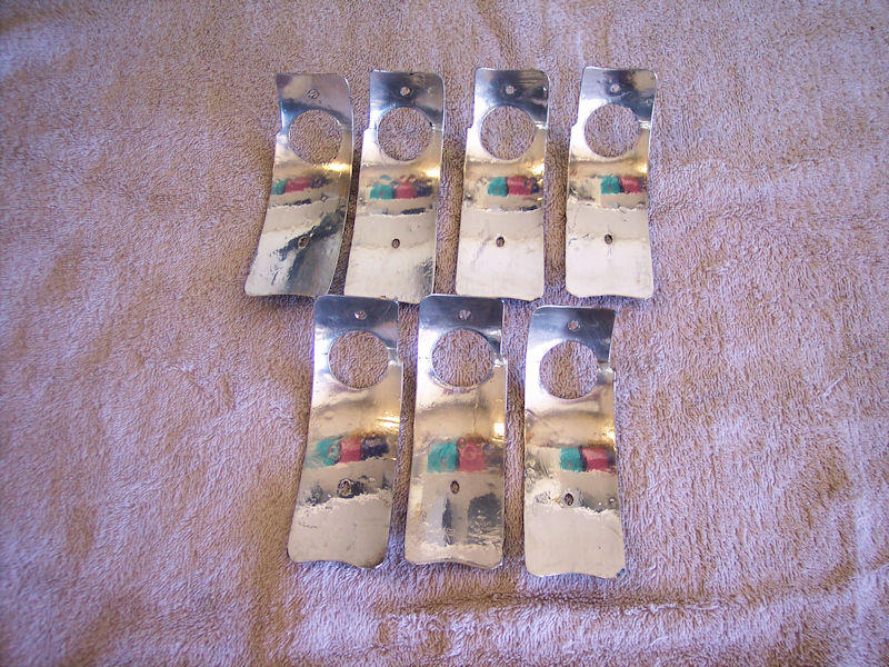

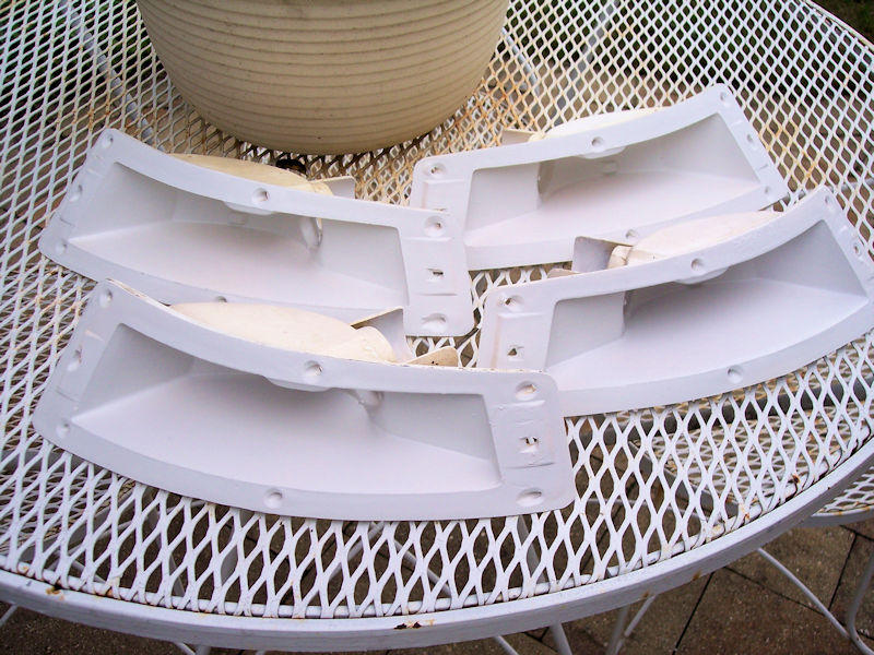

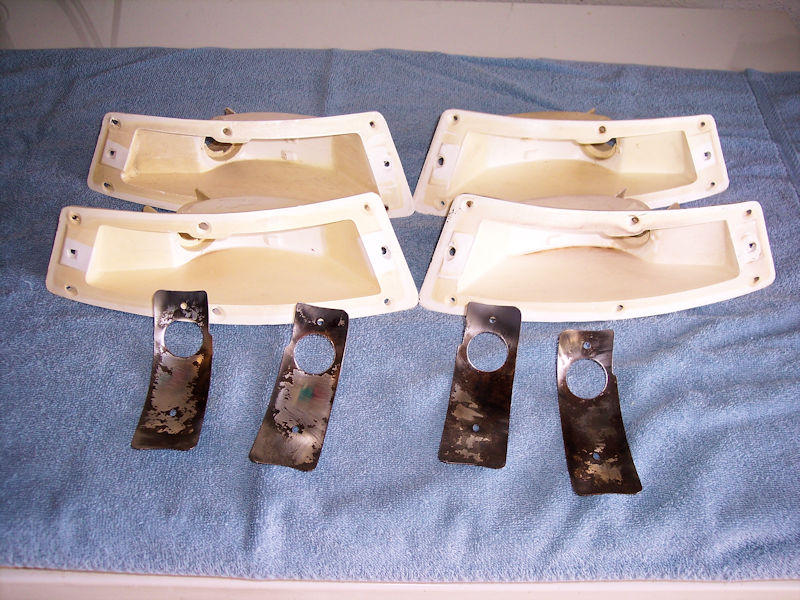

I've been refurbing some of these and used the metallic A/C tape with success. I removed and sanded the reflector smooth, applied the tape, then buffed it shiney with jeweler's rouge. I also cleaned and painted the interior of the housings. PM me if you have any questions on the details.

Photo attached for clarification.  The reflective coating inside one of my turn signal lenses has rusted to the point that it is not functional.  What would be an effective way to restore this?
