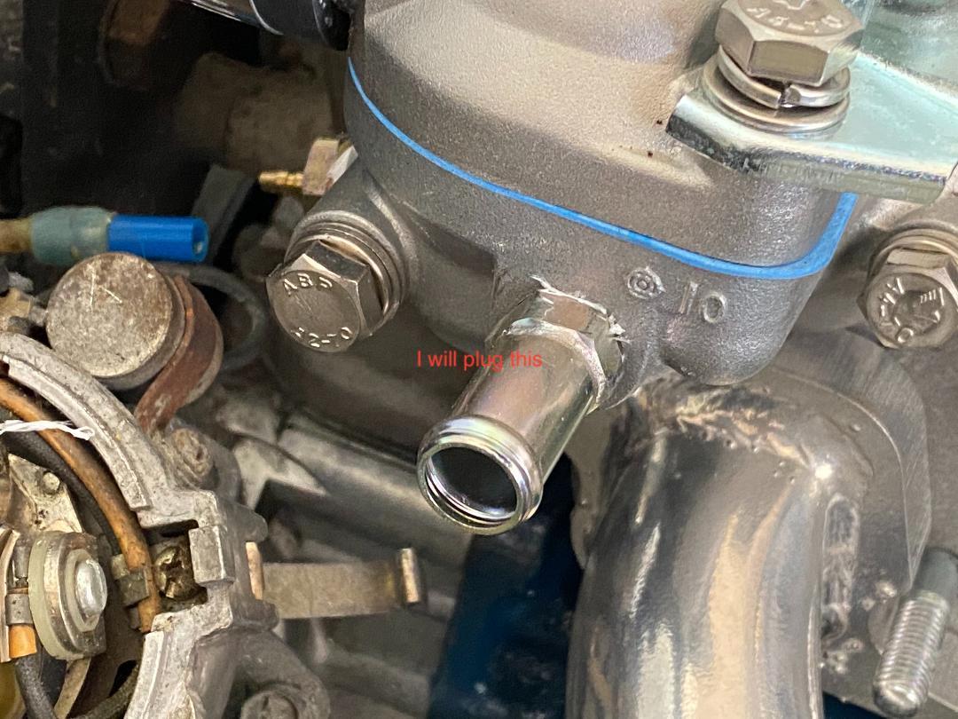

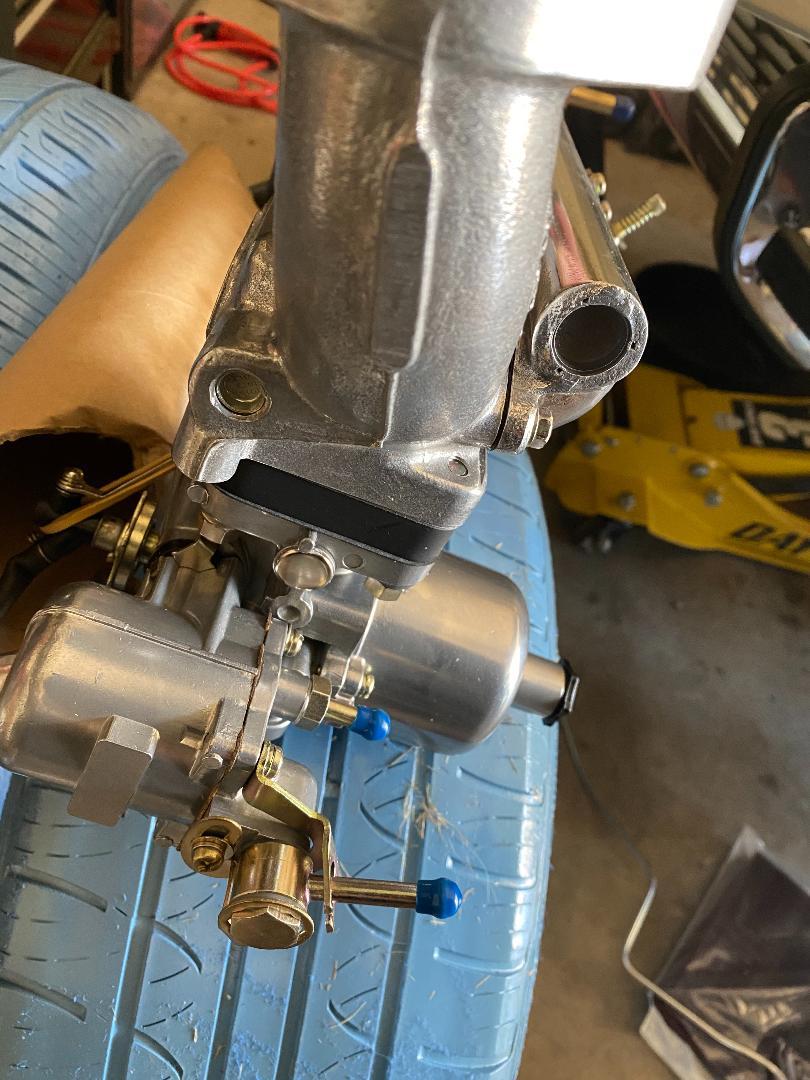

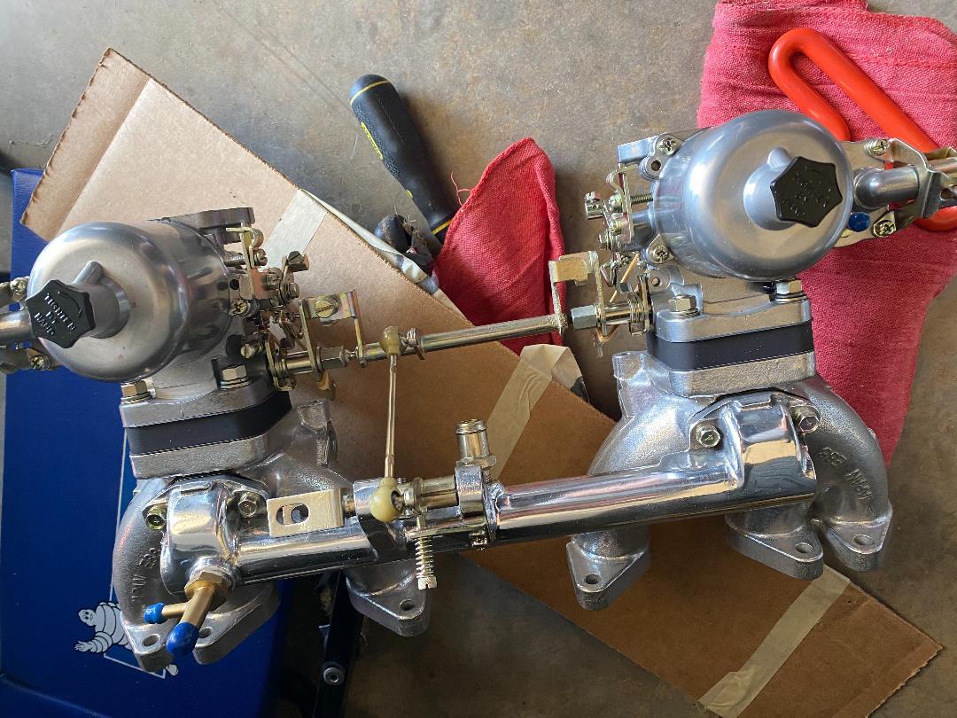

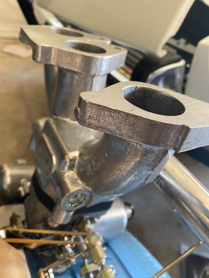

I received my carbs from Ztherapy and I ended up with the Euro style balance tube.  Miscommunication but it looks good.  Because of this I no longer have the coolant going through the balance tube.  I did not prepare for this so I am trying to figure out how to "plug" the coolant lines that would have gone through the balance tube.  Does anyone have pictures that show how to address this or can you suggest? Thanks in advance and see my pics below.
Coolant runs through the intake manifold and not the balance tube. Did you send them your manifold or did they supply you with a reconditioned one? If you have your old one you should be good to go. If you sent them yours it’s odd they did not send the same one back.

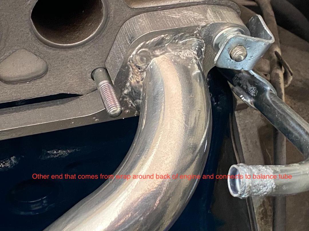

I sent mine in for a core and they sent me another one back.  Here are the pics where it is plugged up.  I really do not need it going through the intake manifold since I live in warm TX.  Here are pics.  What have others done in this situation?

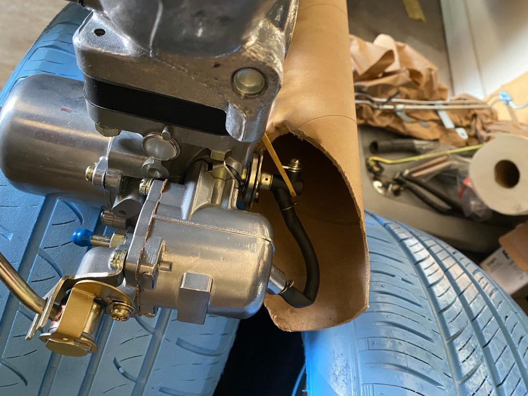

The plugs installed in the carbs by Z-Therapy mean that coolant will be present (*maybe) in each carb's coolant cavity and in the hose leading into the cavity... but it won't be flowing.  For that reason, the coolant will just assume the same temperature as its surroundings (i.e. the carb block casting).  So: if the carbs are at engine-cold condition, the coolant in the carb cavities will be the same as the carb blocks ('cold').  And if the carbs are at at engine-hot condition, the coolant in the cavities will again be the same as the carb blocks ('hot').  Put another way, the coolant will not be performing any kind of heating (or cooling) function for the carb blocks.  It will just be sitting there, 'along for the ride' as it were.
(* I say 'maybe' because it seems quite possible that coolant will never actually find its way into the carb blocks' coolant cavities when you fill the coolant system.  That's because there's no bleed hole in the carb block coolant cavity to let the air escape and the coolant enter.  I suppose that gravity might let some coolant find its way from the thermostat casting down into the front carb cavity, but I doubt whether coolant will be able to flow uphill into the rear carb cavity).
Bottom line is that you just hook up the coolant hoses to the front and rear carbs.  Job done.

What Siteunseen has done achieves exactly the same net effect:  no coolant flow to the carbs.  You can do what he's done if you want.  However, the plugs put into the front and rear carb body coolant ports by Z-Therapy mean that -- for you, with your new carbs -- there's no need to do what Siteunseen has done in his set-up.  Nor do you need to worry about the pipe connecting the front and rear carbs.  It's long gone and irrelevant.

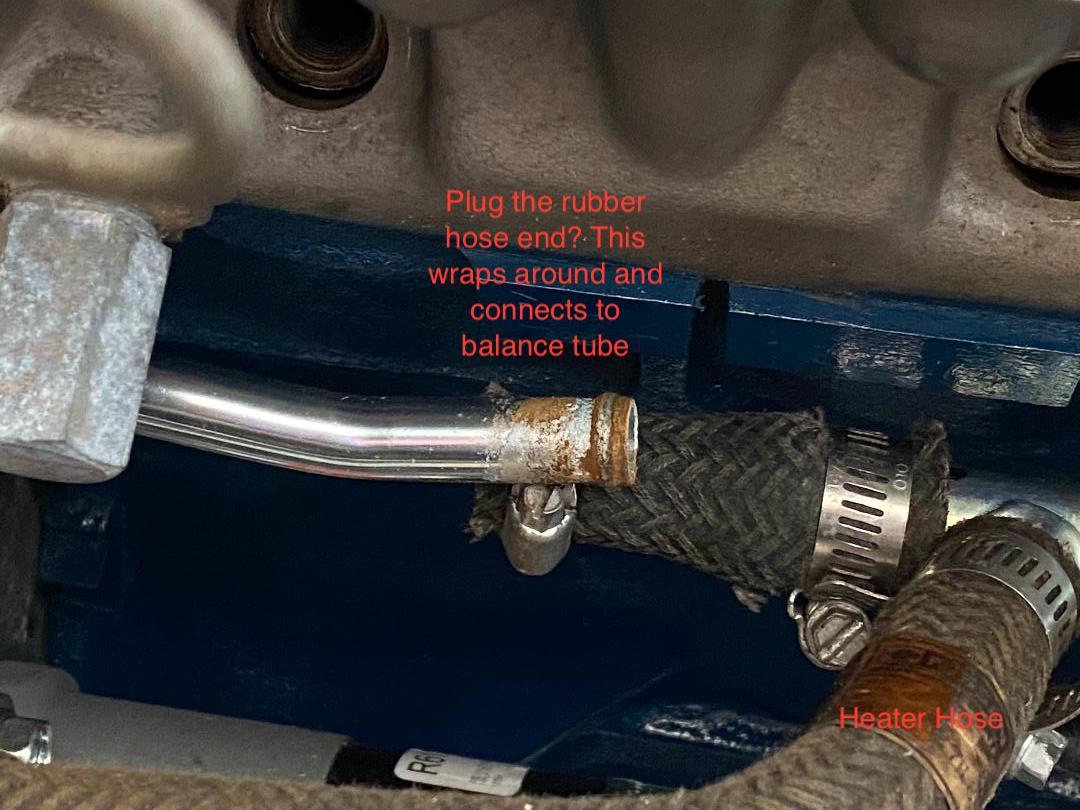

I believe he capped it off at the red circles so I believe that is best method.  I have already done the thermostat cap but what do you do to cap it at the Y in the lower red circle.  Do I have it go from the metal Y to the little bit of hose and then find a cap that fits that hose?  Ideas on that.  Also the carbs were shipped without any oil.  Seems I need 20W oil and the only 20W oil I can find is fork oil.  Is that what I use?  Thanks again and wish me luck. I have had this apart for 5 months waiting on the carbs and I just received them and should have taken more pictures of what goes where...

Easy peasy.  Put a pipe plug in thermostat hole.  The pressed in plugs (four) in two carb manifolds are good, or replace with pipe plugs.  Remove the "Y"  adapter, and replace with a straight piece of tubing.  Remove everything from the "Y" fitting to the thermostat.  Plug the hole in the end of the balance tube unless you need more vacuum fittings.
