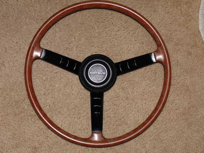

Back here at home, I've got the heater box cleaned and the first coat of paint applied. I also have begun stripping the paint off the steering wheel, in preparation for repainting the spokes on it.

It's been a while since my last post, but not a lot has happened in that time. I did finish re-finishing the steering wheel spokes, and I think it turned out pretty nice. I stripped and re-painted the spokes, but left the faux-wood rim alone. Trying to maintain its patina, I guess.

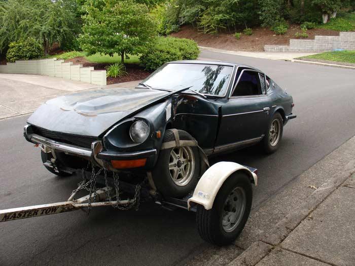

Yeah, I need to borrow a truck again. Because next weekend I'm going to pickup another 240Z, to be used as a parts car. This one is a later '71, and is basically totaled. It had a touch of rust under the battery box when the current owner's son spun it and slid into a telephone pole between 2 and 3 years ago.

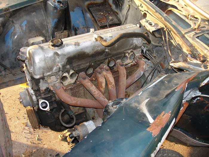

No body panels are undamaged, and the driver's frame rail is collapsed. So the body shell is trash. The engine is supposed to have been in great shape prior to the accident, but the fan was pushed into the radiator and so it hasn't been started in close to 3 years, and I have no easy way to confirm its condition. Until I have a chance to look into it in depth, I have to consider it to be a core.
Besides the engine, it has an early Type A 4 speed that I could keep as a spare, or sell. The engine has a decent looking header and 2 1/2" exhaust. The rear differential is the one I want (3.36:1 to match my 4 speed). The console is darn nice. Rear glass is good, with the proper vertical defroster grid (that is said to work) and professionally tinted. The turn signal switch seems good. Nice gauges (although the clock appears to not work). The radiator does not seem to have been damaged by the fan, and was only a year or so old at the time of the accident. The front bumper bar MIGHT be salvageable. I'm told the springs and shocks are all Tokico, and fairly fresh. Dash is about the same as mine, one small crack in the center. A badly corroded set of 14" six spoke ZX alloys, and decent looking 4 screw carbs. Other miscellaneous parts too, of course.
So next Sunday I go to pick it up, not nearly as far to go, only about 40 miles round-trip. Once I get it home, the first thing on the list is to try to assess the engine condition. Once that has been dealt with (one way or another), much of the rest of the summer and fall will be devoted to stripping everything useful from the wrecked shell so that I can get it hauled off to be crushed. Some parts may be transferred directly into the yellow car, others may be stored, and some will be offered for sale.
But anyway you look at it, it changes the current emphasis of the project significantly. Pictures and more details after the car gets here.

I picked up the parts car today, and spent part of the afternoon looking it over. It is a later '71, HLS30-27602 built 4/71. It is seriously damaged, but still has a fair number of useable parts, some that will go on my car, some I'll keep as spares, and some I'll sell.
Details will come as I pull parts off of the shell, but the engine in this car appears that it may be useable as-is, at least for a while. (Yes Dad, that means I'm going to need your cherry picker soon.) If so, the yellow car will be fairly road worthy in a much shorter time. I'm going to be checking into that more tomorrow, so my next entry (whenever I get around to it) will have more on that and other good (and not-so-good) parts.

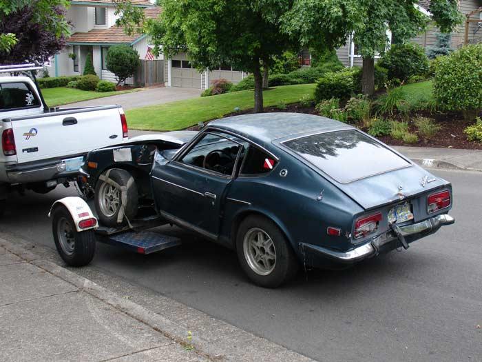

But first - a bit of advice for anyone looking to do something like this: Car dollies are not the best choice if you are going to need to back the car into place.
I'd never used a dolly before, and while I had been warned that backing was difficult, I really didn't understand that trying to back a car on a dolly into place is not just difficult, but virtually impossible. You see, dollies have a pivot so that the vehicle tows nicely. But that pivot makes it so that attempting to back up (especially uphill and around a bend, as I was attempting) creates a wonderful zig-zag jack-knife as the car goes one way, the dolly goes another, and the tow vehicle is helpless to do anything about either. We spent almost two hours fruitlessly trying to figure out how to beat the system, since the car doesn't run and really doesn't even roll well with broken steering. Eventually we gave up, dumped it in the street, and used the winch on the front of the F-350 with a pulley block anchored to a fence post to tow the car into position.

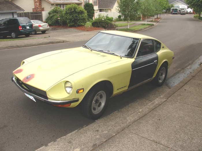

Obviously the big item is the engine. After looking it over, I'm going to stick it in the yellow car and give it a try. It is virtually the same as the one my car would have originally come with, even down to the semi-rare early head casting. I pulled all the plugs and looked into the cylinders, and found no sign of moisture or rust. The plugs were all clean and nice tan color, so it looks like it was running well when it died. I then pulled the cam cover off, and found that it was nice and clean in there too. No sign of even condensation rust on the cam lobes, everything looks great. The engine spins freely by hand, or with the starter. (Although the starter does seem to labor a bit. It is very rusty-looking, and the battery was damaged in the accident and soaked the starter with acid. So I suspect that it is trash anyway.)
So as soon as it cools off some, I'm going to go back out and pick up tools and clean up for the day. The yellow car has already been equipped with a left front elbow vent tube (you 240Z owners know what I mean), the front bumper and the driver's door. It's amazing what a visual improvement even a tweaked front bumper makes. But of course, now the car has a dark blue-green door, so that doesn't help its looks any. (But at least this one's mostly straight.)
