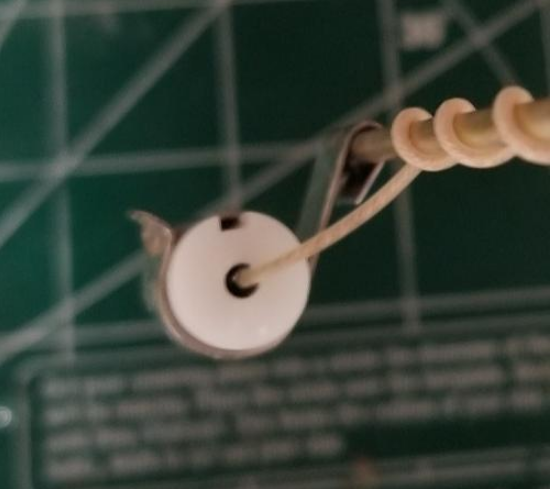

That plastic piece just has to be for locating and protecting.  It's just slipped in after the thermistor is fed in to the can and the wire is soldered to the bottom.  Give it a tug.  It will probably slide right out and expose the thermistor.

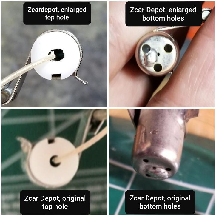

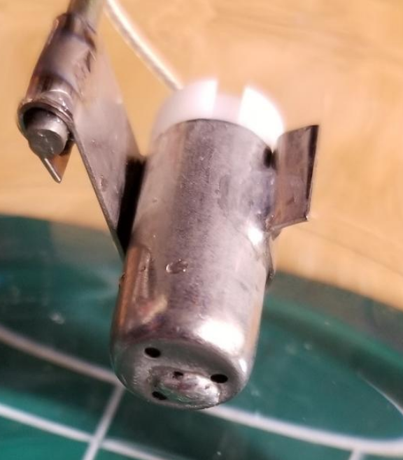

Yes, I did. I carefully enlarged the hole in the middle of the white plastic cap at the top with a fine Dremel burr, and enlarged the three holes in the bottom of the can with a 1/16 drill bit on the Dremel. I performed the "dunk" test in water before and after the mods and flow into and out of the can definitely improved.
That modded unit is in my gas tank now and unfortunately produced the same malfunction as before enlarging the holes. I'm testing the different bulbs on it as reported in my previous post.
I think the "trapped air bubble" theory for the malfunction can be discarded. At this point, with all the tests@Dave WM and I have run, the most probable cause is that the ZCD thermistors in both units I received are not adequate for this application.
Attached are pics of the enlarged holes.
Sent from my SM-N950U using Tapatalk
Oh. Well that's too bad. That would have been easier to deal with. So we're back to needing a different thermistor, or a workaround for the current one.
My read on the thermistor is that (within reason), the cold resistance doesn't really matter. As long as it's on the order of KOhm(s), it should be fine. And as for the hot resistance, as long as it's on the order of a couple Ohms, it should be fine too. But the absolute numbers have wiggle room.
What's really important is that it's small enough that it'll heat up when you push current through it, but not so small that it'll get so hot that it can't be cooled by a gas bath. In other words, what's most important is it's ability to generate and reject internally generated heat.
If it's huge and has big winged heat sinks on it that do a fantastic job of getting heat out of it's core, it'll never heat up enough to get into thermal runaway.
Conversely, if the core is surrounded by an insulating layer, you won't be able to get the heat out of the center fast enough and once it's in thermal runaway, you won't be able to recover. This sounds, at first glance, what is happening here.
But the insulation effect can't be discarded.  You don't know where the thermistor itself is sitting.  It might be jammed in to a hole in the bottom of the plastic piece.  Insulated.  The extra flow could be solely from the larger holes in the can.
Sorry.  But assumptions are the bane of drawing firm conclusions (that's not from a movie, as far as I know.  But I tried to make it sound like is.).
