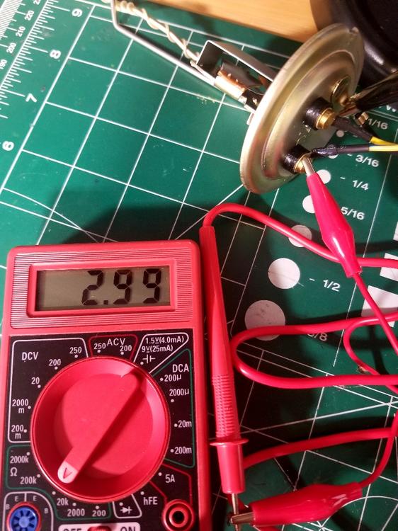

CO how about doing that back probe, I am curious what the lamp off voltage reading is on yours. Hopefully you cable connection is as easy to get at as is mine (the lamp harness to harness that goes along the back of the firewall) for mine they are just kind of stuff under the back of the center console. I do need to work on that area since a couple of the connectors have lost their locking tab (very easy for that wire to come unplugped).

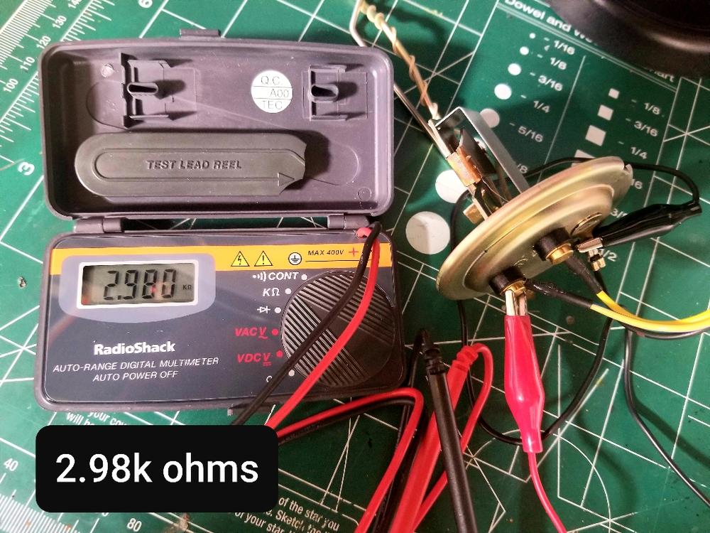

My bulb plug has a 5 inch long harness that plugs into another harness above the HVAC vent. Is that where you want me to check? I have a duplicate sender out on my workbench. Is there something I can do with that sender that will provide the info you need instead?
it can be kinda hard to hold the dvm probes on the sending unit. some jump wires (alligator clips on wires) are a handy way to grab the pins on that sending unit. Just clip onto the black wire and the yellow/blue wire, set dvm to ohms and if auto range you should get the reading. If its not auto ranging start out at the 1k setting and go up or down from there until you get a reading.
Test the setup of the meter by shorting the two leads, should be 0 ohms. always test... test equipment before relying on results.
this is to test the resistance of the sending unit on the bench. My sending unit was about 3kohms (3000 ohm).
all the above test are done with the sending unit out, no voltage required, you are just testing resistance.
The back probing I was talking about was aimed at capt obvious, the assumption is his setup is working so I was wondering what the key on/lamp off voltage was. Mine is about 30-50mV as long as the thermistor is in the gasoline. This test requires everything hooked up and the key in the (run) position.

hmmm well there you go, very close to what I got. for cold resistance.
So just that I am clear, right now with all hooked up and gas in tank say at least 1/2 way full, the light will come on after about 25 min and stay on?
If that is the case, seems like the next logical step will be to back probe, and check the lamp voltage from off to on over the 25 min period. will talk about that later, but its what I was doing in the video. You just have to find that plug, set the voltmeter to volts, and insert in the back so the probes contract the inside of the plug. I am assuming starting with the "2000m" to see if you get a reading if not switch down to "200m"
