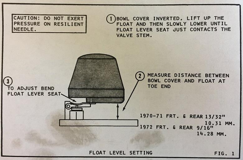

Before the refurbish the car hadn't been run in six years, the carbs were real dirty, the intake manifold gaskets were original ect.. It ran ok but it wasn't the greatest. After the refurb it was running much better. Then today I changed the float level from 14mm to 10.31mm. The car ran much better at 14mm. To set it I blew through the fuel inlet line and made sure the valve was fully closed and not letting air through at 10.31mm. Is that the best way to do it?
I found this spec in the service manual and tried 10.31 because my car is 8/71 build date. Should I use the 14.28 setting?

Got out to the garage. I changed the float setting to shut off at 14mm. There is a bit of studder under acceleration. One of the plugs looked fouled. I am headed out to get a new set and then mess with the mixture settings.
