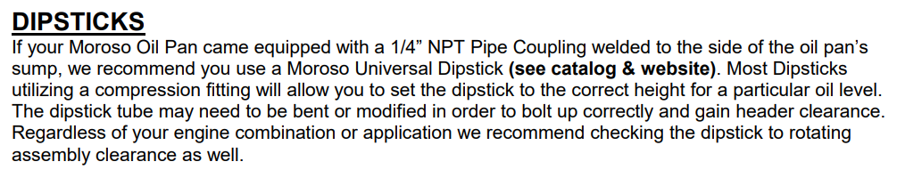

Moroso has instructions for some of their big sellers.  The Chevy small block is one, I pasted a link below from their web site.  The link says "unipan" so it's probably universal.  They describe how to set the dip stick level if the pan comes with its own dip stick port.

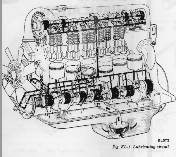

Cylinder lubrication comes from oil being flung from the crankshaft after it passes through the bearings, so if you have a deep sump pickup you're probably fine.  But you're outside of the factory settings so you kind of have to rely on the aftermarket supplier to make sure it's right.

https://www.moroso.com/pub/media/instructions/unipan_inst.pdf
