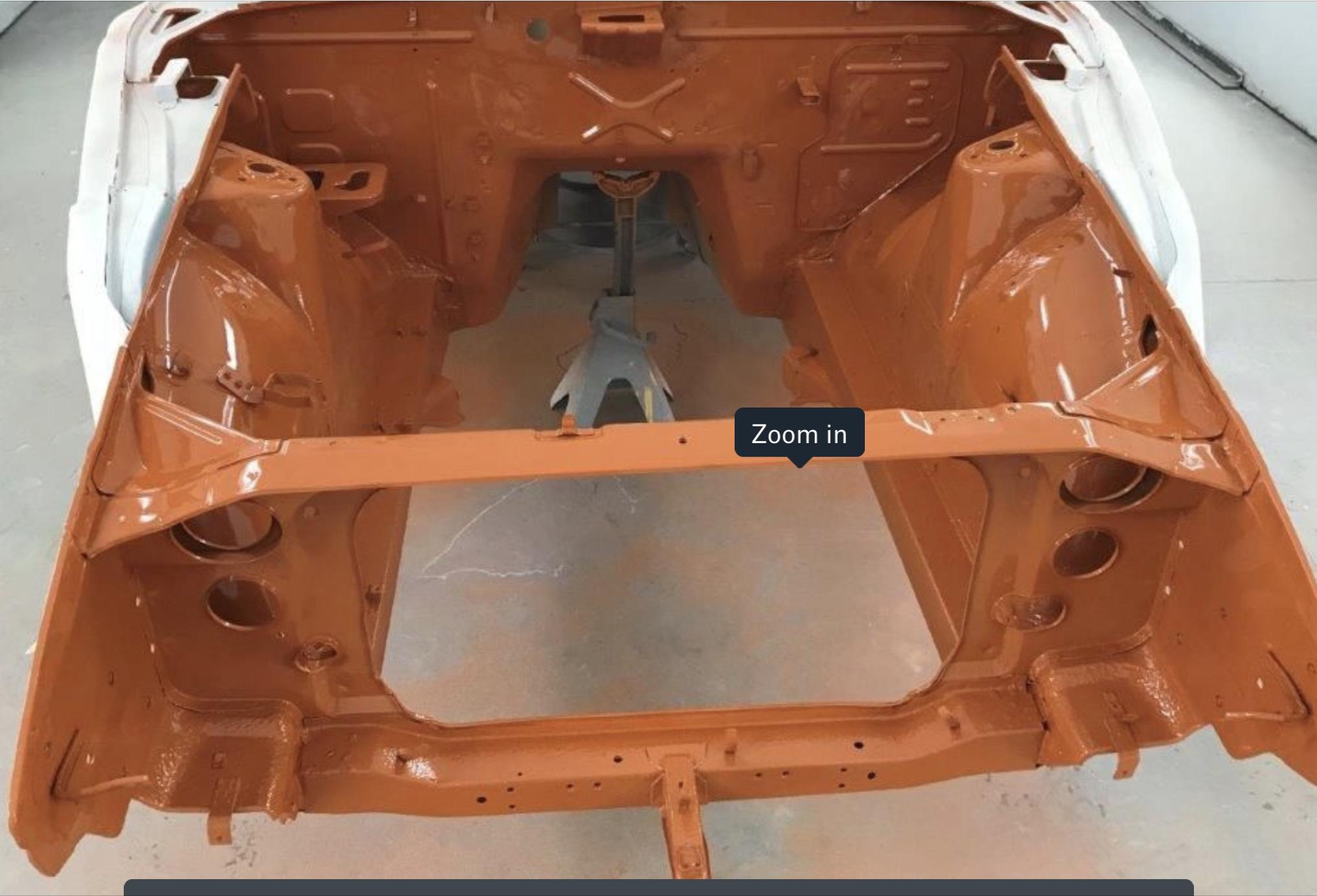

here is an engine bay picture that has the best example of what my mind/eyes see.
Peachy, right?  Bleaccchhhh!

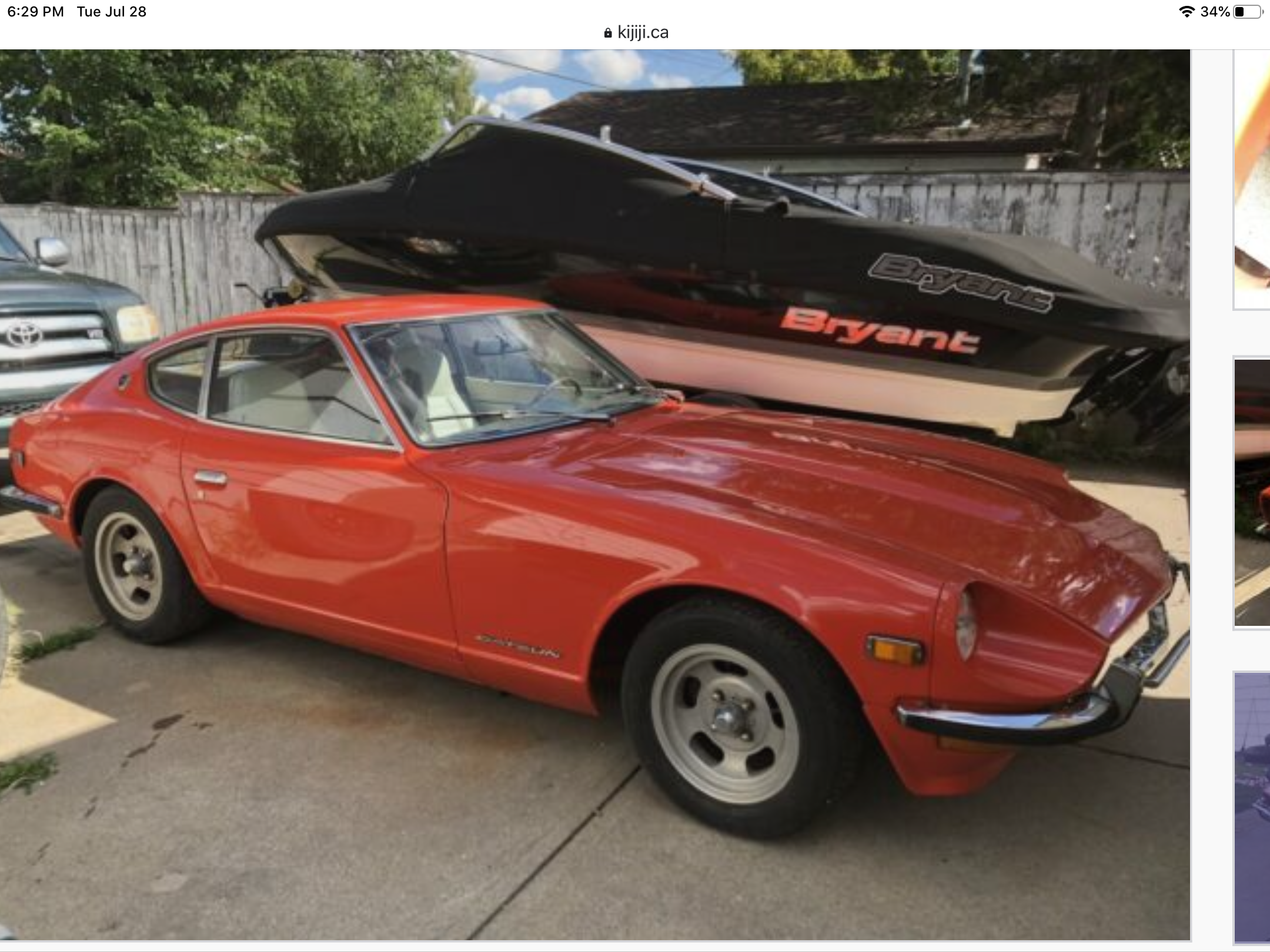

I only have one other real original paint 918 orange on a 1973 in town and that thing is ORANGE. Nothing peachy about it. There is also another one, a 72 for sale on-line locally, with 918. The pictures look exactly Like the 73 I know, and it is ORANGE. Here is a screen grab from kijiji.ca
