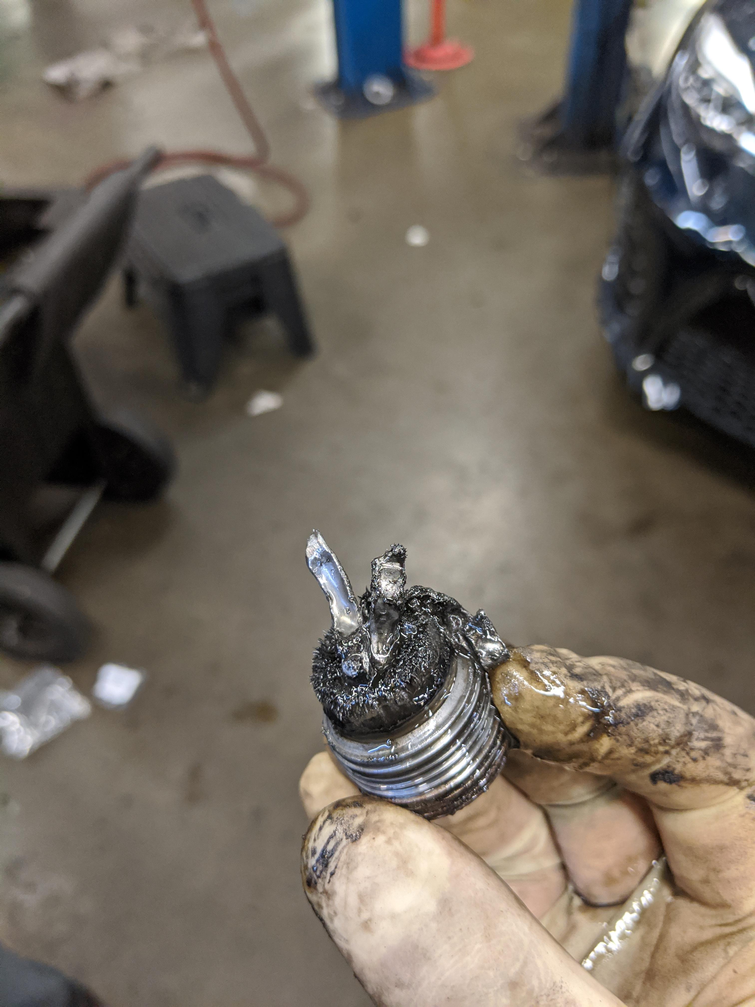

Okay so my 1978 280z has a 5 speed transmission (not sure what year), has always made noise in 1st and 2nd gear when not pressing on the throttle (kinda soundings a little like a grinding and maybe whining noise). When the clutch is pressed in, no noise, if I am on throttle, no noise. Only makes noise 1st and 2nd gear when coasting (no throttle applied) and you can kinda feel it not coasting smoothly but once again only in these two gears. Based on the symptoms and pictures I provided, are my bearings or synchros bad? Asking before I pull trans for rebuild with the rebuild kit from zcardepot or if I should just buy a new trans since I am unsure if a rebuild will solve this issue
That is a piece of bearing cage on the drain plug magnet. Most probably from the counter shaft (sometimes called cluster shaft) bearing in the adapter plate.

Thank you, had a feeling it was a bearing, do you know if the kit from zcardepot comes with this specific bearing? I am okay with doing a trans rebuild and testing my luck before purchasing a new 5 speed, mainly because I will not able to do the rebuild at home.

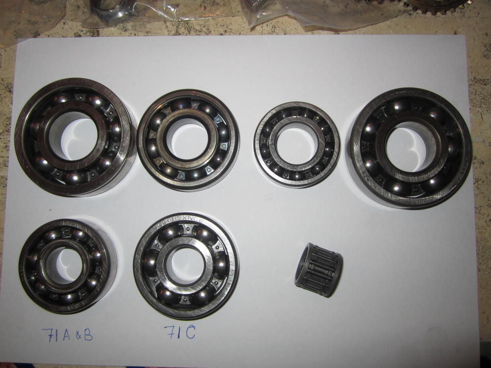

The standard kits with have the two bearing in the adapter plate. Those two bearings are generally the ones that give most of the problem.
Note: Some kits comes with a larger front counter shaft bearing for the 71C transmission. All the synchos and bearings, with exception of the front counter shaft bearing are the same for the 71B and 300ZX, 200SX 71C transmissions.
