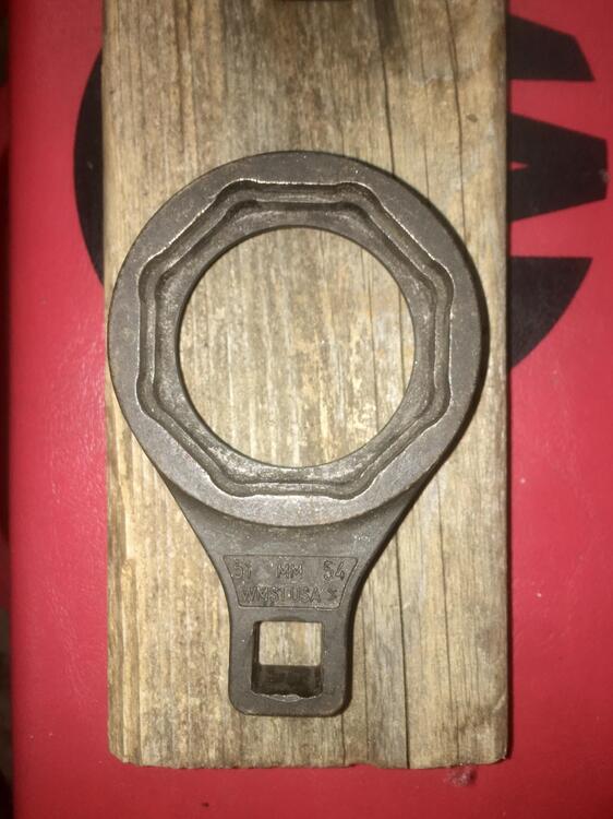

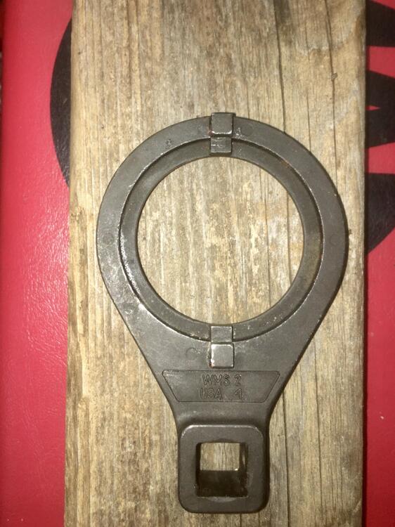

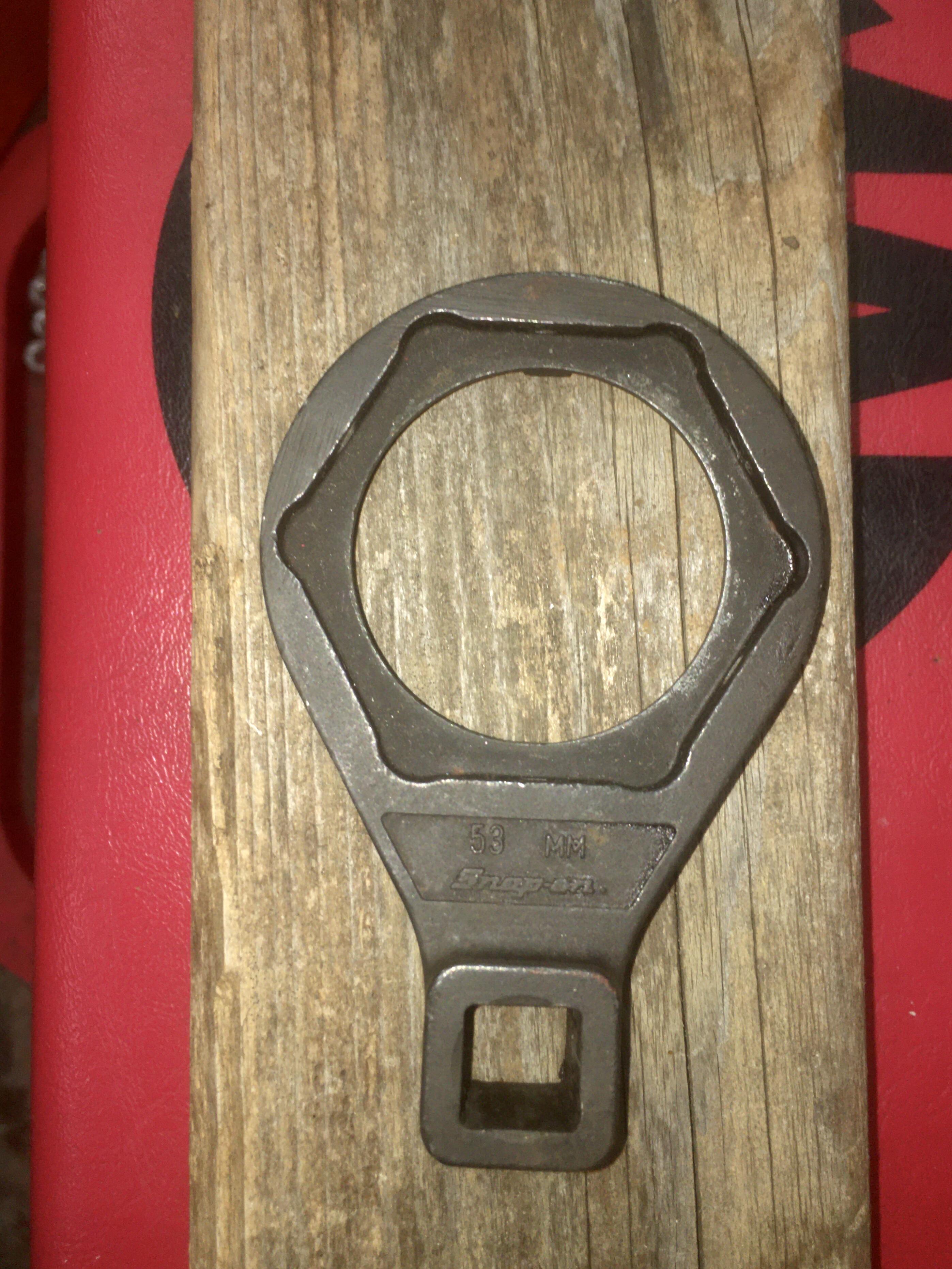

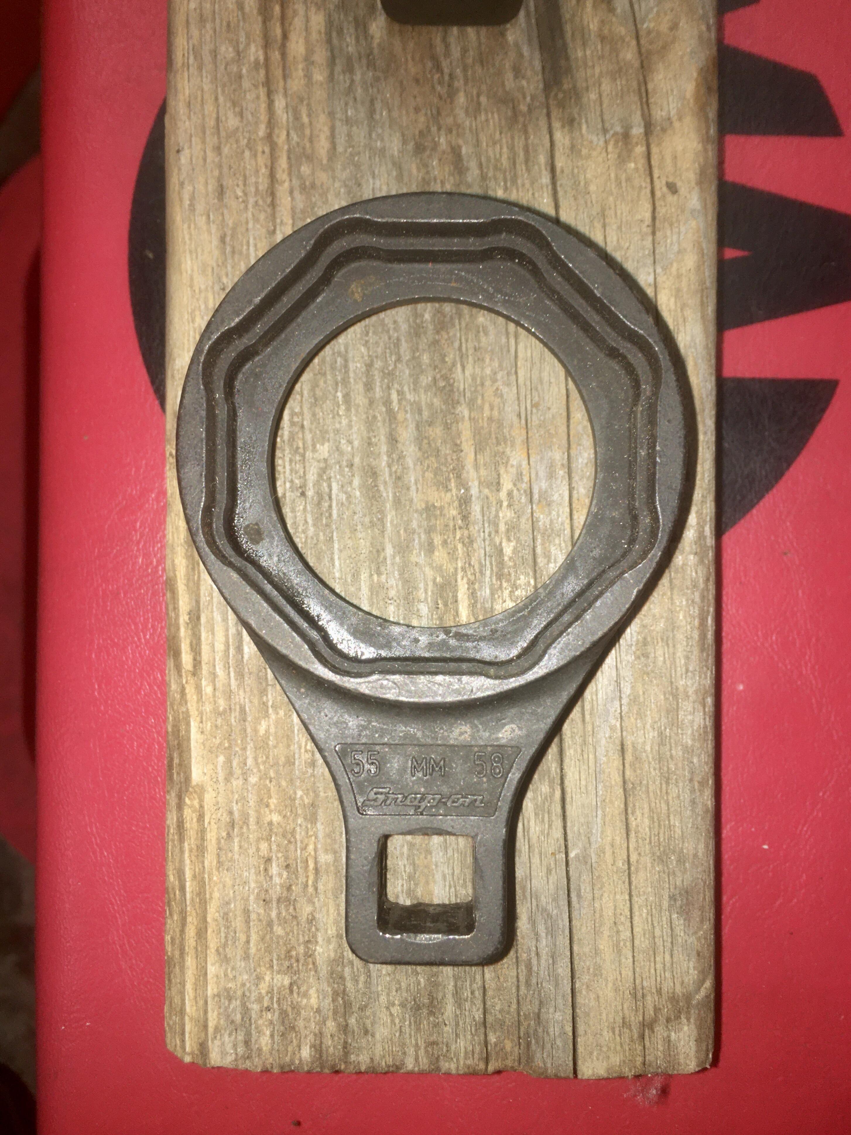

Snap On makes two gland nut wrenches, WMS1, and WMS2.
WMS1 has four sizes, 51, and 54 mm on one side, 55, and 58 mm on the other.
WMS2 has 53 mm on one side, and two sizes for slotted gland nuts like one finds on hydraulic jacks.
Pictures below.

Thanks Racer X. I bought a wrench head previously that fit the stock nut but the one furnished with the yellow koni is circular. I've included photo of the tool I found recently. Good to know about the snap-on wrenches. I also read somewhere that the oil helps dissipate heat. . .  Best, AndyIMG_1391.heic
