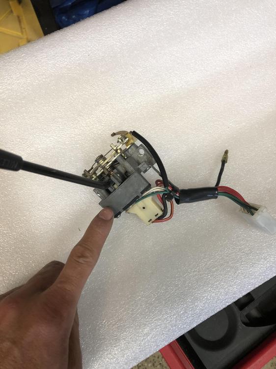

Hi all,
The micro switch on the steering column on the signal side? Is it the one where my finger point to it or the plastic where 3 wires coming in/out? And the fusible link for the ignition at the positive terminal?
 Please see the attach photos

i will cleanup the micro switch later
