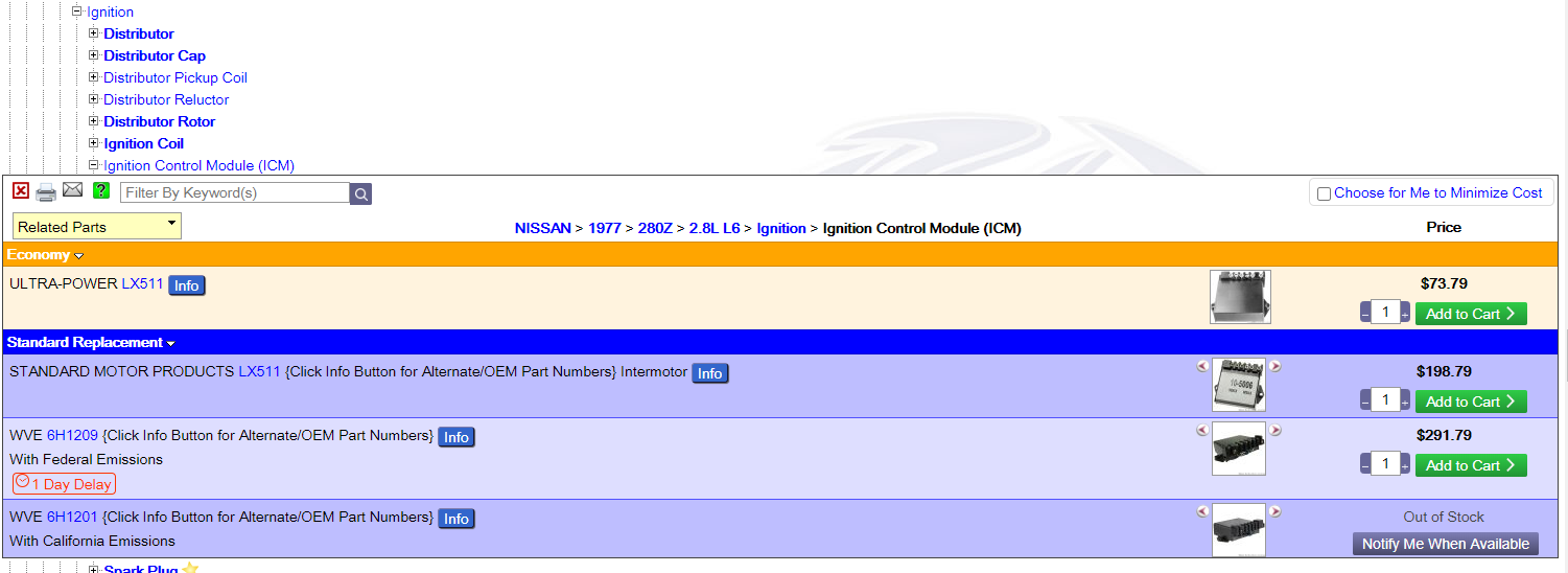

By the way, Rockauto does have a replacement for the transistor ignition unit. Just look for ICM when you drill down on their site.
I cannot vouch for the quality of any of the parts listed.
Many people have gone with the HEI because it is relatively economical.
