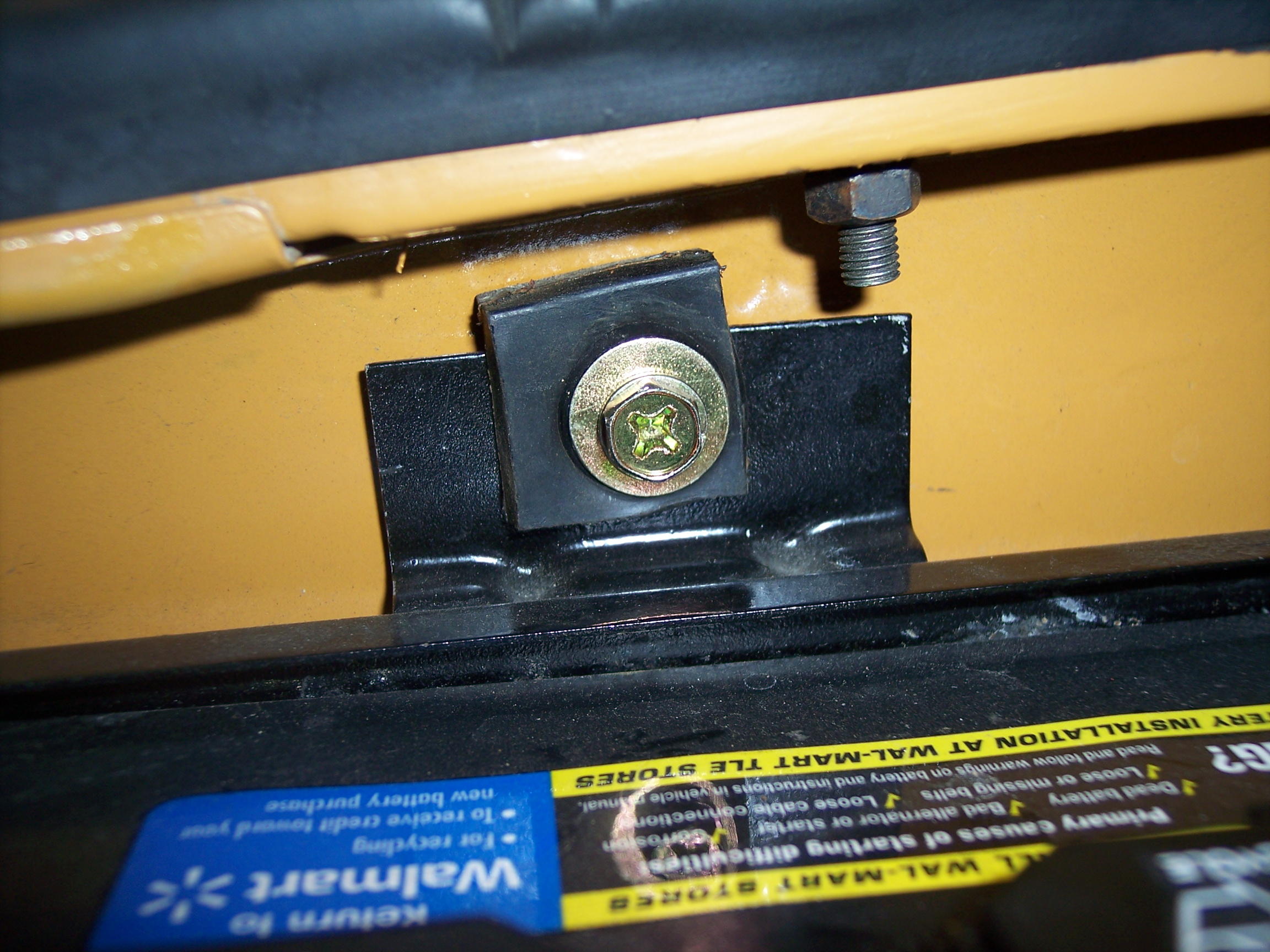

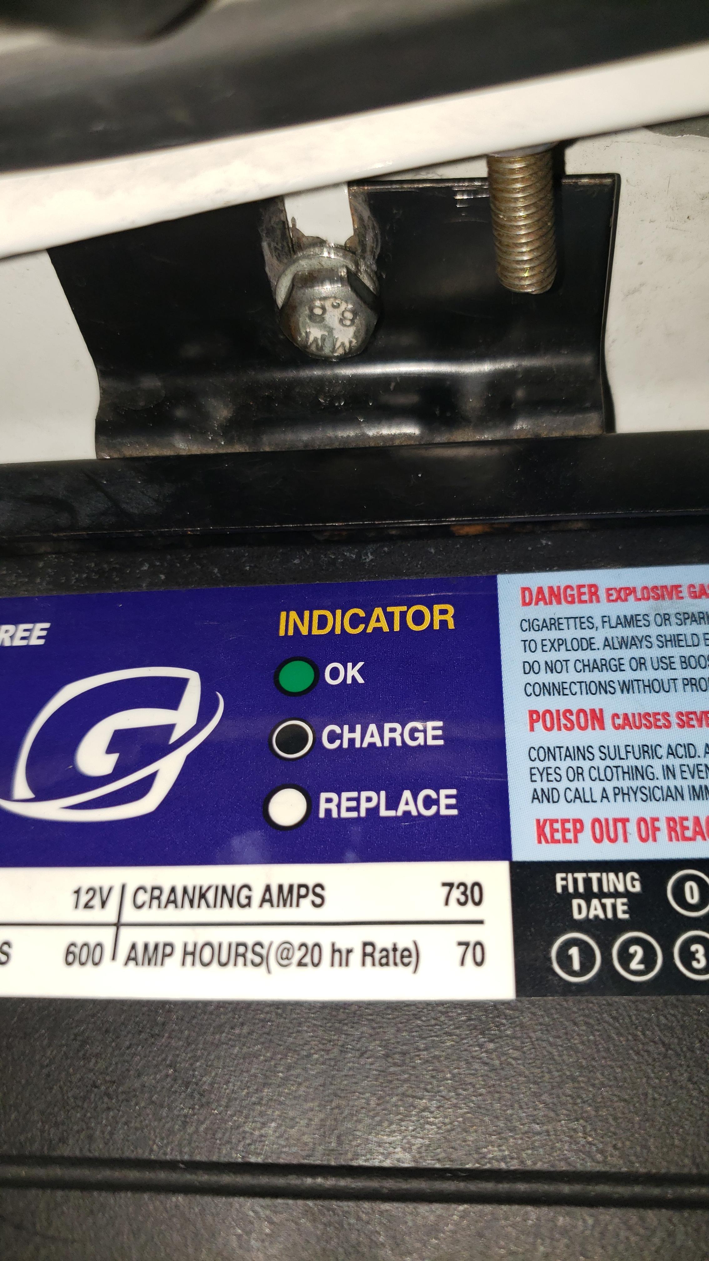

If it is  not tightening, it is possible the threads are stripped either on the bolt or the captive nut welded to the back of the firewall. Or... possibly you have an undersize bolt. The one in your pic is not OE, it should look like this one. Also, the bracket tab usually has a rubber insulator.
