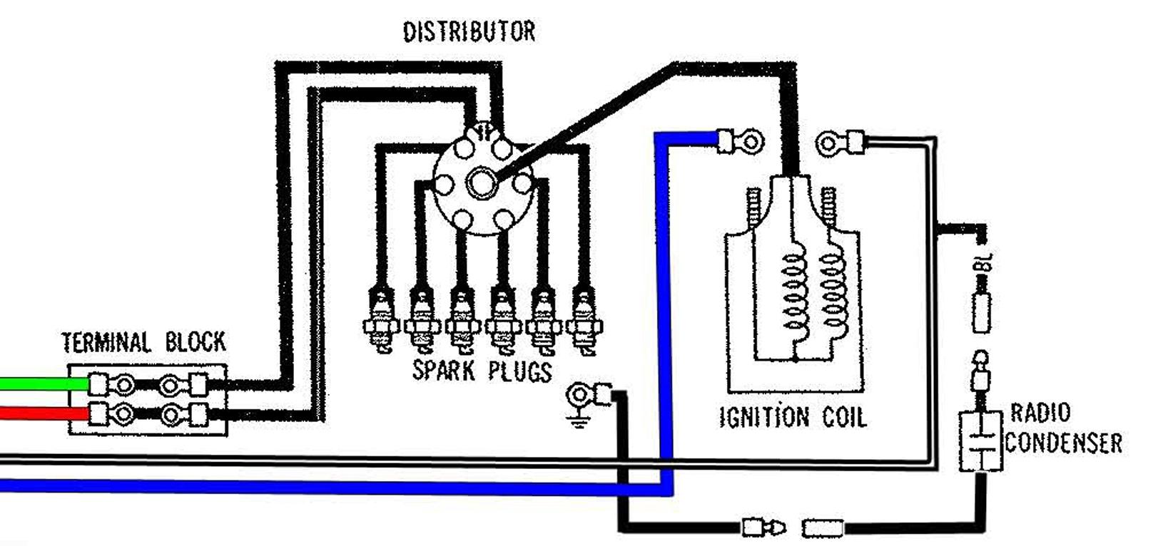

The condensor on the californian 77 280Z is funny dubble ended condenser. One end goes to the midle spade terminal on the ballast and the other goes to the distributor.
The spade wire goes to a bullet connector to the condenser. Can you trace the two spade wires on the ballast and see where they go?
The color 1977 wiring diagram (not original nissan diagram) doesn't show it clearly, but the 1978 does. Note the 78 doesn't use a ballast because they switched to a 12v coil. The condensor wire splices into the coil positive wire.

I looked at the FSM, it doesn't help much with this particular issue - just the pic similar to what EuroDat posted above.
But, having or not having that condenser wired has nothing to do with engine running, speedometer working, It's job is to cut electrical noise that may be picked up by the radio for the most part.

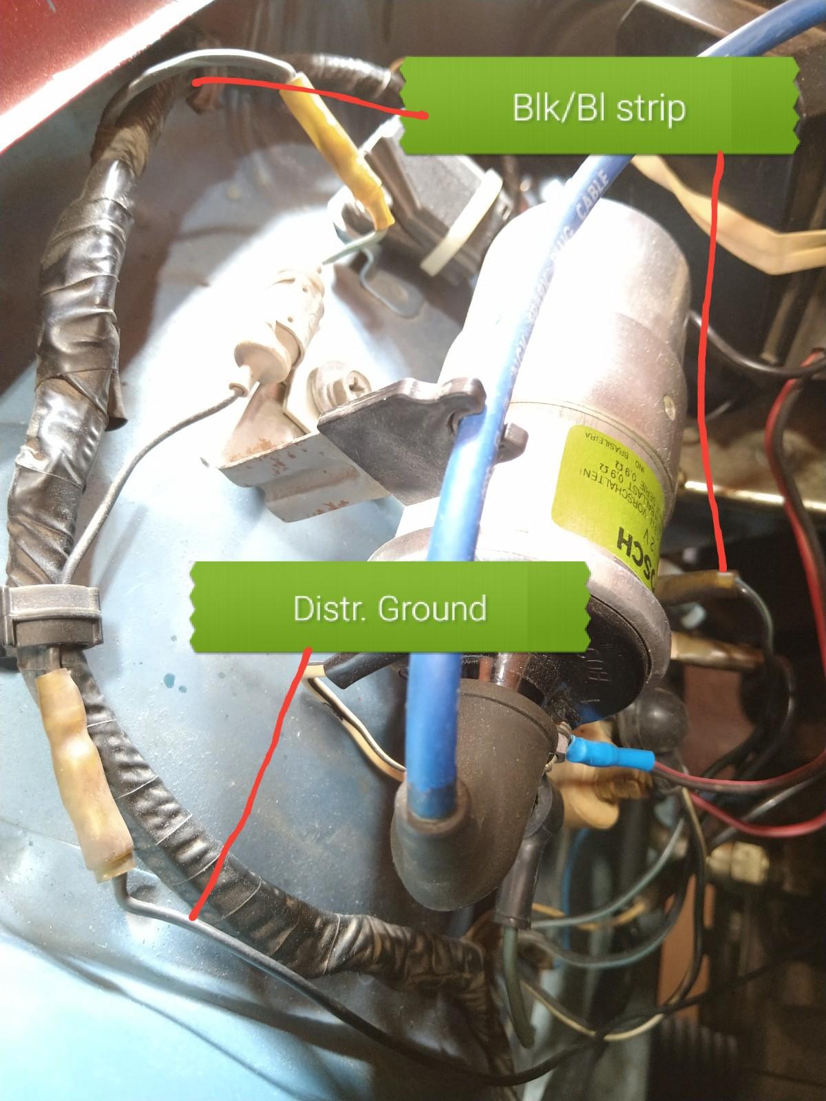

The front bullect connector conects to a Black/Blue strip wird in the harness. It goes to the ballast spade connector in the middle of the ballast risistor. One of the wires with a spade terminal in the middle section of your ballast resistor should be Black with a blue strip. It goes into the harness going to the front of the car and comes back out somewhere between the coil and AFM with a bullet connector.
The other end of the condensor connects to a black wire that goes to the M6 bolt on the distributor mount.

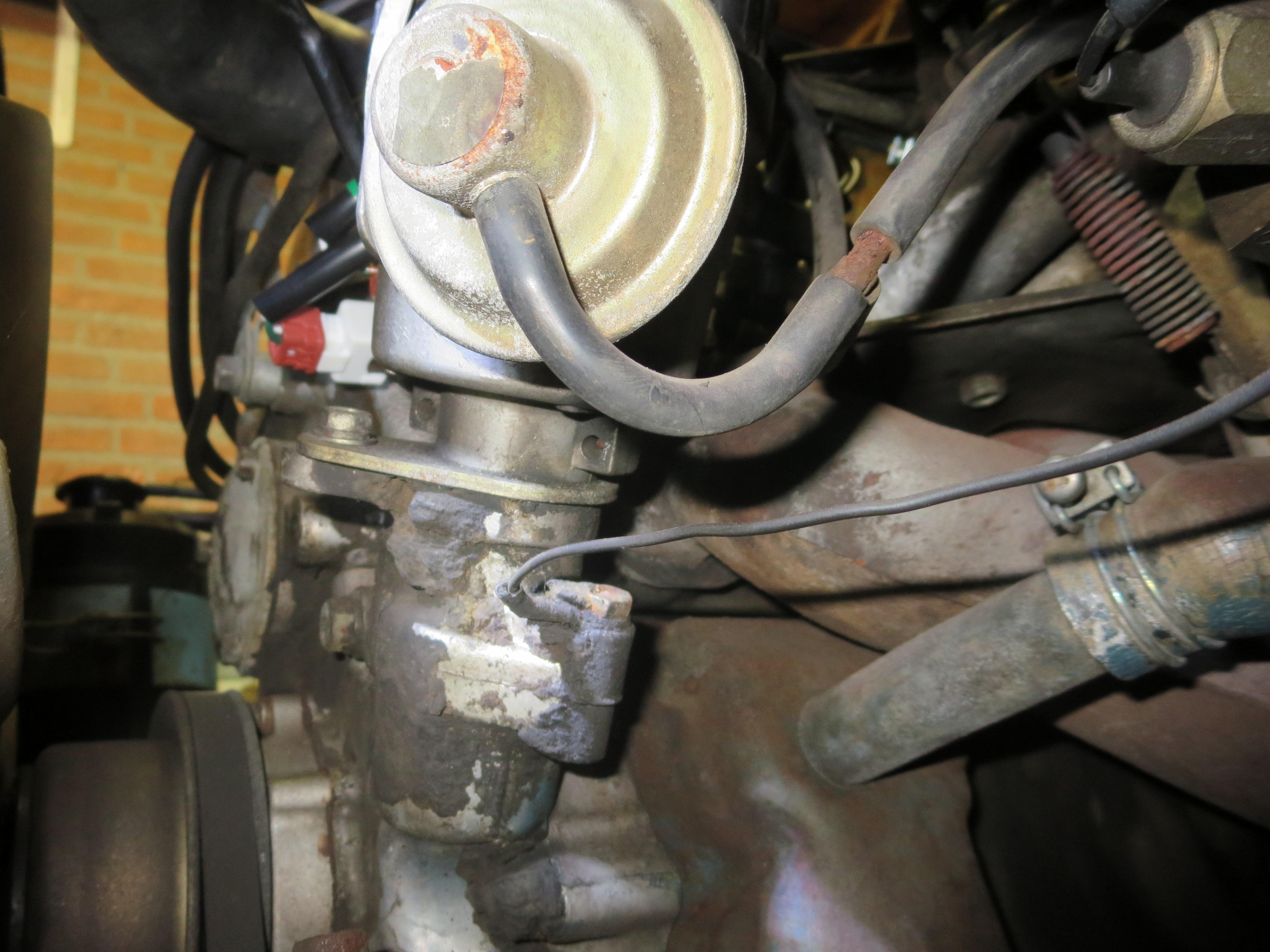

Better photo ofdistributor

- connect the offend condenser wire to distributor body
