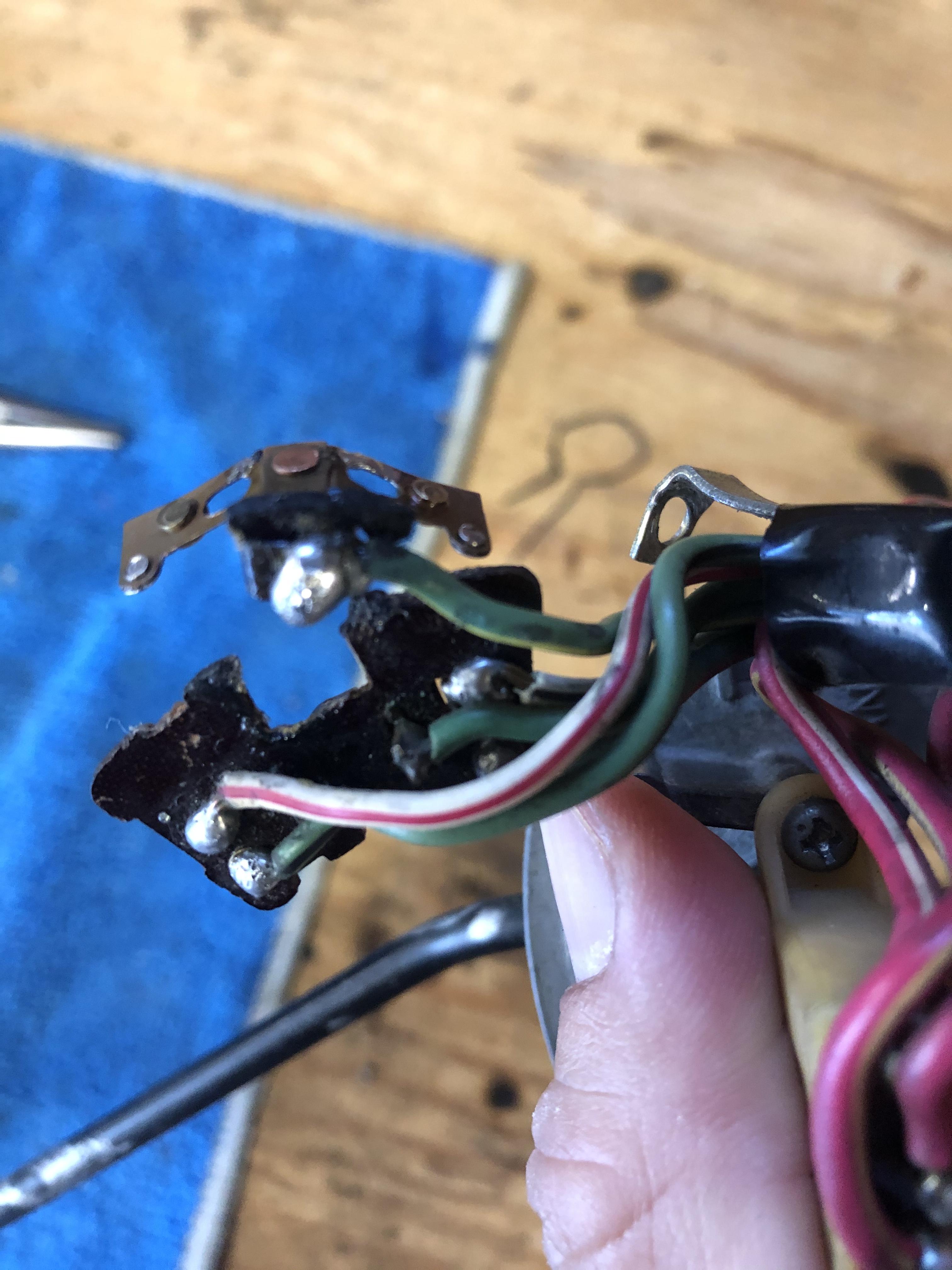

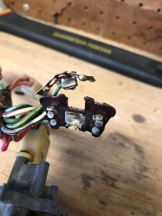

Hello,
so I was cleaning my turn signal switch and happen to break the circuit board as I was trying to pry it open to clean the contacts.
is there any way I can repair this? Any type of conductive adhesive I can apply? What type of services could be able to restore this piece?  I would gladly buy this piece as well if anyone is selling it!
I have attached a few photos here as well.  Thanks!

You might be able to glue a stiff backing material on to it to get the pieces together and aligned then repaint the circuits using conductive paint.  Looks like a tough project though.
https://www.amazon.com/Silver-Conductive-Adhesive-Electronics-Circuit/dp/B086VMYK4Z
https://circuitscribe.com/products/10g-brush-screenprinting-conductive-silver-ink-beta
You can repair that with Plastic Welder Epoxy and it will be stronger than f@#$.
Just make sure that each of the 3 sides is epoxied in place and the 2 pieces of the circuit board are lined up.
It might help to unsolder the brake wire from the broken piece first.
Remove any excess cured epoxy with a Dremel or the like, and reassemble carefully.
P.S. JB Weld Plastic Epoxy is okay but I prefer Plastic Welder.
Good luck!
