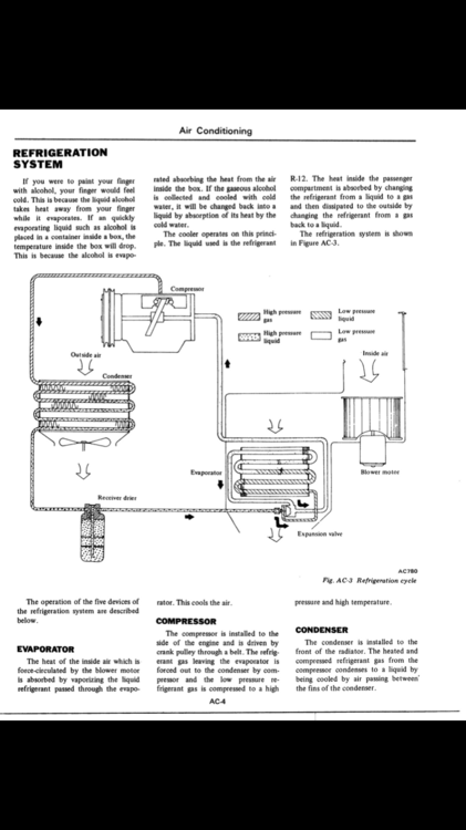

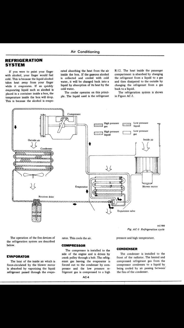

I’m an idiot.  Can you please hand hold me and tell me exactly which one is the low pressure and which one is high pressure valves? I cannot correlate the picture with the  actual setup in the car.
1.  is the valve from the compressor to the cabin/firewall is the low pressure and the other is high pressure?
2. I bought the fitting and it already has the needles in it.  When I open the caps from the compressor, there is also needle already in them.  Should I remove the needles already in the valves currently on the compressor?
i want to pull the vacuum to see if there is any leak without starting the car.
regards
