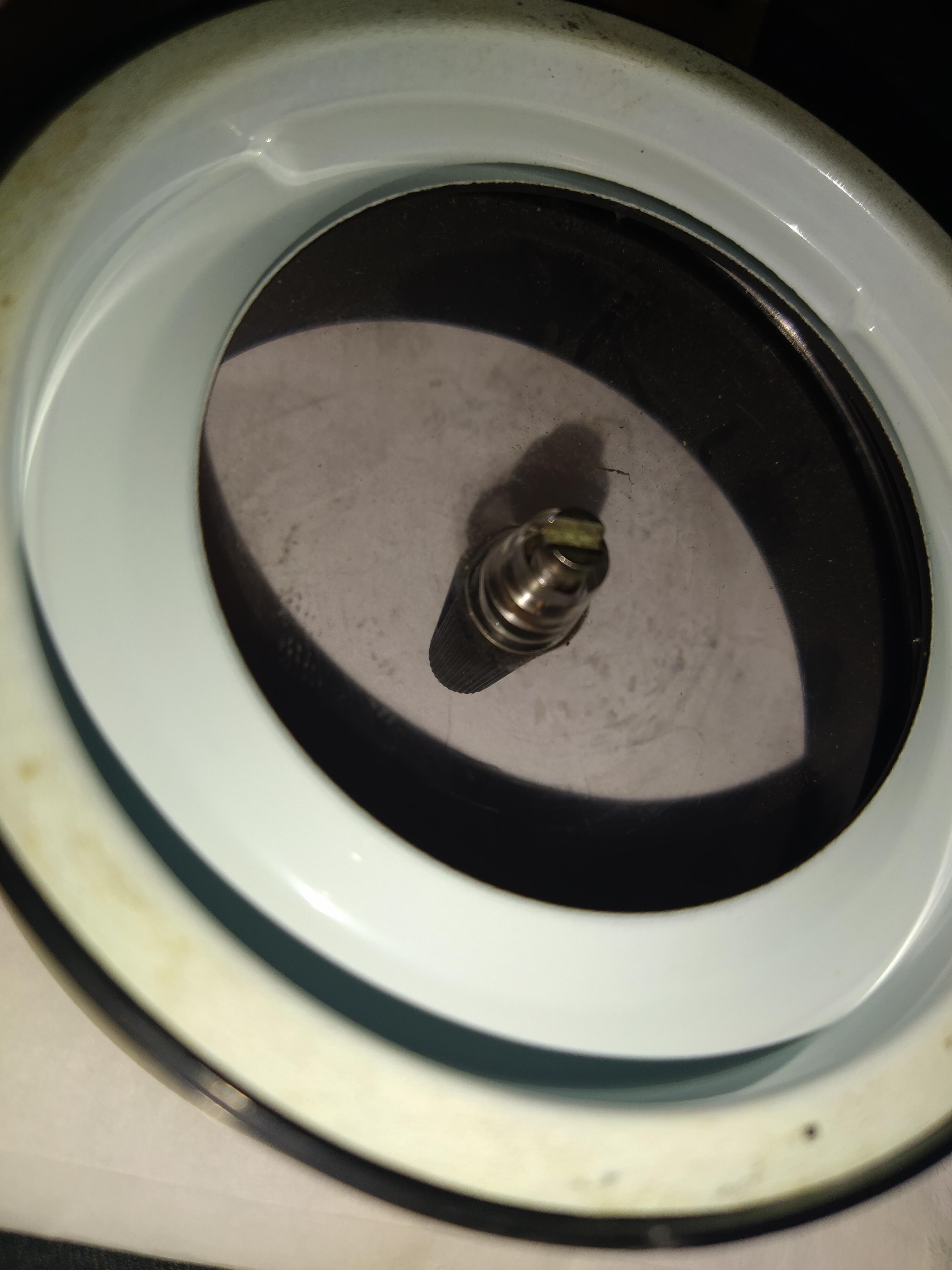

If you've tried holding the plastic "knob" in the front while using a flat blade screwdriver at the back and it didn't unscrew, then I'd assume the knob is pressed on the shaft like many other knobs on a steel shaft. Since it's a thing that's meant to be turned, I'd think it was the latter - a knurled shaft with the knob pressed on. Since it has a spring behind it, the fit would have to be very tight.
It has a few disparate parts, so there had to be an assembly procedure. Now, whether it was meant to be disassembled is another matter... I have a few at the shop but I've never tried to take that particular assembly apart.
