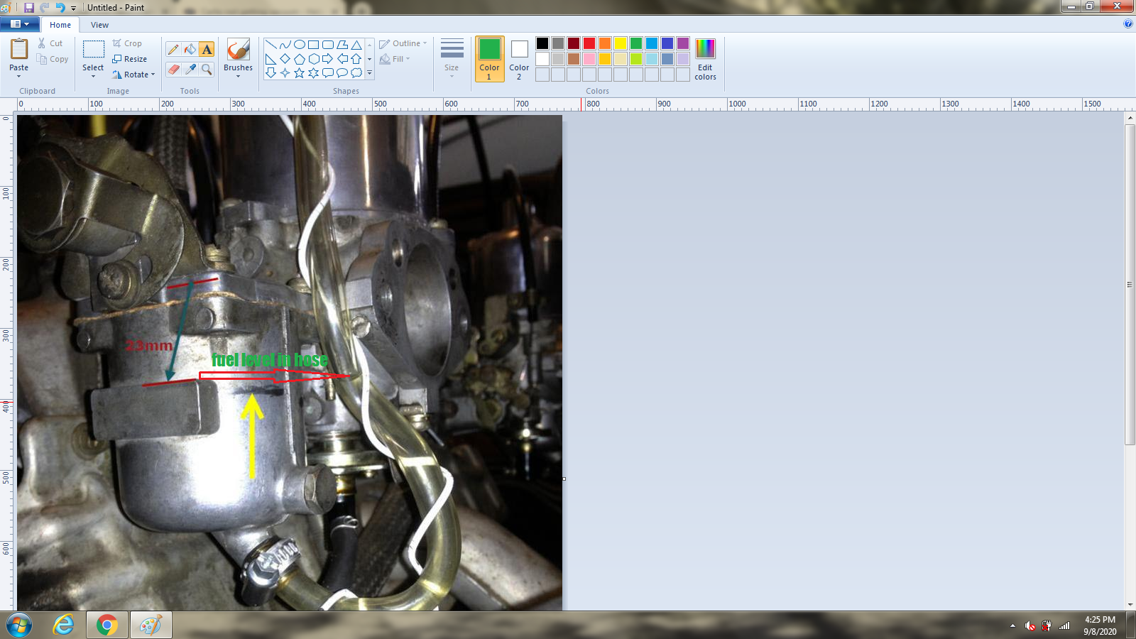

 The carbs have no elec. wires. I'd pull the float covers and take a look inside and take a measurement from the bowl top edge to the fuel level. If you've verified you have spark at the plugs, try spraying some starting fluid (ether) into the carbs and see if the engine starts and runs for a few seconds.
Search using the word "floats" and you'll find pics and discussion. You'll be looking for the depth of fuel in the float bowl. Measure form the top edge of the bowl down to the fuel level. Pics would be great. Also, while holding the cap and float assembly , with the floats hanging down, blow into the inlet tube. You should be able to blow air through it. Now slowly lift the float while blowing into the tube. When the float is lifted to about 9/16" from the bottom of the float cover, you shouldn't be able to blow through it.

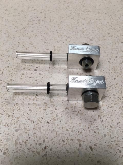

siteunseen's approach is a good way to more precisely check float levels. I manufacture and sell Float-Sync on eBay (pictured below) and have received excellent feedback, if you are interested.
Float-Sync is the best way to calibrate float levels between two Datsun 240Z SU carburetors because you'll actually be able to see the fuel level in each bowl, even with the car running. The level of fuel in the float bowls is the first step you should take before making other fine adjustments to optimize “runability,” In my experience Float-Sync gets you to the baseline as quickly and accurately as possible.
I learned, like most of us, to set float levels by removing the float bowl cover and measure the distance between the edge of the lid and the top of the float while the cover is inverted. What I've since learned is just how imprecise this approach is because many variables. Those variables include whether the carbs are being run with or without float bowl gaskets, how many turns down the jet nozzles are set, if the float valve is fully opening and closing, if the float bowl lid has short or long ears and if floats are intact and their buoyancy is the same in each float bowl. I'm sure there are a number of others.
