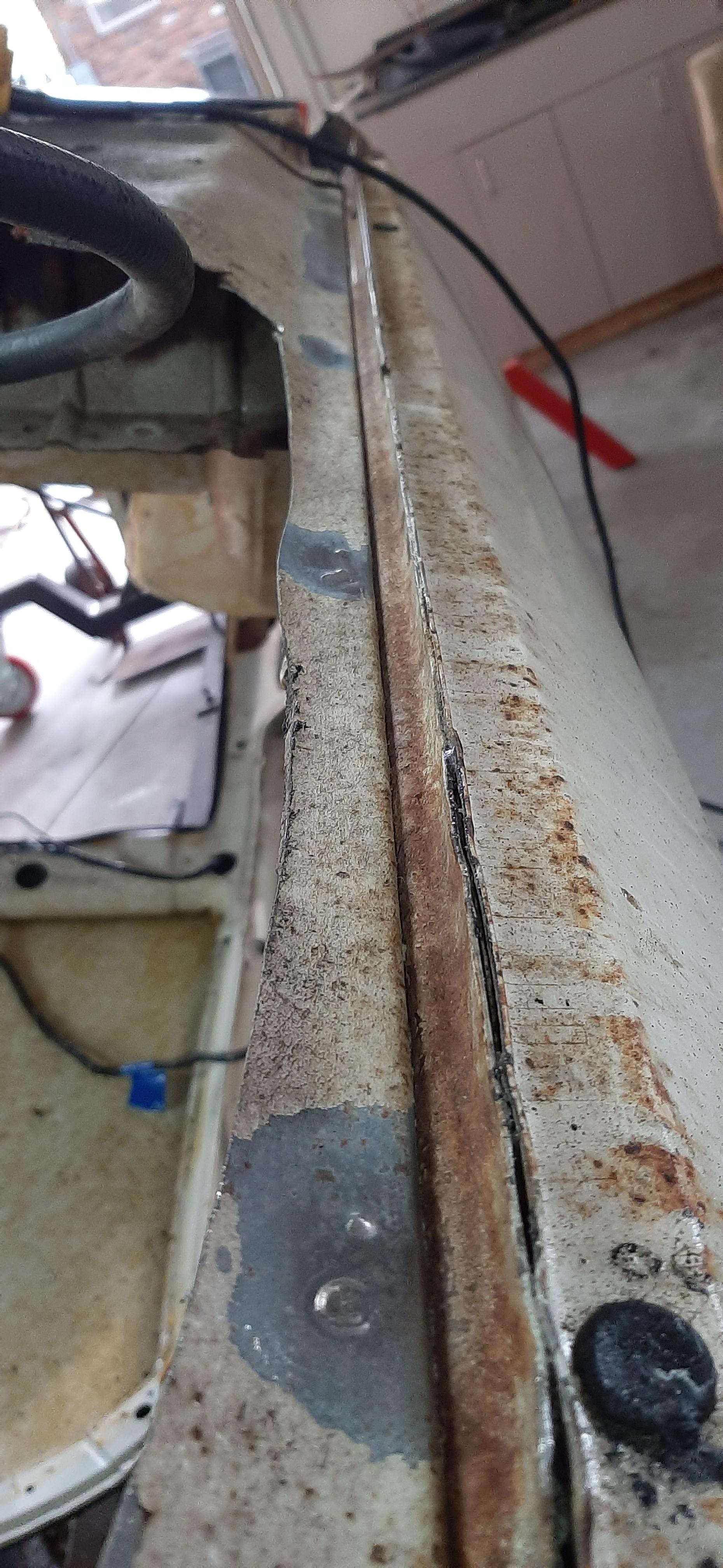

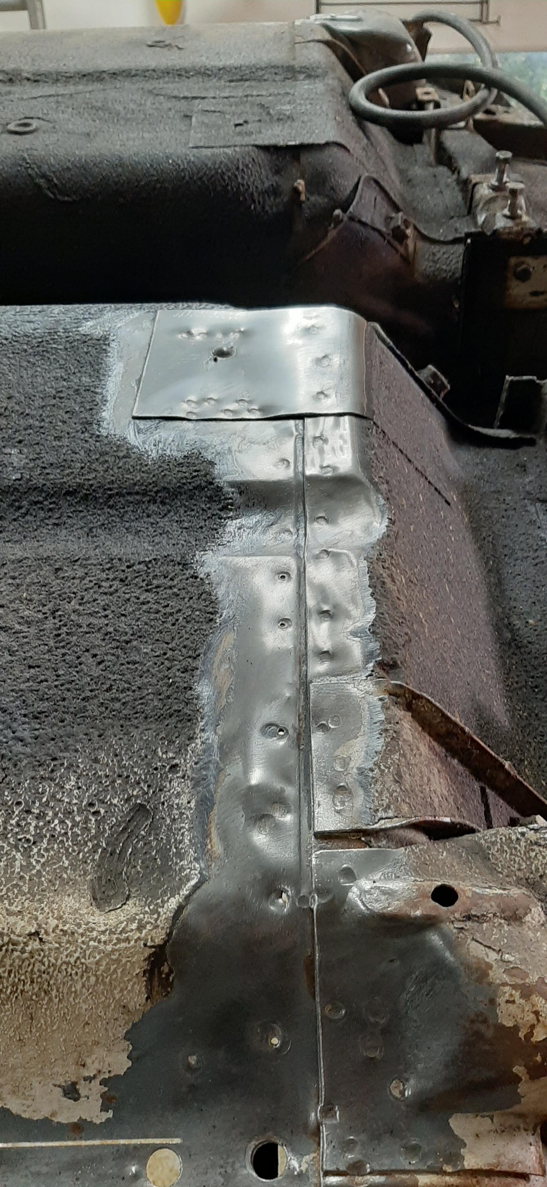

Are these welds happy? I'm getting penetration, but sometimes it doesnt want to fill in the seem, meaning the spot weld builds up right up to the edge of the seem and it takes 2 or 3 times to get it to jump the gap.
How about a grinder that fits into the convex curve of the door jamb? Anything has to be better than my angle grinder trying to get in there.

If you have some spare coupons of scrap metal, try adjusting the wire speed to be faster, you might be able to get the weld to be flatter. (too fast and it’s going to blow through)

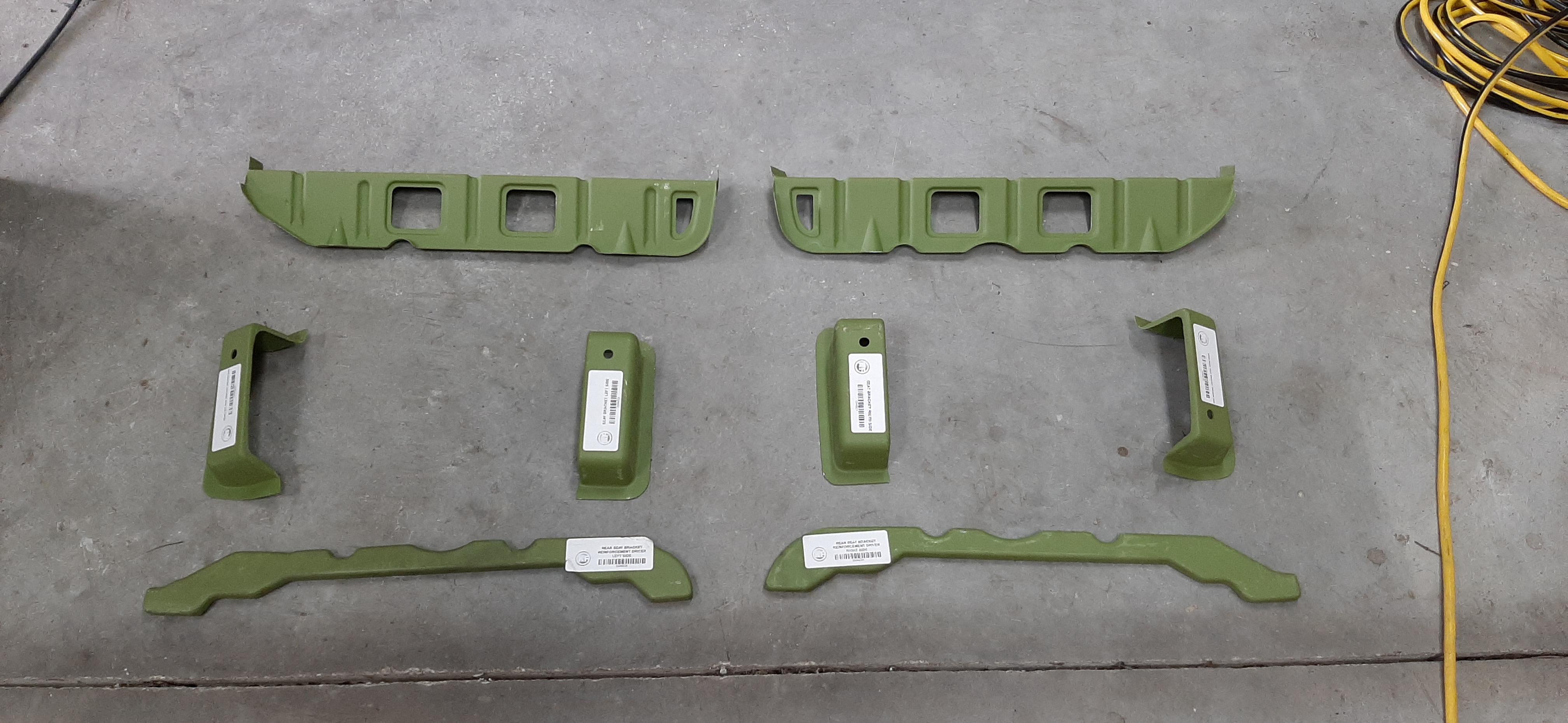

Just a couple small items. Got rid of most the tar board from the tunnel, assessed the seat rail mounts and decided to go with new rail mounts from KlassicFab. I'm going to cut the floors soon, install ZF  floor pans and rails.

Its nice that someone makes the seat rail mounts, I had make the front one, it was pretty complex.

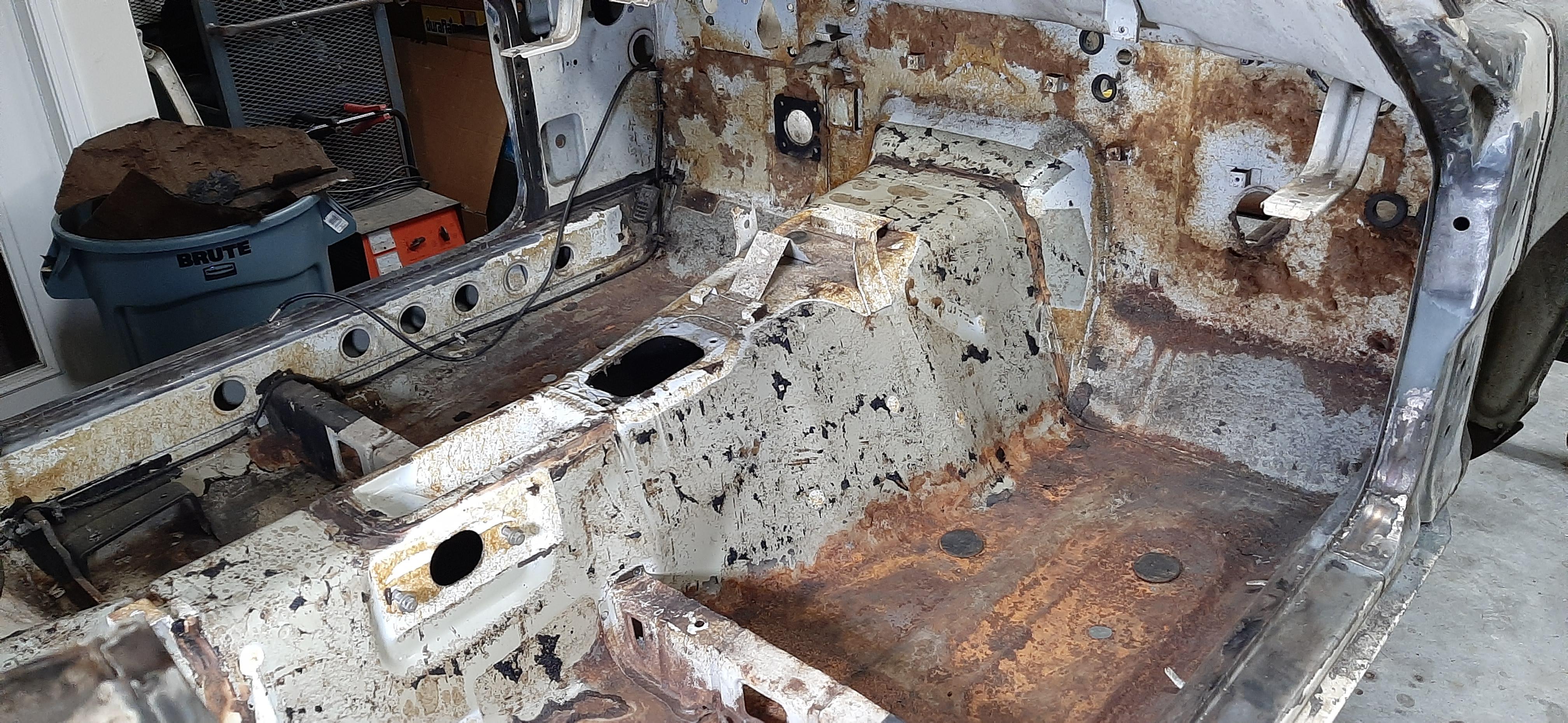

Progress today. Passenger floor removed, still a little left. Also received Klassicfab seat mounts.

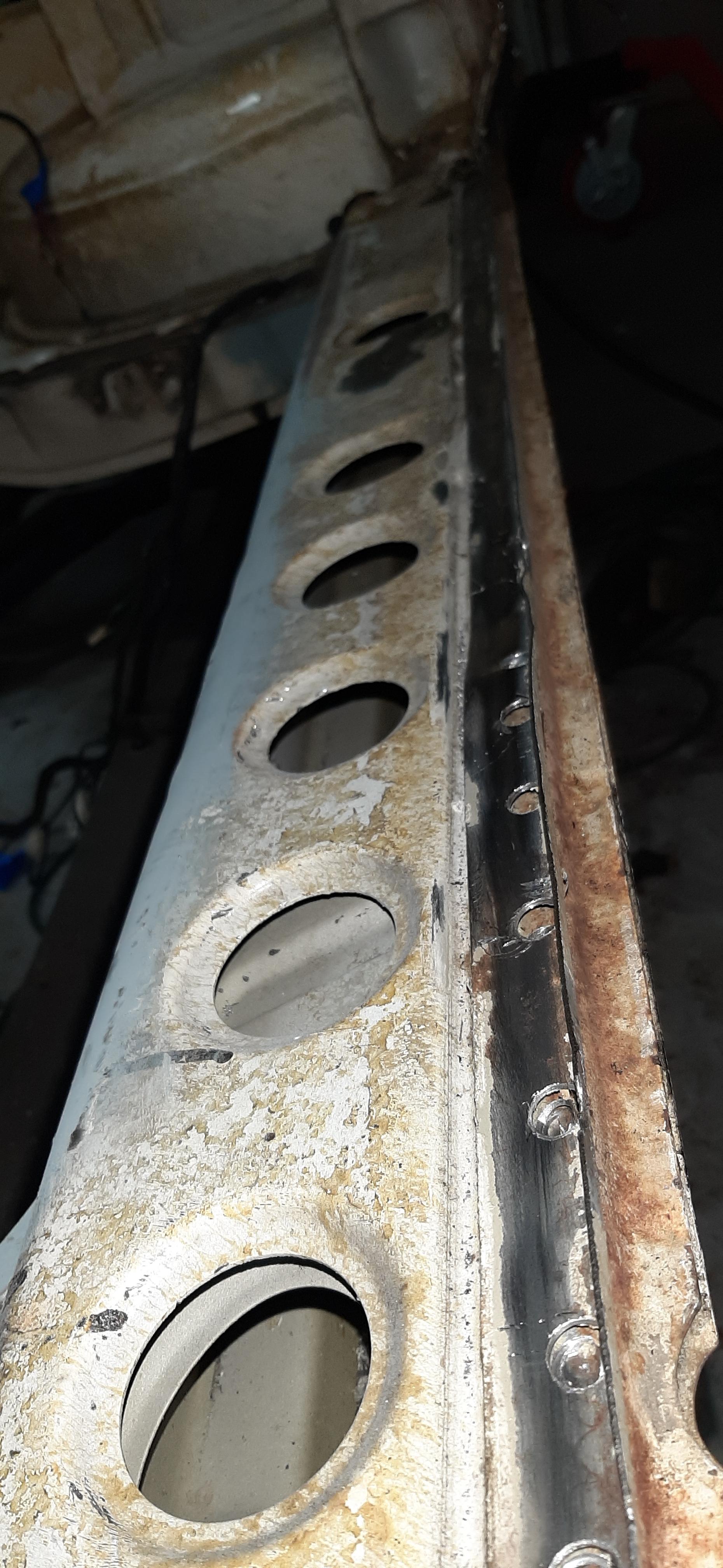

Rear floor where it attaches to the frame before it makes the upturn is really clean. My plan is to use this to plug weld my ZF floors to.

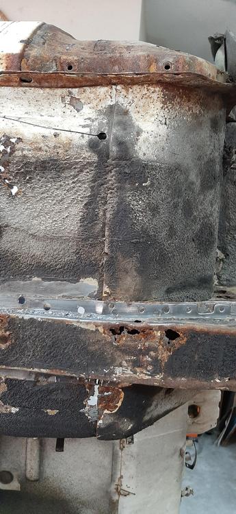

Where pans meet against sills are alsovery clean, so far I'm lucking out. Drill the spot welds and attach new ones. Never done this before, hopefully they go it clean.

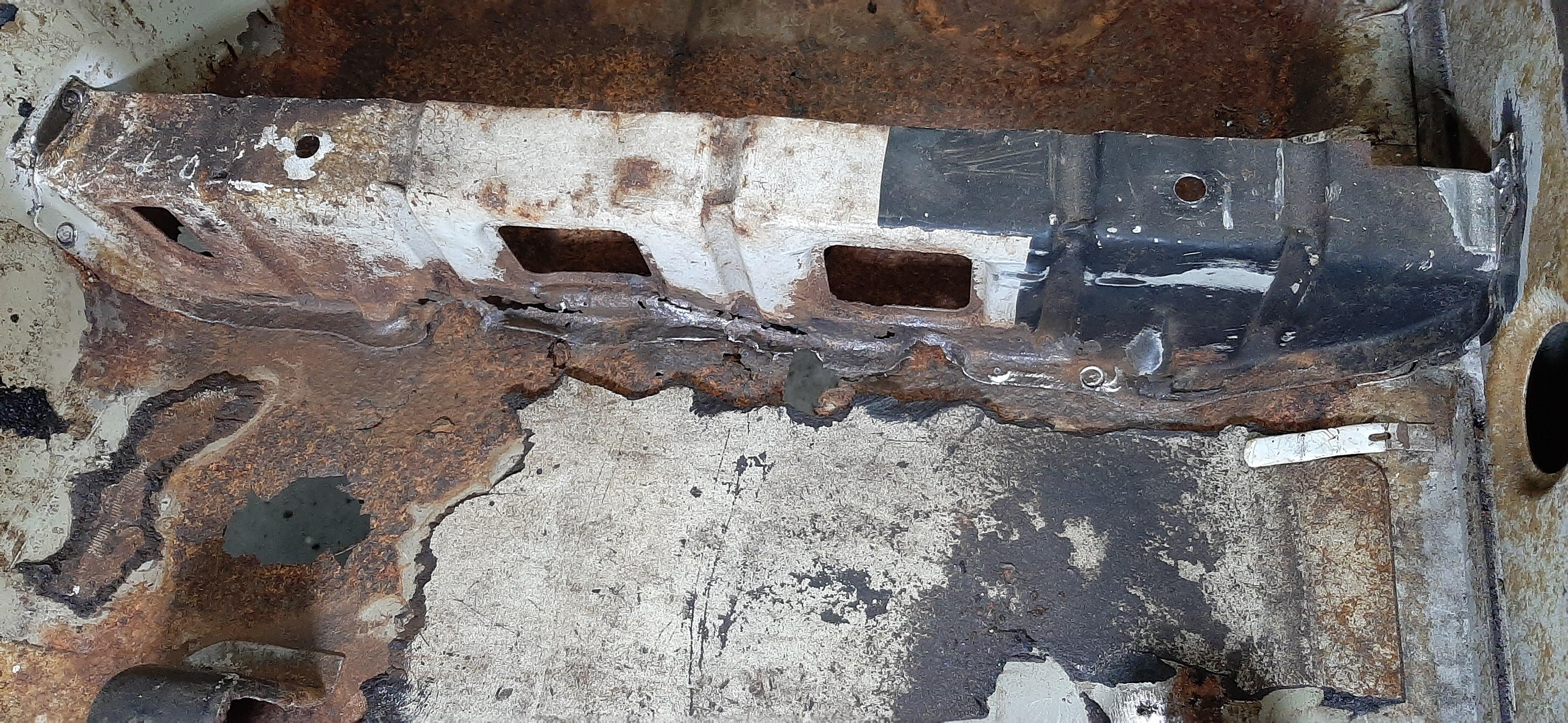

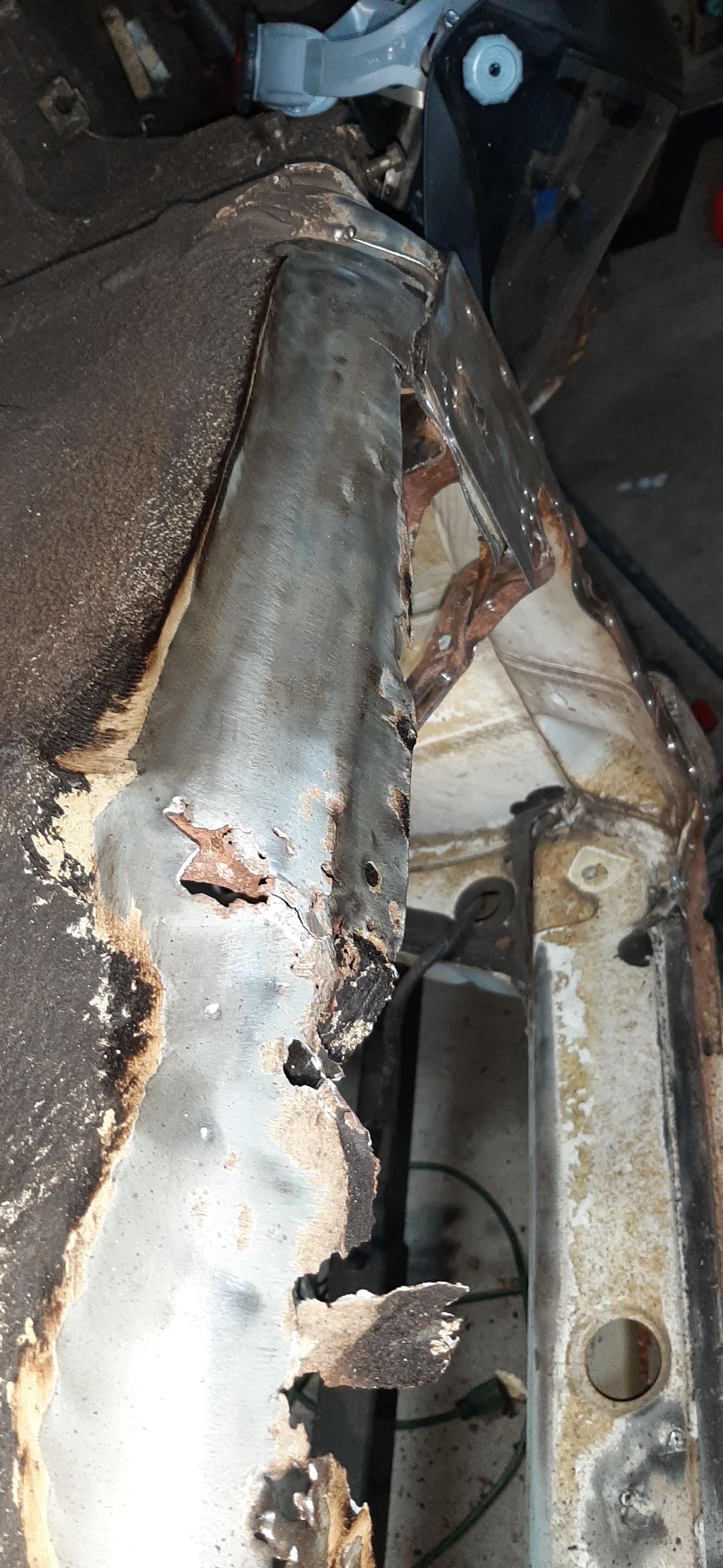

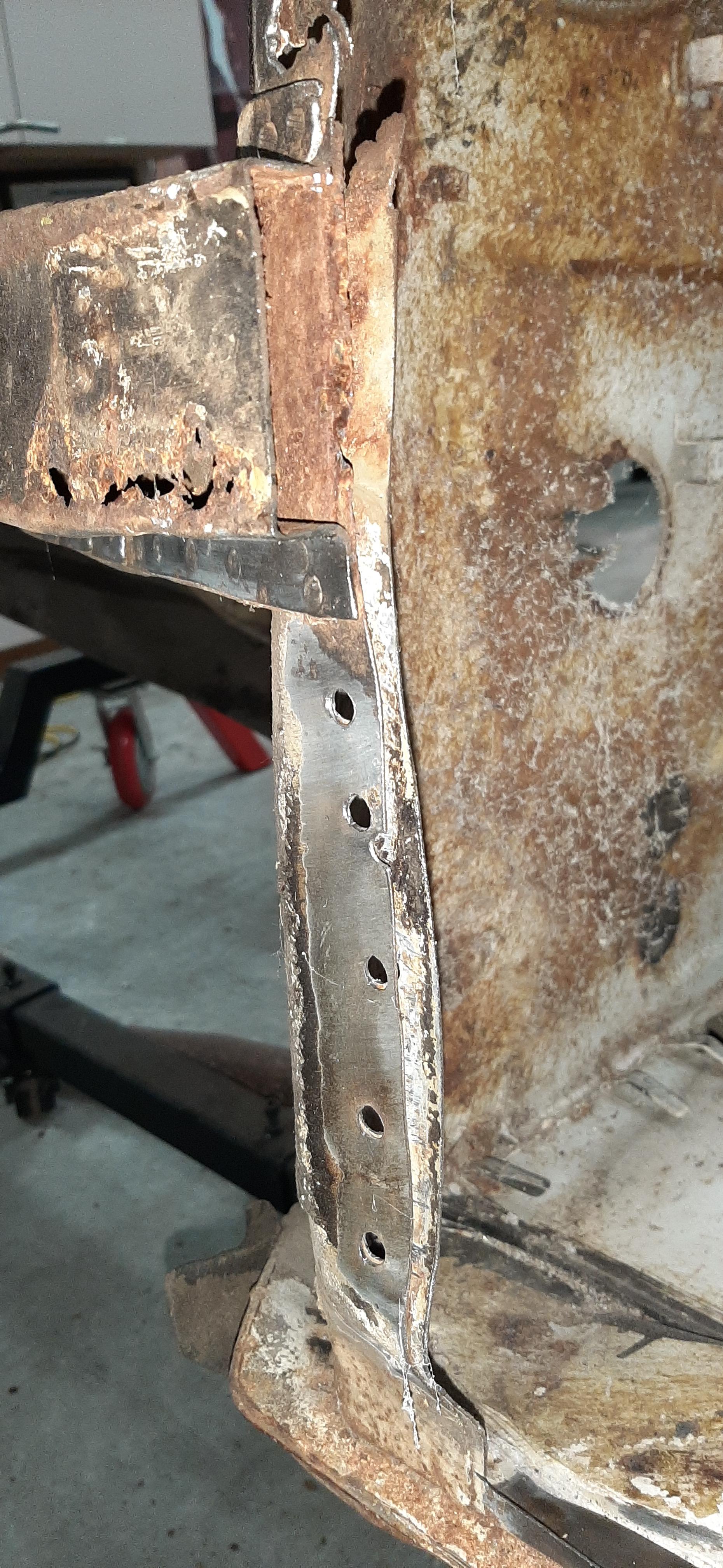

Frame rail just forward of the toe board is swiss chees. I have forward rails I got from Charlie, but do not have the parts that weld up to tension rod mount. A little scratch building perhaps.

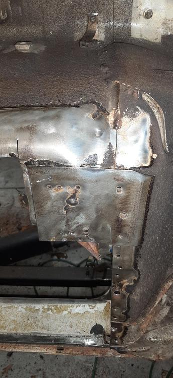

Inboard side on the tunnel is clean except one piece thatr goes up about 2 inches from the upturn. Going to patch that in when the floors are installed.

They are mostly intact as far as I can tell from the outside, but looking in where I cut off the pan rail forward its very crunchy in there when I shine the light. If I just cut and paste sections but miss rust, I'm concerned that the restoration on this magnitude will be in vain if I have to go back in  later on. I'll evaluate when I can get a bigger picture inside the rails.
