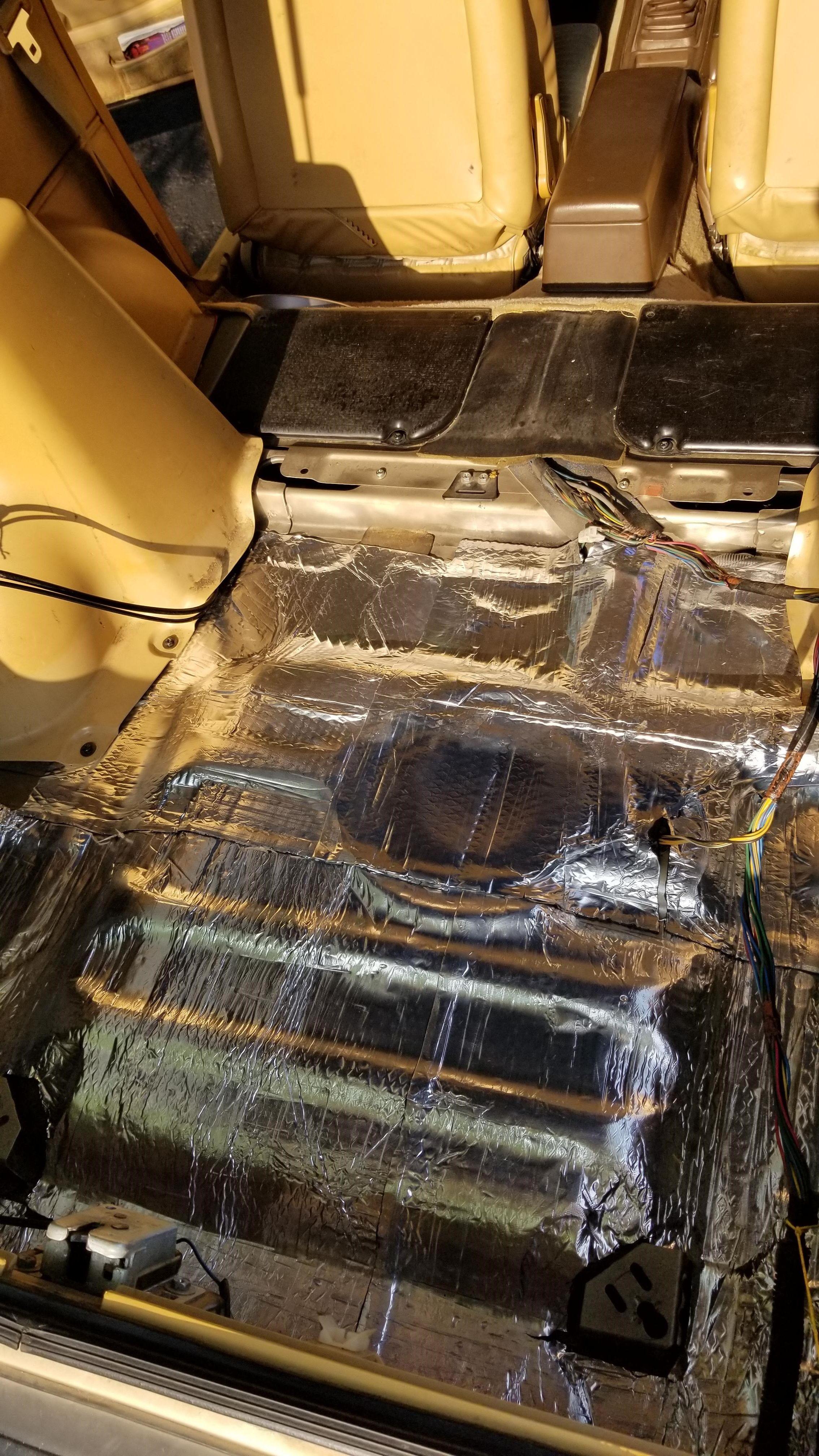

I have the Noico sound mat material installed in the rear end under the hatch, and in the spare tire well which I think was the source of a fair amount of noise.
The next major step will be to pull the seats and  carpet and treat the cabin area.  Doors may be part of that, or  they may be stage 3 treatment.
The hatch area:
