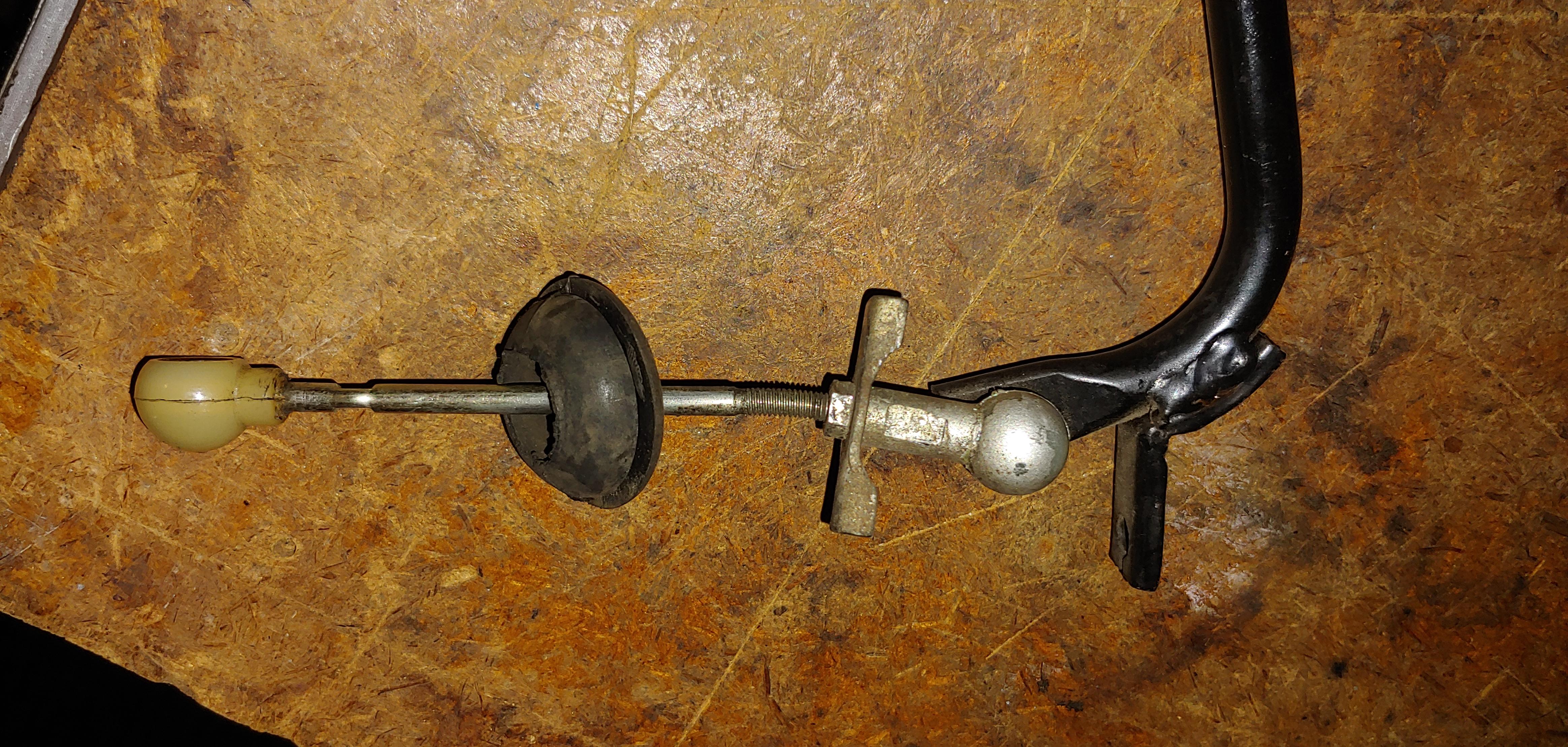

Two questions...1) How do I install this new/replacement accelerator rubber boot onto the linkage without breaking it?  And 2) does the metal "collar" that is on the shaft go inside the boot or outside the boot?
As you can see there is an adjusting nut at the gas pedal end of the shaft, but I've tried to loosen it without success...was afraid if I kept wrenching on it something was going to break...Also, both ends with the "cups" are plastic, and I'm sure quite brittle and unforgiving at this stage in their lives.  It looks like clearly I need to remove one "cup" end to get the boot on because the small end of the rubber boot doesn't look like there is any way for it to stretch over the cups.  Do the "cups" screw off? Or are they simply pressed on?

And the little metal collar?  Here's a pic I took before disassembling everything...in this pic it looks like that metal collar is positioned between the ball joint and the rubber boot...but the shape of the small end of the rubber boot would suggest that the metal collar is supposed to be inside the rubber boot.  Given the age of the car and the possibility that this linkage was previously disassembled sometime in the past, I'm not convinced that the collar's position in the pic is necessarily accurate. Thanks!
No...look at the first picture I posted above.  In the photo you can see the new rubber boot, and just to the left of it you can see a small metal "collar" that slips over the shaft/shank after removing the plastic ball piece.  That is a replacement collar that came with the replacement rubber boot.  Also, below that, you can see the original "collar" on the shaft as it was removed from the car.  This collar fits loosely over the shaft/shank and can easily slide up/down the shaft.  During installation, the collar can either be positioned outside the boot (so that it sits next to the plastic ball) or inside the boot.  The small end of the boot looks like it was designed so that the small metal collar would fit perfectly inside the end of it.  I was unsure which installation option is correct. Hope this makes sense.
