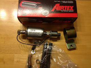

I'm looking to add an electric fuel pump to my 73 240Z and it never originally had one installed.  I have been in contact with a few vendors but no results as of yet so if someone has a lead on one, let me know?

My favorite “in between the Nismo and Airtex” price point and functionality is the Facet FEP60SV or 477060E.
Same form factor as the Original and Nismo, internal easy to change filter too.
The best price is actually from aircraftspruce.com or or .ca
Installed several for friends and myself, never had one fail.

Thanks, I've followed his thread and am planning around it but with a nimso pump.  It seems these brackets are in short supply so I'm going to have one made up in the meantime.
The holes on the Facet pump are 2” apart, and the two bolts that mount it to the frame are 60 mm apart. M6 captured nuts in the frame, M8 bolts to mount the pump to the plate.

S20-engined models (432 and 432-R) had an electric pump from the beginning of production in 1969, hence the mounting bracket captives being present in the crossmember on all contemporary S30 models. No mechanical pump on S20 engine.
