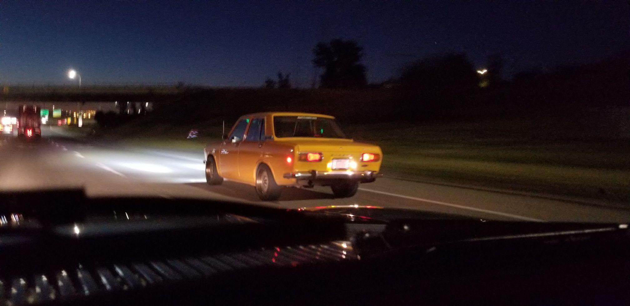

Go LED headlights,  reduces the current requirements to the point where relays are barely required to protect our sensitive old headlight switches.
either Dapper OE7’s or LED H4 bulbs in Hella or Bosch (or similar) housings is the way to go.
Dapper’s OE7 (and OE5) lights are astoundingly good and look OEM.  Bright white light and sharp cut off. 2.1 Amp each on low beam.
https://www.dapperlighting.com/products/oe7
BTW the blurry photo is caused by extreme speed and distraction of the photographer by the beauty of the subject matter...
