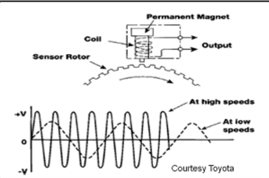

If you're not getting continuity then a/the wire(s)  in the pickup coil probably broke from the vibration of the reluctor wheel beating on it at high RPM.  There's more than just a magnet in there.
I don't know the construction of the Nissan unit but here's a typical diagram from the interwebs.  Not my forte...
