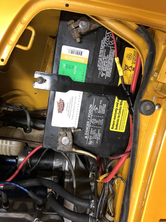

The battery has been bother me a while as it is freely moving around when turning...
poor man’s billet battery tie down.
Should help the visual smog check

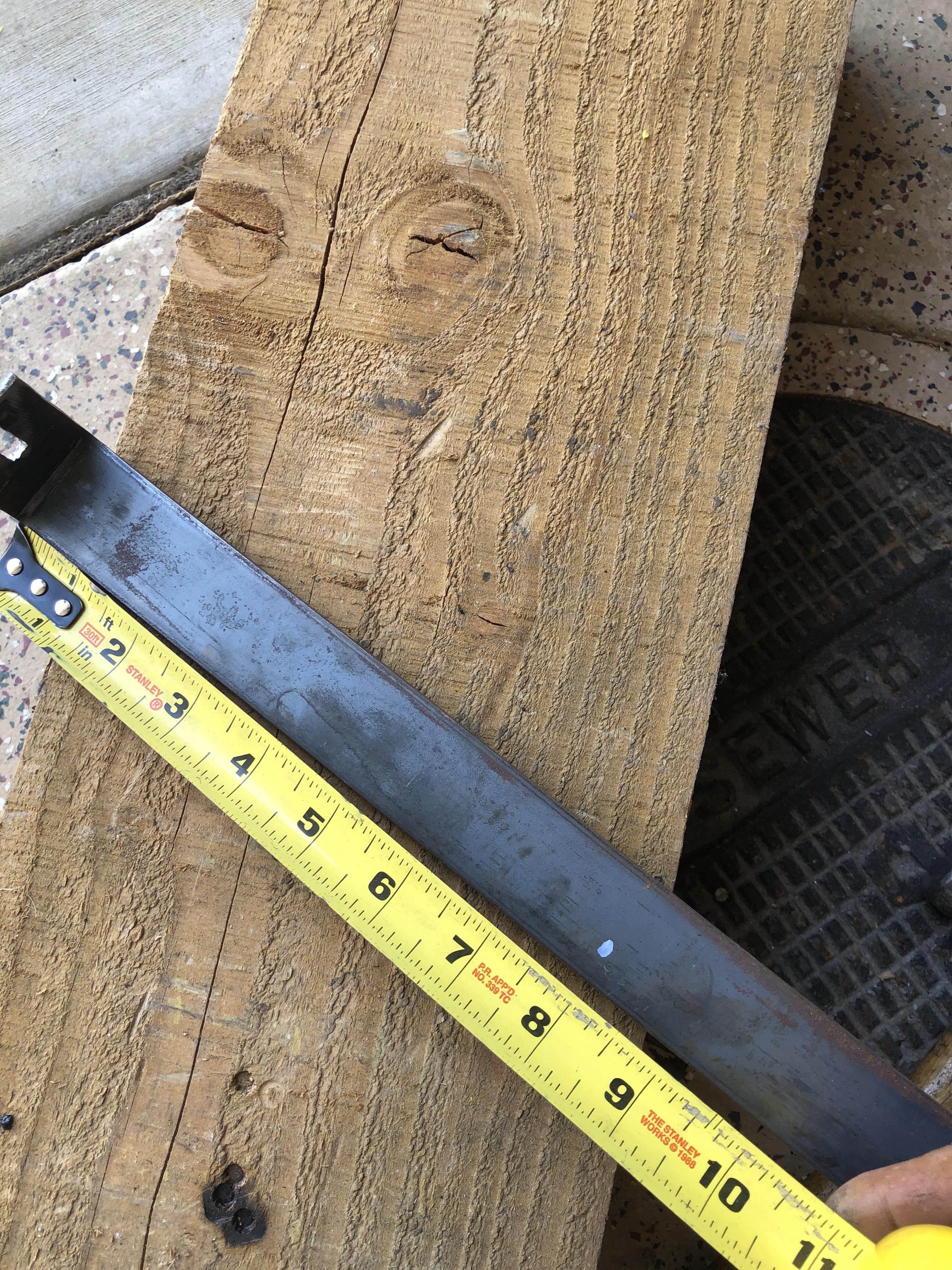

material:
- 1 1/8” width x 1/8” thickness and aprox 10” length.  My battery width is 7”
- grinder with cut through blade
- sanding disc for grind the sharp edges
- old battery rod with end screw and hook
- some left over aerosol paint can
- a gallon of sweat
Be sure to bend the middle a bit upward to create a “spring” to help tie down without too much force at one end
Edited by 240zadmire

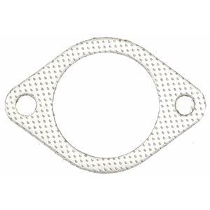

I have a little exhaust leak right at the connector from the end of the catalytic toward the muffler.  Boy, it took me couple of days to find it.  It’s embarrassed, I know.
Then old one were paper like instead of the new ones I installed.  The new ones are fel pro and feel like aluminum/metal.  I notice the flange is not flat anymore.  Perhaps due to heat/cold it deformed.
what is your recommendation? Paper or metal exhaust gasket?
new ones look look like this.
read somewhere people prefer paper gasket but for the manifold to the head.  Some say soak into water half an hour or so to soften so it will mate nicely to the cylinder head.
as for my problem, yes.  Hammer, dolly and a torch did make the flange straighten better.  Of course oxy-acetylene would be nice.

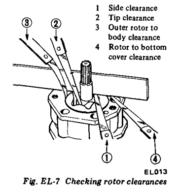

That movie is way too big to download easily.  Lower the resolution or just make it shorter.  It was 520 MB.  Took a few minutes and I have decent internet speed.

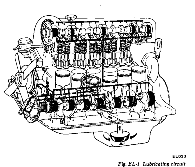

I saw it get up to 40 psi but it should have been higher.  Could be the oil pump but the other reason for low pressure is low resistance to flow from worn parts, like crankshaft bearings.  But an oil pump change is worth a shot, to start.
Turbo pumps are high volume pumps, to make up for the oil diverted to the turbo.  You shouldn't really need it.  You might just drop the one you have and check it.  There are specs in the FSM.  Take pictures if you find ravaged parts.  Entertainment for the audience.
