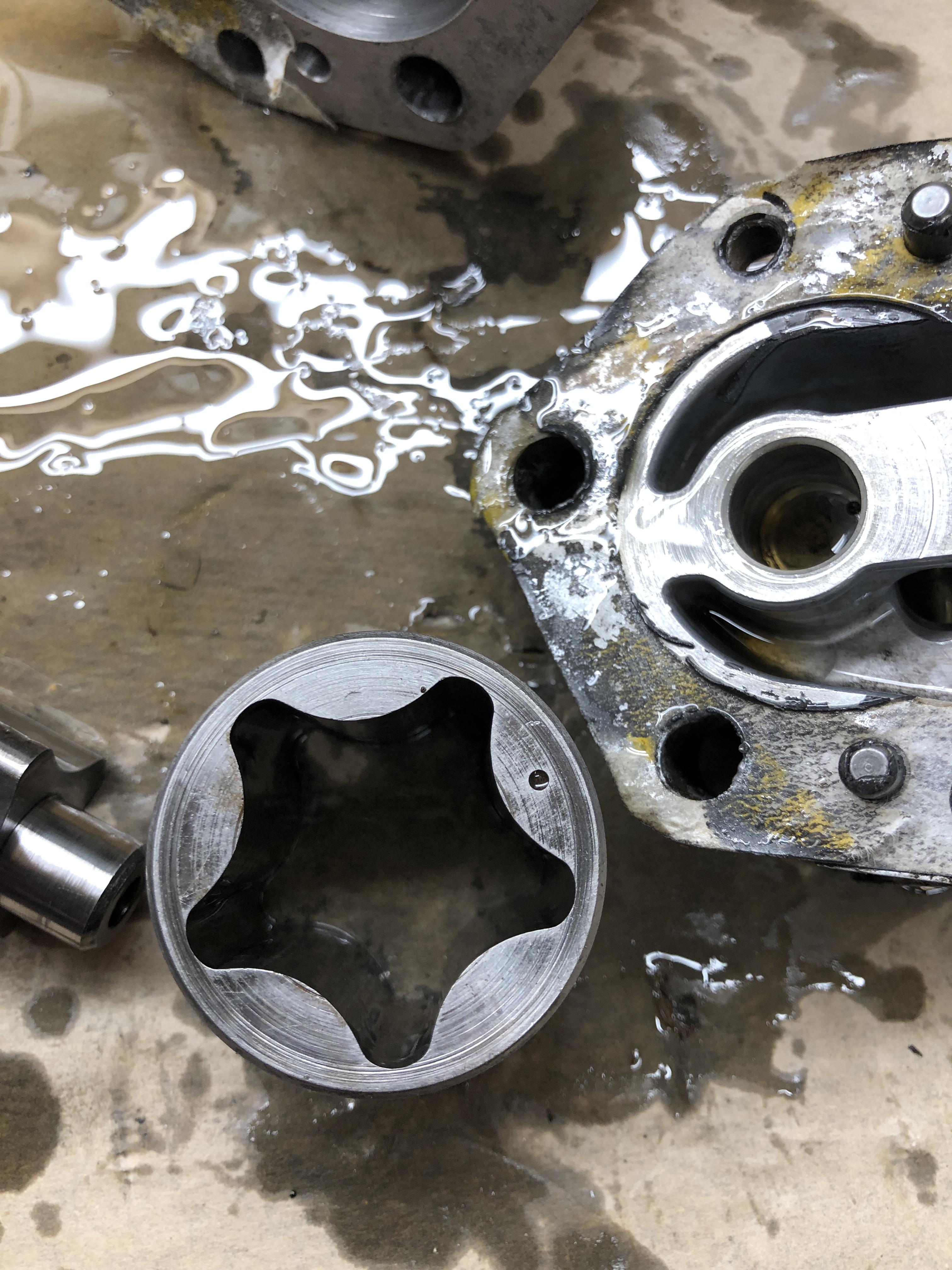

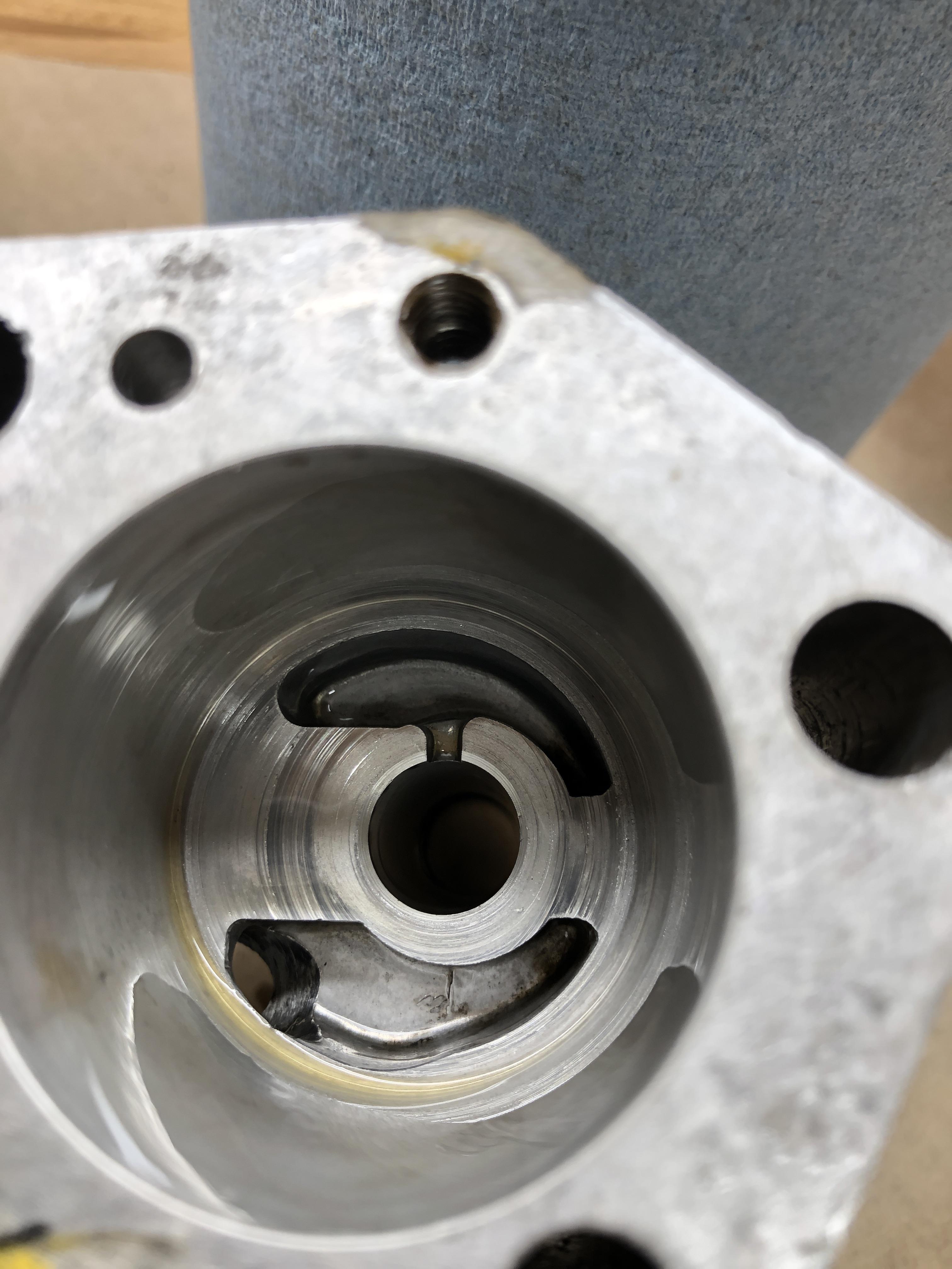

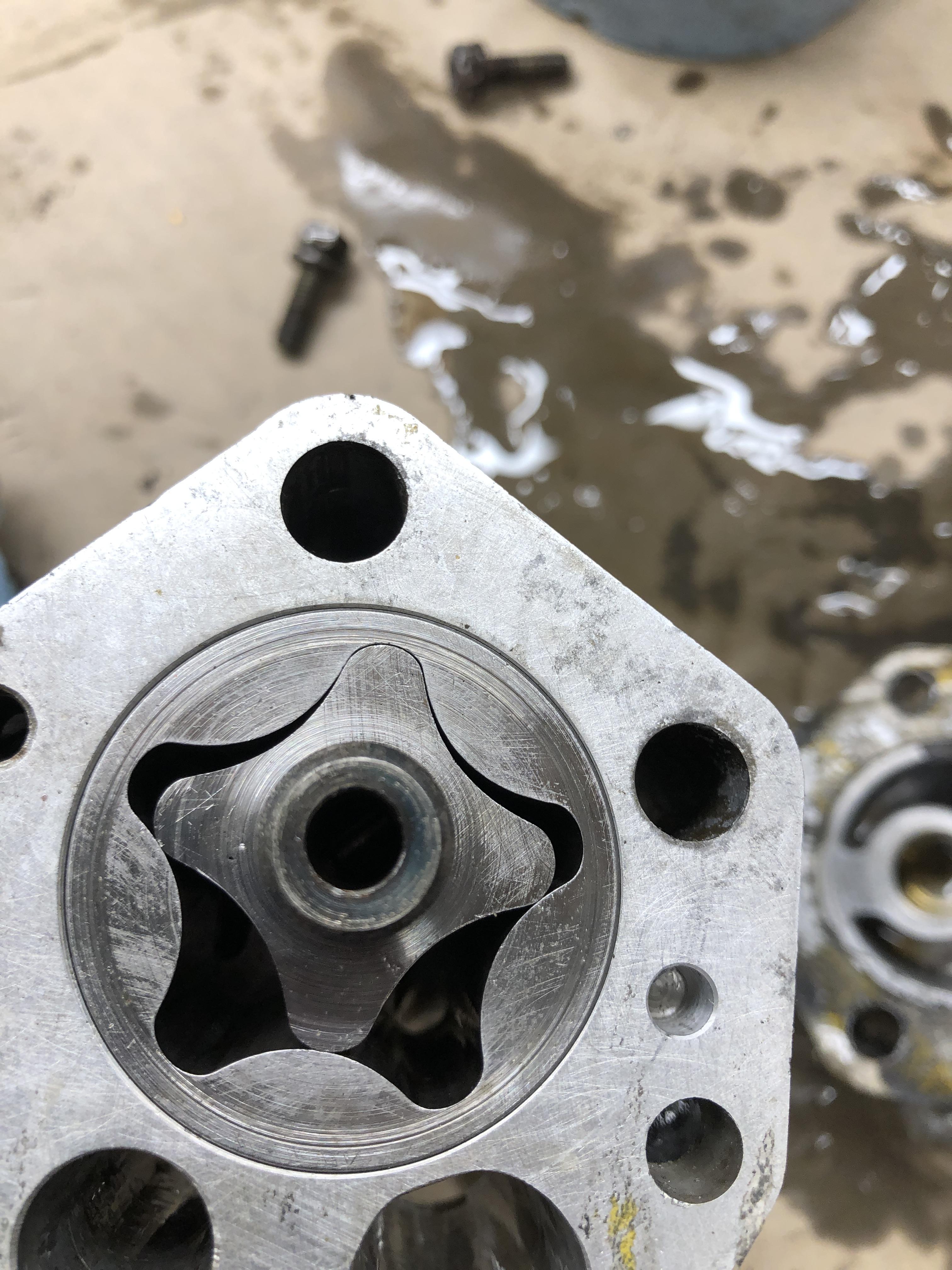

anyway, as @Zed Head predicted, took the old one apart and seem there are scores on the rotor top and the holder.  However the rotor and holder seem to be pretty flat. My thinest gauge is 0.038mm and won’t slide through.  The clearance of the outer rotor and holder is tight.  Don’t have gauge for it...

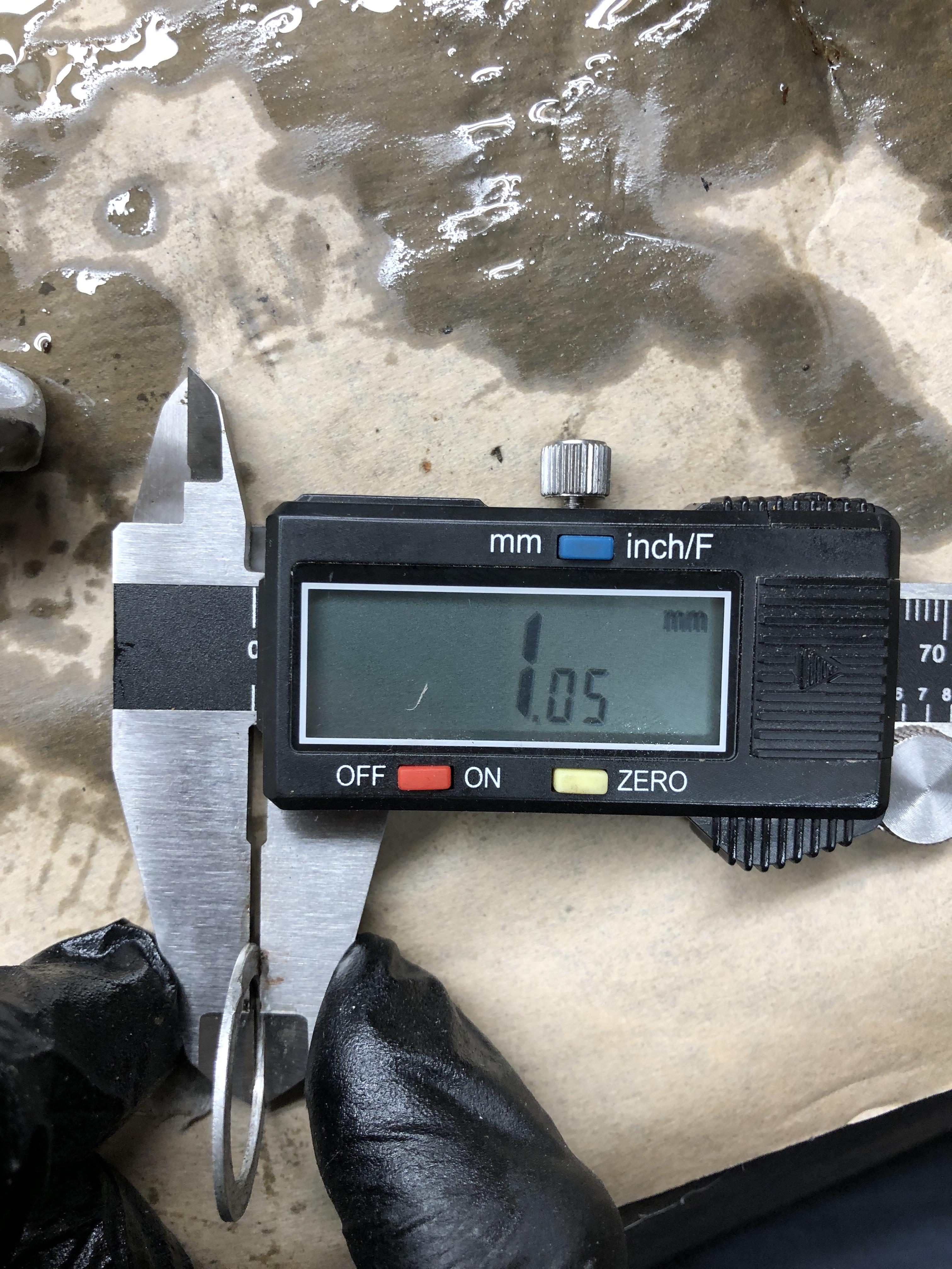

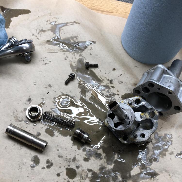

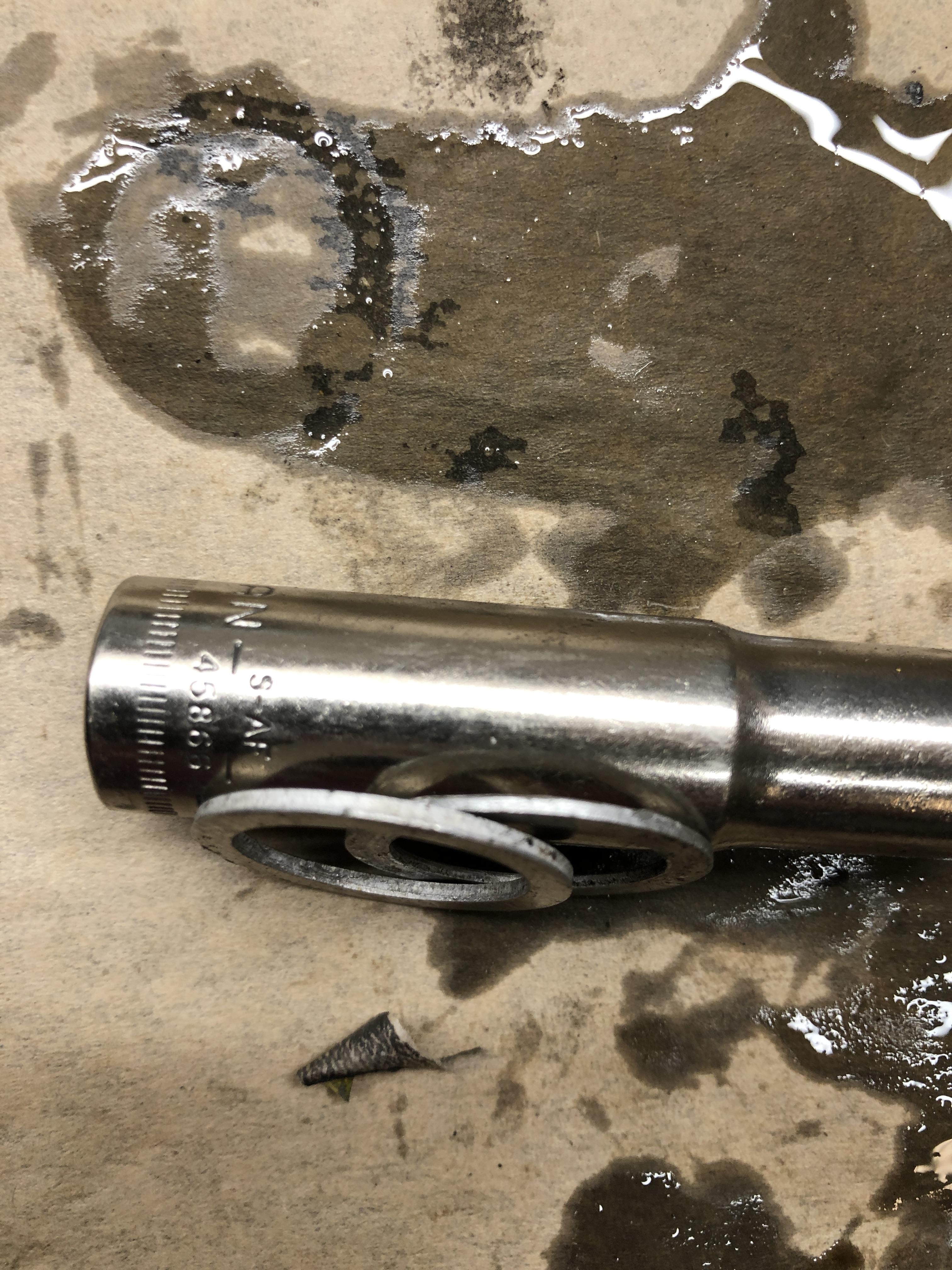

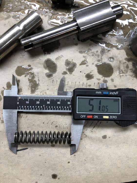

what I meant I screw up is that the spring pressure is already out of specs. On top of that, I replaced the washer that is thicker than the stock which make it even less pressure.  Been reading a lot and folks suggest to put a thinner washer inside the bolt to make it more tight/higher pressure.... since I bought the new pump, might as well use it. After all pump is like our heart pumping blood to other organs.
Stock washer
I screwed up and replace with this thicker one
spring out of specs of 52.5mm

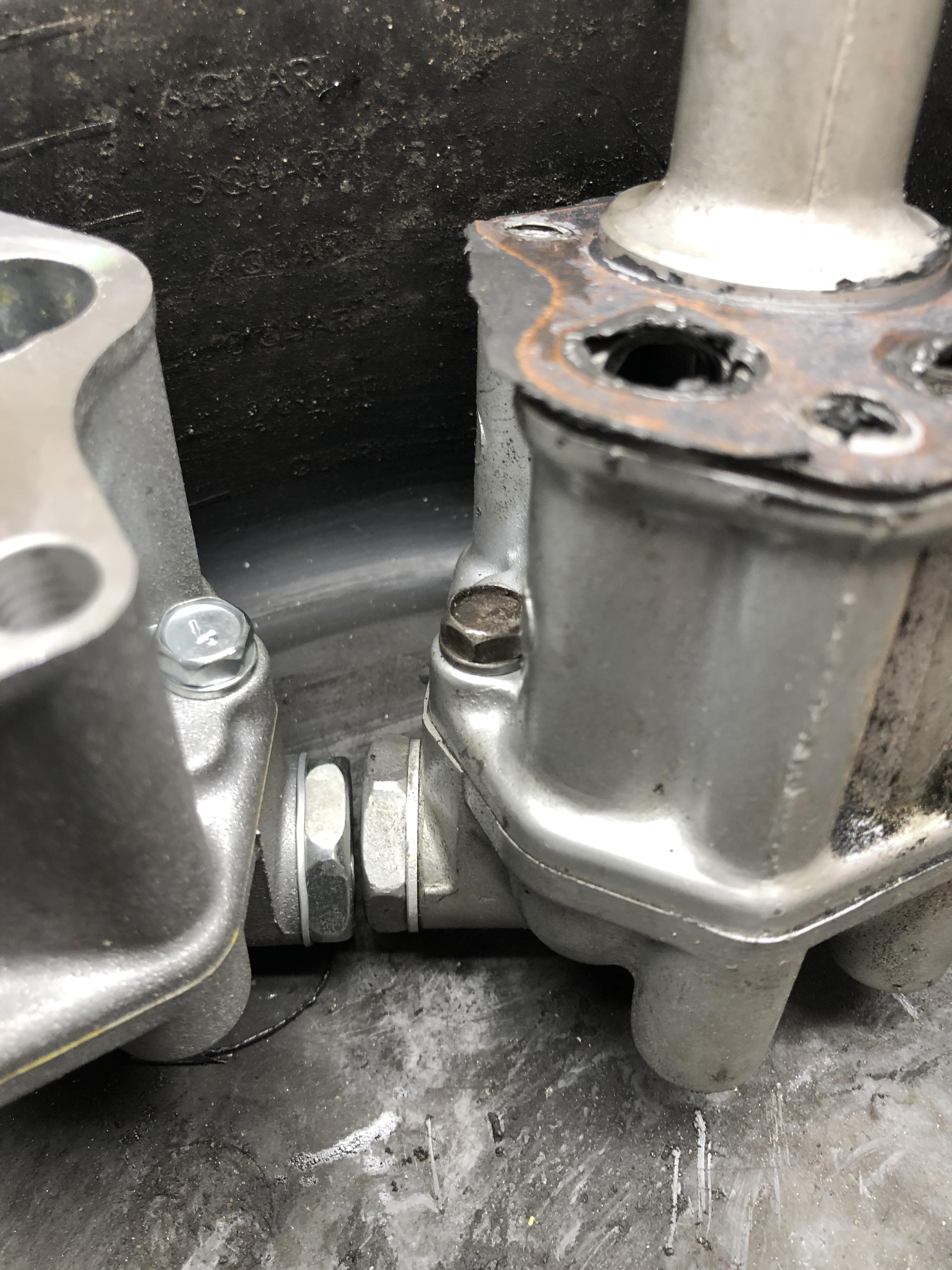

Old pump on the right and new pump on the left.  As soon as I see the washer. I new I screwed up without open the old pump.
experts, please confirm my theory so that anyone read this won’t make mistake as I did.

What you are calling the washer is actually the crush washer or seal, the washer that your reading about would go between the spring and the cup that screws into the pump housing.  Find a small washer the same diameter as the spring and place it in the cup that the spring sits in, put the spring in place and put everything back together.  Now that the spring is being compressed more than it was the oil won't get through the bypass valve as easily.
The mechanical gauge will give you a much more accurate reading on what the pressure is, if the pressure is still low with the new pump then as ZH says, the next thing to check is the main bearings and conrod bearings for wear.
The amount of oil your getting while cranking the starter is good,  the head looks very clean, maybe some work was done on it recently?
Since one end of the spring pushes against the threaded in plug, increasing the thickness of that spring could (under certain circumstances that aren't in play here) reduce the oil pressure. The thicker that washer, the further the inside surface is from the overpressure relief, and the easier it will be to open that bypass.
The only thing that bypass valve does is limit the upper end of the oil pressure. If the oil is thick (cold) and the engine is tight, that bypass will open and limit the pressure to an upper psi. If the oil is thin (hot) or the engine is worn, or the RPM's are low, that bypass valve will be closed and not be doing anything at all.
In other words, if you've got low oil pressure, changing the bypass valve spring won't do anything to help. When the oil pressure is low, that valve is already closed and not having any impact at all on the pressure. So unless that spring is so weak that the bypass is being opened accidently at a very low pressure (unlikely), it's got nothing to do with the oil pressure level.
