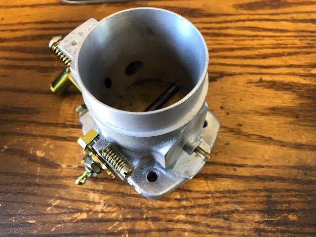

Here is the N42 intake mocked up. I may need a different header as I see the intake and exhaust share studs. Been a long time since I've had a 280Z!
Also, has anyone mocked up a drawing for a heatshield? I can plasma cut it but it would be easier if I didn't have to duplicate someone's already done work?

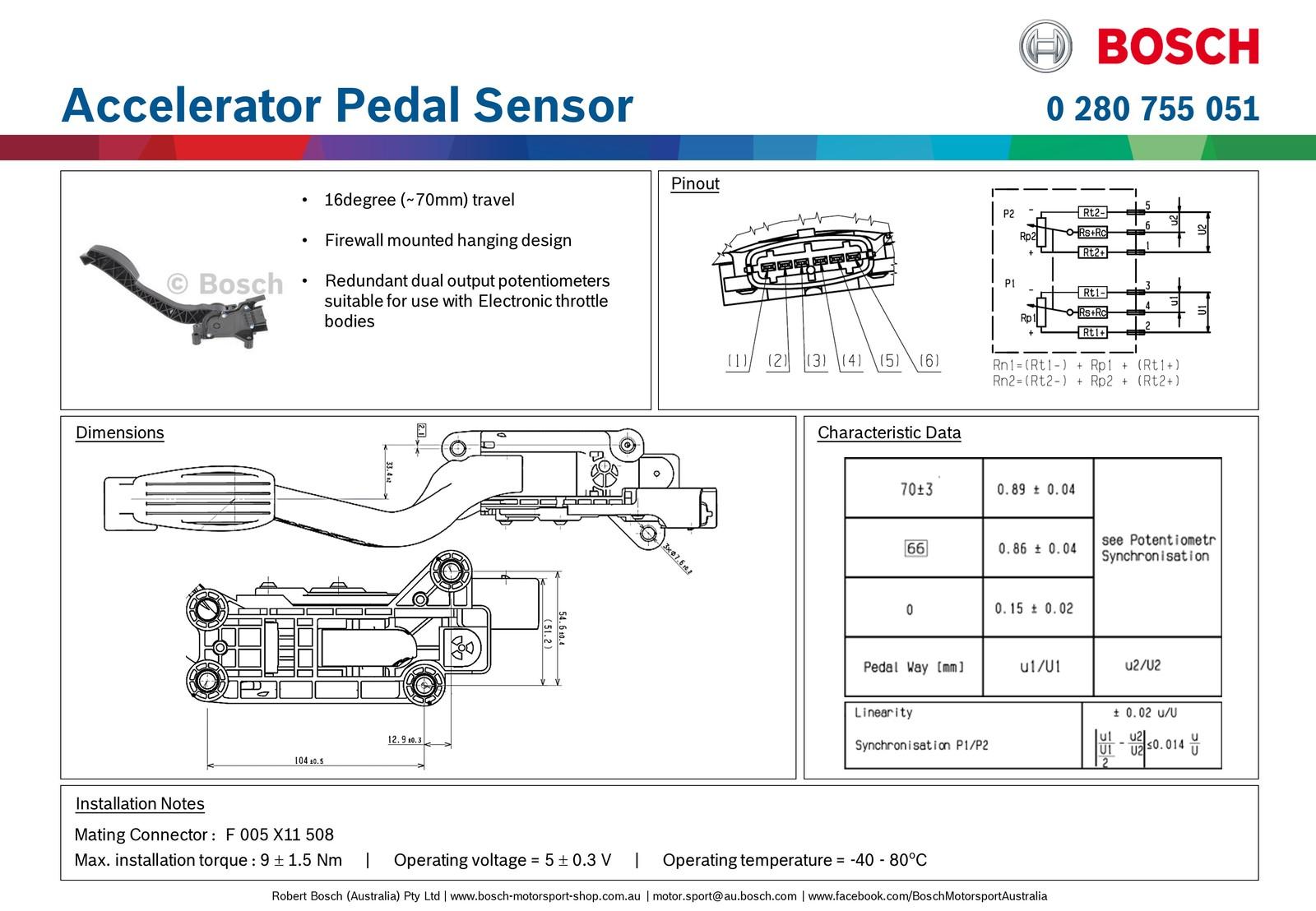

The bmw  S54 engine I just put into my Z has DBW throttle so I'm using the stock gas pedal unit from the E46 M3, it's a very nice unit, fairly compact and I'm pretty sure it could be adapted to a different ECU.  I was afraid it was going to have a remote feel to it but it's really well thought out, feels great and the throttle reaction time is instantaneous.
That looks nice, and I’ve got one sitting in the garage that I can size things up from. I just need my wife to look the other way while I fiddle with her car! I’m more concerned with the throttle body end either adapting to my throttle body or the throttle body adapting to my ‘75 intake...

I decided to run down the mountain from Tahoe and go to Summit Racing and see if I can find a throttle body with DBW and a pedal that goes with it. I suppose I should make sure it's supported by Haltech!
Anyone calculate ideal throttle body size for a 3 liter stroker? I recall it being bore/HP of 1 cylinder?
Never mind. Amazing what you can find if you switch from searching with your phone to using your desktop computer. It calculates to 60mm and change. This TWM "big throat" from the early Datsun performance days is 60mm. If I want to go DBW, I have to switch to a newer throttle body as a retrofit. I'll go 65mm if I can as they say to go 'need + 10%.' This actually makes a lot of sense when you think about it. This throttle body was intended to replace the factory 2.8TB. That would calculate to 'need + 10% for the 2.8 but slightly small for the 3.0L stroker.

This looks promising. Its a Bosch Motorsports unit. 68mm throttle plate. Part # 0280.750.156 Just have to check with Haltech and make sure it's compatible and check the bolt pattern to see if I need to build an adapter. I probably do, I couldn't get so lucky as to have it bolt up!
