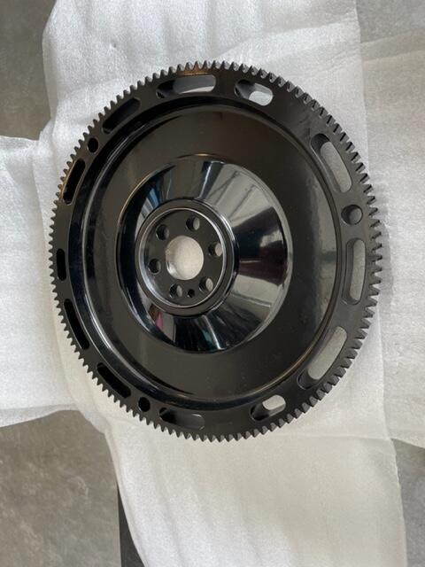

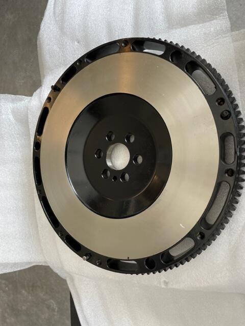

conedodger Posted April 19, 2022 Author Share #302 Posted April 19, 2022 That’s a lot of clamping surface! What clutch and pressure plate should I use? Link to comment https://www.classiczcars.com/topic/64413-just-another-damned-z-car-project-thread/?page=26#findComment-639465 Share on other sites More sharing options...
Yarb Posted April 19, 2022 Share #303 Posted April 19, 2022 ZXTurbo/ 2+2 is the 240mm clutch I believe. 1 Link to comment https://www.classiczcars.com/topic/64413-just-another-damned-z-car-project-thread/?page=26#findComment-639471 Share on other sites More sharing options...

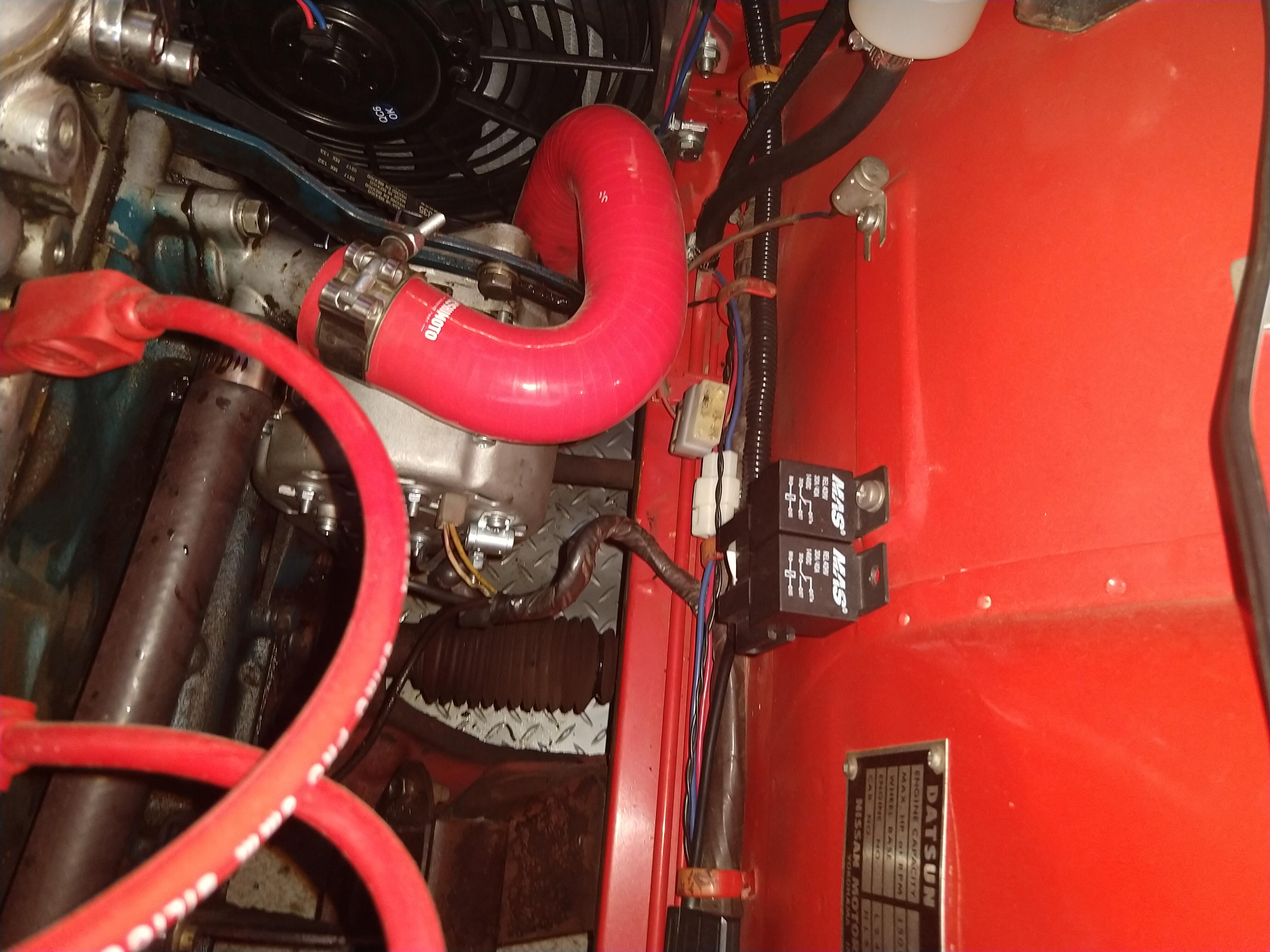

w3wilkes Posted July 24, 2022 Share #310 Posted July 24, 2022 Since I also did the 60 amp internally regulated alternator I "hid" the relays in plain site by mounting them where the old voltage regulator used to live. Link to comment https://www.classiczcars.com/topic/64413-just-another-damned-z-car-project-thread/?page=26#findComment-642835 Share on other sites More sharing options...
conedodger Posted July 25, 2022 Author Share #311 Posted July 25, 2022 Wilkes, cool work! I grabbed your pic and I will do it too! tell me about this 60amp alternator? Why not one of the 100 or 140 GM 12si alternators? Link to comment https://www.classiczcars.com/topic/64413-just-another-damned-z-car-project-thread/?page=26#findComment-642876 Share on other sites More sharing options...
w3wilkes Posted July 27, 2022 Share #312 Posted July 27, 2022 Since I've replaced all my bulbs except the dash lights with LED to take the load off the wiring including the headlights with the harness upgrade mentioned before the 60 amp alternator seems to be more than enough for my needs. I did do the Retrosound stereo and will be reactivating my dealer installed A/C eventually I think I'm more than good. The 60 amp upgrade I used was this from MSA that eliminates the mechanical voltage regulator where I mounted the headlight relays (there's a note at the end for 73 cars to contact MSA for some options) Motorsport! 60-Amp Alternator Upgrade Kit, 70-72 240Z - The Z Store! Nissan-Datsun 240Z 260Z 280Z 280ZX 300ZX ( Z31 Z32 ) 350Z 370Z Parts Link to comment https://www.classiczcars.com/topic/64413-just-another-damned-z-car-project-thread/?page=26#findComment-642962 Share on other sites More sharing options...
