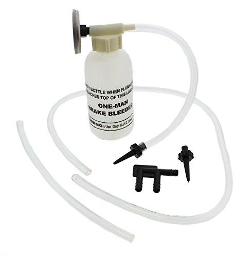

These cheapo one man bleeders work remarkably well for me. My $.03
That’s good to hear.

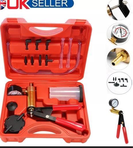

I had a pump action one that created a vacuum and while it got 90% there, it really was never as good as a second person’s right foot on the middle pedal. It also broke after a couple of years.
