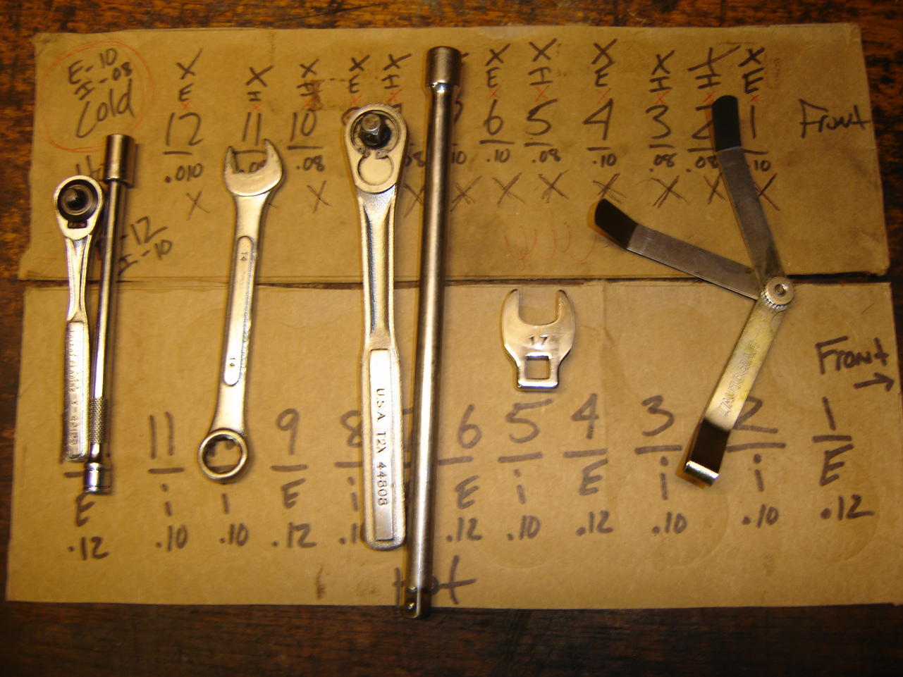

On second thought maybe set the valves to spec first. You won't be running the moror during that process so the carbs are irrelevant. Take the plugs out and write out a "go by" board. Some come up together or damn close and you can do them out of sequence just X them off as you go.

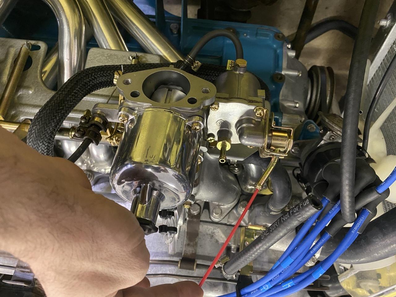

So I’ve been tinkering with the tuning trying to get it to idle well, but haven’t made a lot of good progress. It seems like it’s been running rich - there’s some darkish smoke coming out of the exhaust, and it really doesn’t want to start with the choke on. I readjusted the lash cold this morning hoping that would help, but the adjustments were minimal and it hasn’t seemed to make much of a difference. I also sprayed some starting fluid around the manifold and carbs and didn’t get any change while running, so I don’t think there’s a vacuum leak.
I’ve been pressing on those maintenance buttons below my carbs to adjust the mixture, and the RPMs go up every time I do, so I’ve been screwing my mixture knobs in and in and in.  At this point they’re screwed all the way in and the car seems happier for it. It’s starts up immediately and idles around 1000-2000 with both my idle screws all the way out.  That doesn’t seem right. My carbs were rebuilt by Paltech but I’m wondering if something is wrong there - maybe the needles aren’t seated, or something is wrong with the jet tube. Any thoughts on where I should start looking?

The disable button makes the rpm raise? That is odd, it makes mine run half on everything.
My easy thing first suggestion would be to poke on the floats through the fuel inlet with the red straw that comes with WD-40. They maybe  stuck in the bowls from shipping dry?
@siteunseen yup from what I’ve watched/read this means I’m too rich.
Your theory is that the floats aren’t ever shutting off the fuel supply, and so the pump is just force feeding fuel through the jets?
When you say “...through the fuel inlet” how do you mean? The fuel inlet is bent and there should be that grosse (sp?) jet there. Do you mean go in from the bottom?
I poked my straw through the bowl vent, and on the rear carb I can feel it bounce a bit but it feels rock solid on the front. I think you may be on to something. I’ll open up the float bowls tomorrow and see what I can see.
I'm sorry! The vents will work just as well and much easier. The "ins" have the jets on the other side. STUPID, STUPID, STUPID!
Thank you, I get confused on Saturdays in the fall. I'm lying. I'll be confused Monday a.m
So all of that sounds like a significant rich condition. What needles are you running? Stock N-27 or something else?
Also, your comment about the needle seating is important... It is possible to install the needles too deep in the suction pistons and if that happened, it can result in a rich mixture.
