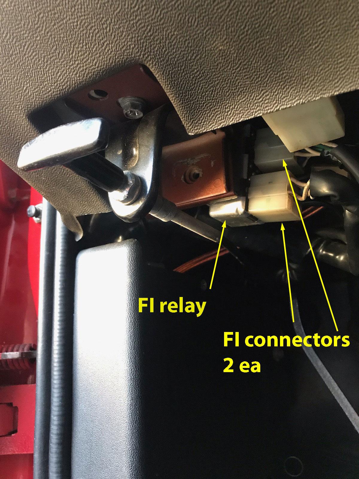

Zed Head Posted October 2, 2020 Share #78 Posted October 2, 2020 (edited) Posted at the same moment as zclocks. Re the relay - It should be under the dash by the hood latch release. A 1x1x2 inch silver unit. Hard to get to, two screws hold it in place. If you prop the AFM vane open first you should hear it click when you turn the key on. It's a typical solenoid, powered through the contact switch in the AFM. Edited October 2, 2020 by Zed Head Link to comment https://www.classiczcars.com/topic/64482-1975-280z-22-will-not-start/?page=7#findComment-607004 Share on other sites More sharing options...

zclocks Posted October 2, 2020 Share #80 Posted October 2, 2020 This is the location of the FI relay Link to comment https://www.classiczcars.com/topic/64482-1975-280z-22-will-not-start/?page=7#findComment-607006 Share on other sites More sharing options...
iscnetwork Posted October 2, 2020 Author Share #81 Posted October 2, 2020 I figured from the diagrams it would not be easy to get to, until the picture wasn't exactly even for sure where to find. Thanks everyone for the input. I will attempt my next battle tomorrow. Good night, have some great dreams. Link to comment https://www.classiczcars.com/topic/64482-1975-280z-22-will-not-start/?page=7#findComment-607010 Share on other sites More sharing options...
